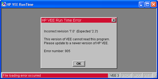

I just bought a used HP 8903B and am trying to control it via Windows 7 using Peter Millett's software.
I got a UGPlus USB-to-GPIB adapter made by LQ Electronics

I loaded the included Windows drivers and their UBPlus software can detect and seems to be connecting with the 8903B. When I send the initialize command, the display on the 8903B clears and the REMOTE LED indicator lights up, so it appears that contact with the 8903B is being made via the USB GPIB adapter.
The instructions on Peter's webpage for loading the HP/Agilent/Keysight software appear to be 6 years old, now. I found that the version 5.01 VEE IO Libraries he recommended will not install or run in Windows 7, so I clearly need to use a newer version.
What software version combinations are known to work in Windows 7?
I see that the Keysight Control Bundle from Dec.2016 contains version 17.3 of the IO Libraries Suite.
see Keysight Instrument Control Bundle Download | Keysight (formerly Agilent?s Electronic Measurement)
When I started loading the HP/Agilent/Keysight software last night I was trying to follow Peter's how-to as close as possible, but with newer versions of the software.
I ended up loading:
1. the Keysight VEE Runtime 9.31
VEE Runtime 9.31 Patch | Keysight (formerly Agilent?s Electronic Measurement)
2. IO Lib Suite 16.1
IO Libraries Suite 16.1.14827.0 with .NET 3.5 SP1 | Keysight (formerly Agilent?s Electronic Measurement)
3. Keysight Instrument Control Bundle 12.2016 (contains IO Manager (formerly called Instrument Manager)
I am not able to make contact with the 8903B through the HP/Agilent/Keysight software. It doesn't appear to be detecting the 8903B on the GPIB bus.
I'm guessing that "Board Number" is the address of the GPIB adapter?
I'm guessing that VISA address is the GPIB address of the instrument?
I'm not sure what GPIB address the UBPlus is set to. I don't see anything in the UBPlus software that shows the address. I've sent an email to the company to see if they can give me some insight.
I also wonder if I loaded duplicate or conflicting versions of the software?
In looking more closely today, I see that the Keysight Instrument Control Bundle 12.2016 appears to contain IO Lib suite 17.3 and likely the other programs needed.
Perhaps I should go back and uninstall numbers 1 and 2 from my list?
Feedback appreciated.

got an answer
Well, I can stop trying to get the HP/Agilent/Keysight software to work with the UGPlus USB GPIP adapter. The manufacturer said it isn't compatible.
If they would just put up this type of compatibility info on their website...
Thank you for your interests in our products. I'd like to provide some information about UGPlus,
1. VEE Runtime software does not work with UGPlus. Softwares for USB to GPIB Controller are not exchangable.
2. UGPlus takes fixed address, which is 21. It is based IEEE488.1 standard.

It won't work before you'll see the GPIB adapter and the 28 instrument in the Keysight IO Manager.
The Keysight IO Lib suite knows only about their own adapters, and has a bridge to VISA (allowing NI adapters to work). So it is unlikely you'l ever get it working with a 3rd party GPIB adapter. Get a Keysight USB HS GPIB adapter, they come for pretty cheap today (for what you need even a Chinese knock off clone will work). Or a Prologix, as indicated.

Jeez! KaboooOOooom! It's alive!
Thank you Pete - amazing guy he is - but there's both a Runtime (free) version of VEE, and the Pro ($2k) version. Running Pete's vxe code costs nothing and relies only on the free VEE program: VEE Runtime | Keysight (formerly Agilent’s Electronic Measurement).
Also, required were the following steps I found on the GBIP-USB Adapter google group (Google Groups):
1. Install Agilent IO Library [version].
2. After installing Agilent IO library, run Agilent Connection Expert, select tools-> Option -> Agilent 488 Option and check 'Enable Agilent GPIB cards for 488 programs'
3. Install Agilent VEE runtime [version].
4. Open IO Configuration under VEE runtime folder, select find instrument. If the 8903B is connected to your PC now, the default address should be 28, and the software will ask you whether send "*IDN?" to the instrument at address 28, select No because 8903B not recognize this command
5. right click on the new instrument(@GPIB0::28::INSTR) , select instrument properties, and change the name to Audio Analyzer (case sensitive here!!!).
6. Pressed the save I/O configuration button in the Instrument Manager (very important!!!)
7. Select Advance and change the timeout to 20 sec
Usually, this will make your 8903B works with Pete Millet's software. If you got error message as following:
"Configuration Error: Driver for "Audio Analyzer" not found error number 801
Use the instrument manager to add it"
Pls check step 5/6 and make sure you use the right name/GPIB address and saved the configuration
This is it.
In case anyone wonders, current [version] is 9.33.
