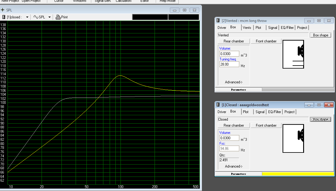

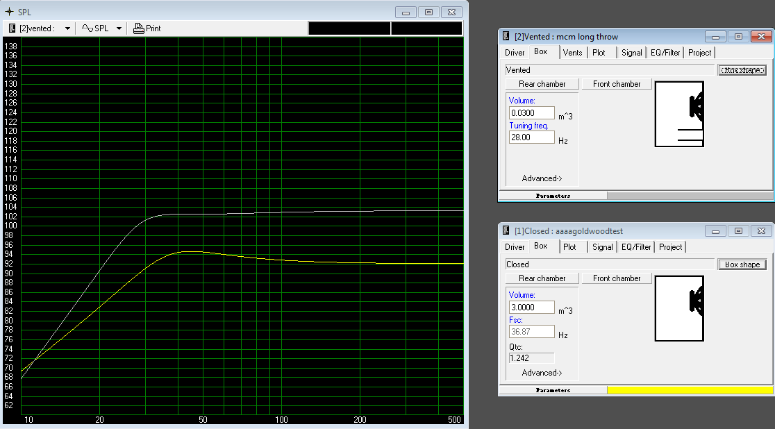

Here's some graphs. The Goldwood driver is in 3 cubic metres volume, sealed. The MCM woofer is in 30L ported tuned to 28Hz, with a small amount of series resistance to raise Qts to ~0.3.
The -3dB point is similar, but the Goldwood (even in the massive enclosure) has a peaky output due to the >0.7 Qts.
With adequate power, the MCM woofer will do >6dB more SPL than the Goldwood, with a flatter frequency response, in a cabinet 1/100th the size.
Given cabinets the same size, the Goldwood will stand more power to hit Xmax, but, as you can see, its no use as a subwoofer.
I could fire up Hornresp and simulate something more exotic, but I suspect the outcome will be similar.
