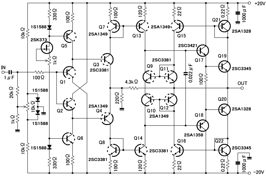

T tadiam1 Member Joined 2009 2010-05-27 11:37 pm #1 2010-05-27 11:37 pm #1 Attachments TLBamp1.gif 38.4 KB · Views: 174 M mickeymoose Member Joined 2008 2010-05-28 12:55 am #2 2010-05-28 12:55 am #2 What are you asking, please. E Joachim Gerhard Member Joined 2009 suesskindaudio.de 2010-05-28 12:59 am #3 2010-05-28 12:59 am #3 The input is a diamond buffer and the signal is routed by current mirrors. Should be quite fast when it works, T tadiam1 Member Joined 2009 2010-05-28 12:26 pm #4 2010-05-28 12:26 pm #4 re The schema work?..good quality sound? Status Not open for further replies. Share: Facebook X (Twitter) LinkedIn Reddit Pinterest Tumblr WhatsApp Email Link
