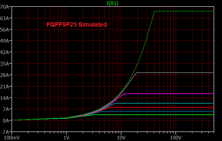

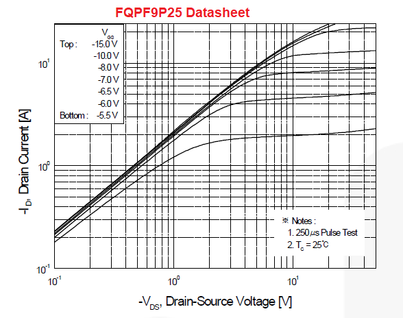

Is this reasonable? I tried to write parameters from datasheet, but some are estimated.
.model FQPF9P25 vdmos (pchan VTO=-4 RS=0.0852 KP=4.8 RD=0.456 RG=10 mfg=Fairchild Vds=-250 CGDMAX=1n CGDMIN=27p Cjo=550p IS=6n Rb=0.267 TT=1.762e-06 Cgs=910p Ksubthres=0.1 Ron=.62 Qg=29n)
That BSIM model is not compatible with LTspice.
The model parameters can't be taken directly from the datasheet in most cases. You can estimate but that doesn't produce a very accurate model. It takes specific knowledge to set each parameter.
Look up tutorials on how to create a VDMOS model for the basics.
I've used this tutorial ( http://www.simonbramble.co.uk/lt_spice/ltspice_lt_spice_tutorial_6.htm ) to get values above:
From the datasheet I've got:
VTO = VGS on datasheet
KP = transconductance
mfg = manufacturer
Vds = VDSS
CGDMIN = Crss min
CGDMAX = Crss max
CGS = CISS
Ron = RDSon
Qg = total gate charge
Other values to be verified by more experienced people.

Your model:
Let's break down what we are doing, recasting your model:
.model FQPF9P25 vdmos pchan
1) +VTO=-4 RS=0.0852 KP=4.8 These are the DC Level 1 Spice parameters
2) +CGDMAX=1n CGDMIN=27p These are the non-linear gate-drain capacitances
3) +Cjo=550p Cgs=910p These are the gate-source capacitances
4) +RD=0.456 RS = ????? RDS = ?????RG=10 IS=6n Rb=0.267 TT=1.762e-06 N= ???????
5) +MTriode = ??? Ksubthres=0.1 Ron=.62 Qg=29n) Triode Region and Subthreshold conduction
Focus first to get the DC model correct by varying the parameters in lines 1 and 4
Take a look at similar PMOS in the LTSpice Library to get a head start.
