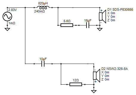

so i had a look at some other air core coils and just cant seem to find the correct resistance to match for my 8Ω drivers. and on speakerbug they are still expensive.
http://www.linkwitzlab.com/Pluto/Pluto-2.1.htm
what would you suggest? im going off other peoples recommendations for the 800Hz. I have noticed that they have also been crossed over at 1kHz so i dont mind going a bit higher if it will help me source components. they have been crossed at 1 kHz in the pluto speakers listed in the below linkIn this case with a 2" fullrange for high frequency you can raise crossover

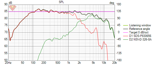

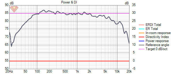

I just played with a crossover @ around 2 kHz seems to work fine 1st order with 2" inverted
total highend is just all the 2" has
ohhh wow...thanks for all the effort...so what you are saying is i dont even need to have a inductor in my x-over for the NSW2 driver? just a cap and a resistor?
i wasnt going to have any crossover components for the peerless driver, i was just going to drive that directly from my mini amp. So should i ultimately go with your above design and incorporate components for BOTH my drivers or just build the high pass section for the NSW2 drivers. Would your above design be a better listening experience if i were to build the whole thing?
