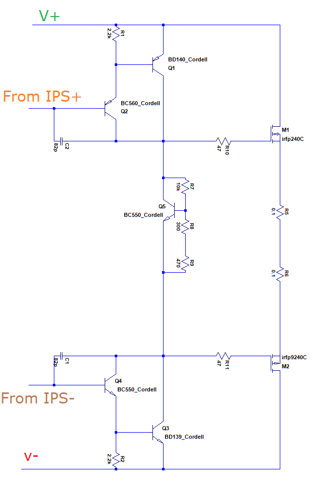

You should be more specific. What do you mean with "instead of the static ..."? On first sight, there seems to be no general difference to the situation in the circuits proposed, for instance, in Cordell's book.Hello to everyone, I am building a personal amplifier. I have this output stage and vas:
How to implement the error correction method by Hawksford or Cordell instead of the static bias with this configuration?

More specific? This is the error correction amp done by Bob Cordell:
Findable in his PDF on his website: http://www.cordellaudio.com/papers/MOSFET_Power_Amp.pdf
There the error correction by Hawksford:
I want to implement them in my amplifier specific configuration.

That Cordell circuit resembles very much a circuit with negative feedback.
Where should we draw the line between error correction and negative feedback?
