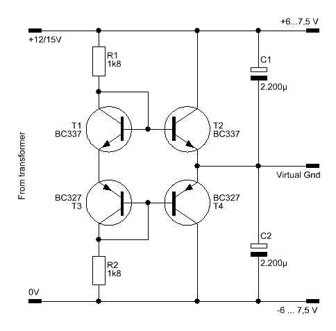

I've tried to work this out with Jim Hagerman, but maybe I'm not asking the right question. I want to use a 12V DC power supply with the Bugle, rather than 9V batteries (opamps are rated for up to 18V and a 15V supply is recommended in the manual). I tried wiring the positive and negative holes on the board to the positive and negative terminals on my DC power supply, but I get no sound or simply a hum or buzz. Yet it works fine with batteries.

You need at least a symmetrical power suplly.

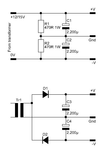

You can do it in two ways:
With your 12V transformer, make a 'virtual ground' using 2 resistors and 2 capacitors with, at least, 2.200uF each;
Or making a half bridge supply from the transformer directily.
See picture...
But remember... This is a RAW supply... don't expect a good or even a reasonable performance...
I recommend using 9V Bat with Bugle 😀
Or a excellent dedicated low noise power supply

It's a PowerOne regulated 12V 12.5A unit, which I thought was a step up in quality from the Pyramid 13.8V 3A unit I had used previously. Are there any simple regulators like a TREAD that output 12V?
And how were the resistor values calculated? Because I don't believe I have any 470ohm on hand, but I do have higher and lower values. Does the closeness of their match determine how good the ground is?

You need a 'supply splitter' to generate a virtual ground. The one suggested above is a start, just a start though... The resistor values are not critical.
So why exactly do I get hum/buzz/no music when I use the DC supply and everything works fine with batteries? And would I be wrong to presume there are power supplies that I can use without having to build a supply splitter?

Ok... from the begining...
That pre-amp. Bugle, needs a positive voltage, ground and a negative voltage to work.
This voltage can be from +5, 0, -5 to +15, 0, -15...
Now, if you have a 12V transformer, you only get +12, 0... where are the -12V? You don't have it, so no music.
You will need 2 TREAD PSU's to put the Bugle working
One for +12,0 and the other to 0, -12
Exactly because the Bugle isn't supplied with power in the right way.
Even if you use a 'simmetrical' PSU, you will hear some hum/buzz if this PSU isn't designed to supply a phono pre-amp.

JWFokker said:So why exactly do I get hum/buzz/no music when I use the DC supply and everything works fine with batteries?
You presume well, IF that power supplies ARE Simmetrical, i.e. with +15, 0, -15V or other voltagesJWFokker said:And would I be wrong to presume there are power supplies that I can use without having to build a supply splitter?
