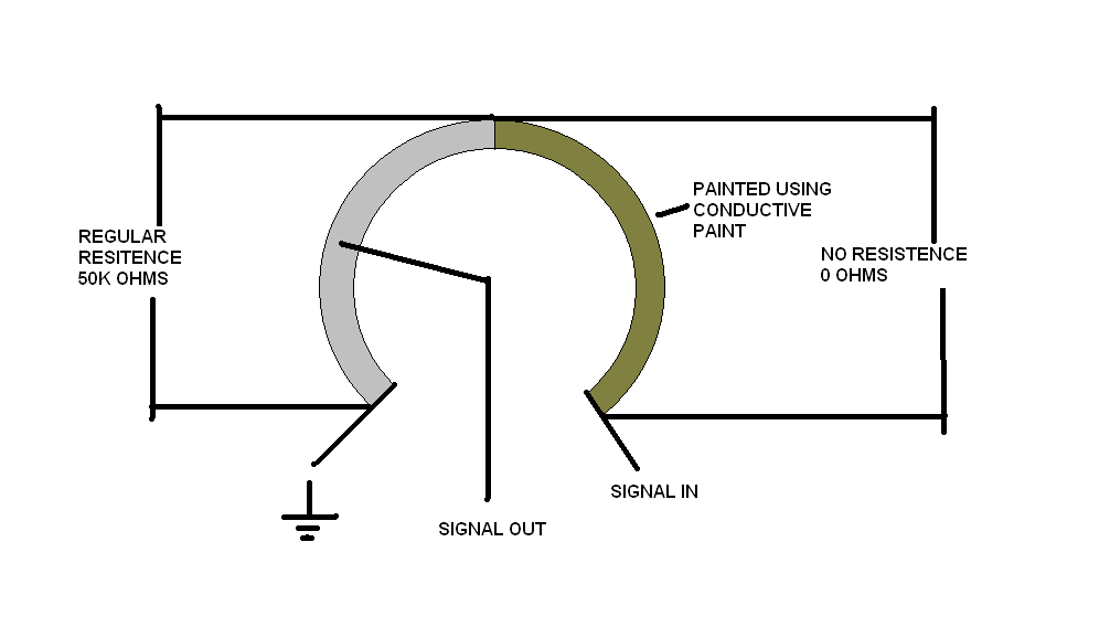

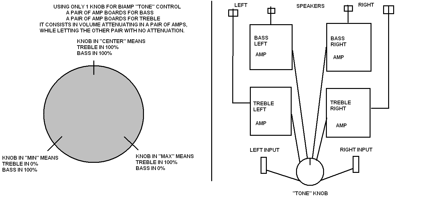

Hello folks,
I have 4 amp boards and I am using them in a BiAmp architecture - 2 amps for the bass (left and right) and 2 amps for the treble (left and right).
I'm trying to find a way to use just a single knob as "tone control" - it will control the "volume" of these amps, in a way that when the knob is in "center", both pairs of amps have "no volume attenuation" (they are in 100% volume), but turning the knob counter-clockwise (until the "min" position), only treble pairs will be attenuated, and the bass amps remain in 100% volume. And turning the knob clockwise (until the "max" position), only the bass pairs will be attenuated, and the treble pairs remain in 100% volume.
I attached an image of the "schematic" I'm trying to archive.

A regular balance control should work, if connected at the right point.
Can you post a schematic of your electronic crossover?
a 4 gang pot, one gang to each amp, centre position would feed equal to each amp.
Turning right would boost treble and cut bass, left would cut treble & boost bass.
putting a fixed resistor in series with the ground connection of each pot would move the range from 0%-100% to say 50%-100% which might be more useful.
Due to the bi-amp setup, this will not be a "normal" tone control effect. ie all treble frequencies would be boosted equally (except around crossover frequency).
If you just want to adjust levels once then forget, just use 4 separate trimmer pots.

Hi Christian, what is it you want to do exactly, balance the amplifier outputs or have a tone control? I wonder if a "tilt" tone control may be what you're after.......
What I am looking for is a way of control the volume of 4 channels, using a single knob, where turning to left will turn 2 channels down (letting the other 2 in 100%), and vice-versa.
I called it "tone control" just because these channels are going to amps that have cross-overs on it, so lowering 2 of them means lowering tweeters and lowering the others means lowering woofers.
It is just a "fine" adjustment, not a "real" tone control.
Gotcha, sorry I posted my question the same time you answered rayma. You could use a dual gang pot to balance both sets of amps, ie two single pot balance circuits.
A 4 gang balance control would be what you need, I don't know if they make such a thing... it's not something that's usually done. You would probably have to somehow connect two dual gang balance controls together.
An alternative could be one like VR1 in Figure 7 here:
Potentiometers (Beginners' Guide to Pots)
In this type you put some resistors (R1, R2) in series with the signal paths and use the pot to bring one side or the other closer to ground. In the center position you lose a bit of signal, but you'd only need a dual gang linear taper pot which should be easy to find. Note that when turned all the way to one side it will be shorting that side to ground so make sure that's not going to harm your circuit.

Why is it so hard to use a normal stereo balance linear pot? (2 gang)
Simply set the input at senter tap and output bass tw at each of the other. Repeat for the other channel.
This gives a adjustable series resistanse to the amp, and only a few dB up down in level, that would hopefully bee within the requiered range. If not use paralell resistor at amplifier input or at balanse output to reduce volume.
Instead of using a pot use a 24 position switch and resistors to get the curves you want. The middle position would be full signal to both high and low.
Yes, thx! I'll do that... I think it will be the better solution.
