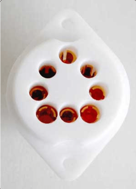

I found this interesting page which has a special socke for B4 and UX4 tubes (footprints 45 degrees to each other), and the difference can be seen. Apparently UX4 is normally 5V filament, and B4 4V.
Socket-Yamamoto.htm
