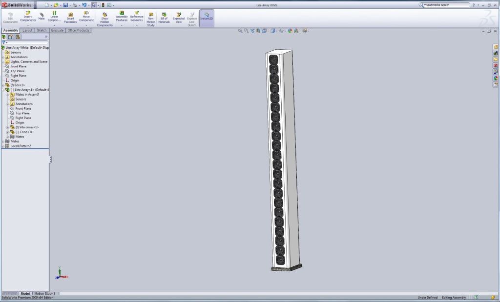

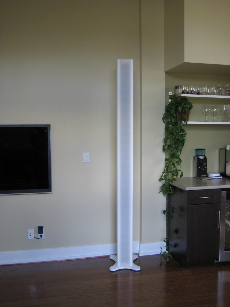

Hi Pnotus,
There has been some great advice given already in terms of measurement, so I won't repeat too much.
I used Speaker Workshop when I was evaluating drivers for my array, and it works well for measuring a single driver in an enclosure. For the actual arrays, I use RTA as R-Carpenter suggests. You'll find the arrays very difficult to measure with an impulse.
Overall, you've got exactly the right idea for choosing a driver. Listen to each one carefully, make good notes, then measure each one and compare. That approach will help you understand what you were hearing without letting the measurements bias your listening impressions. I personally think a driver should both measure well, and sound good independently.
You can read a little more about the arrays I built here:
http://www.diyaudio.com/forums/multi-way/193015-stupid-cheap-line-array-4.html#post2648779
I tested quite a few drivers and ended up with the TC9FD-18-08. It sounded the most balanced and neutral, and it had very good bottom end and some of the smoothest treble I've ever heard from a fullrange.
Sorry to hear about NS3 purchase... I wasn't a big fan 🙁
You have a few drivers on your list that I haven't heard, the most promising of which appears to be Faital Pro 3FE25. It looks like a superb little driver with all the right qualities for an array. The C-C spacing is excellent, the response looks very even and extended, the FS is pretty low, the Xmax is reasonable and the efficiency is very very high for a driver that size. I might actually order up a few and give them a listen for fun 🙂
Best of luck!
Owen

Those are great looking arrays Owen.
I'm actually going to build an omni line array using the tc9 in a couple of weeks.
Hi Melo,
Thanks! I really like them. the TC9 is a hell of a little driver. Even without factoring in cost it's easily one of the best, but when you consider it can be had for $6.50 in large quantities, it's in a league of it's own.
That reminds me... my overall favourite of all the drivers I tested in terms of sound and measurement was the Fountek FR88EX:
Speaker Building Supplies from Madisound
Unfortunately, at $50 each they were a little too rich for my blood. If price hadn't been a factor though, I would have built with those.
Owen

By the way - I also model my speaker in SolidWorks or Inventor, even Catia V5 if feel that I have time on my hands.
