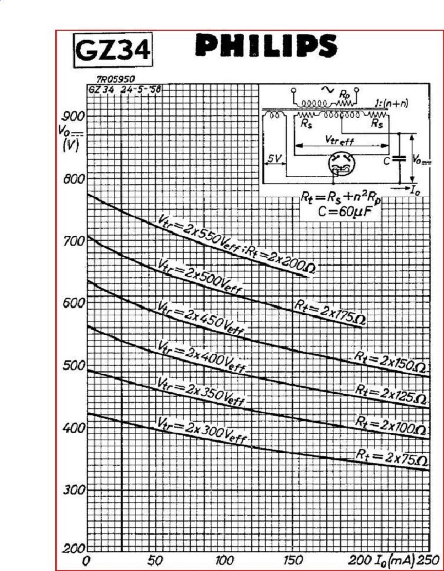

The final voltage should be around 300 volts; The measured output voltage is around 467 volts.
BTW, there should also be a second, similar capacitor AFTER the inductor.
The output voltage is correct for the transformer that you are using.
If you only want 300V at rated current, you'll have to use an inductor input filter
(which gives the average value of the waveform), instead of a capacitor input filter
(which gives the peak value of the waveform). Or, you could use a different transformer.

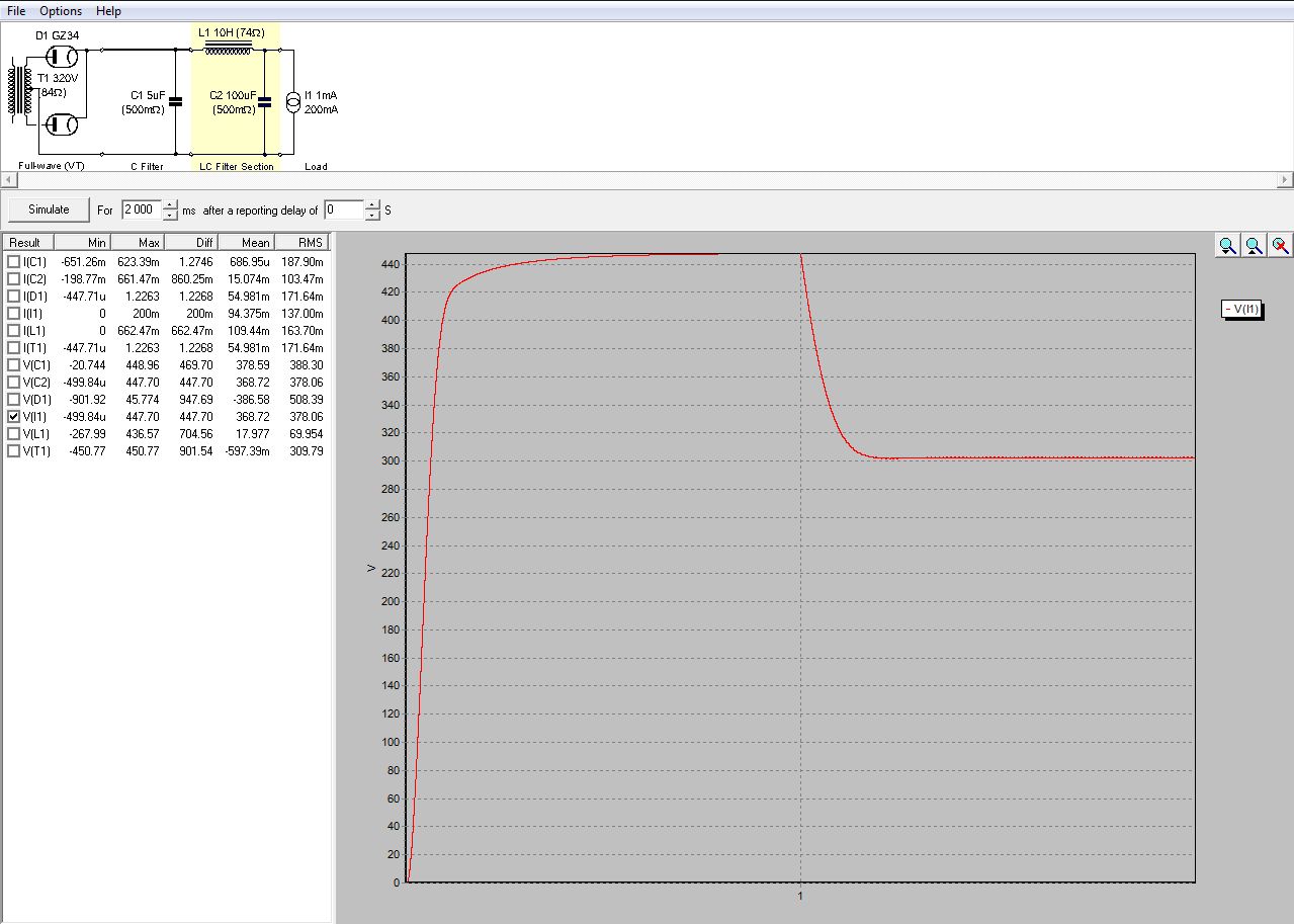

Why not use PSUD2?
You need to measure power transformer (secunder) DCR, choke DCR.
Quasi choke input (small C, L, C) is tunable with first capacitor.
This simulation use 320V (under max. load, without load this about 335V) 84R DCR transformer (my big 320V/200mA one), Hammond 193J choke (10H, 200mA, 74R DCR).
Without load output voltage about 448V, with 200mA loading only 300V.
A graph to see what to expect.

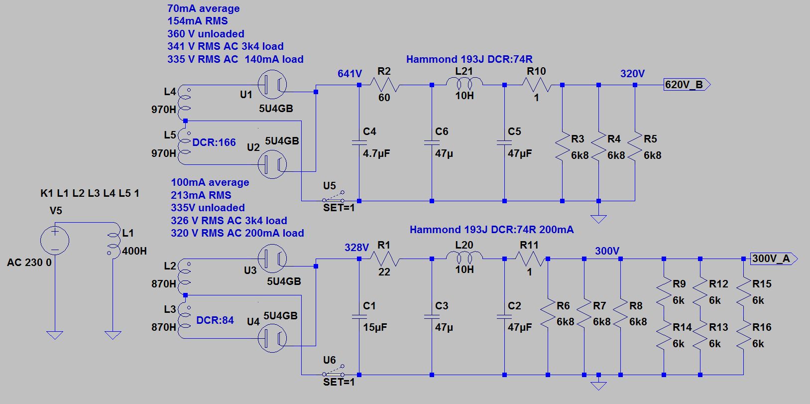

I tested my HT PSUs with exact loads.
I have a lot of 50W wirewound aluminium housed resistors (Arcol, Dale etc.) and large heatsinks. Using parallel and series resistors proper load can be making.

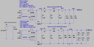

How did you setup/calculate the coupled inductors to get the desired voltage of transformer?
Ive been struggling with this in LTSpice.
Can you attach the asc file so I can study and experiment your results?
