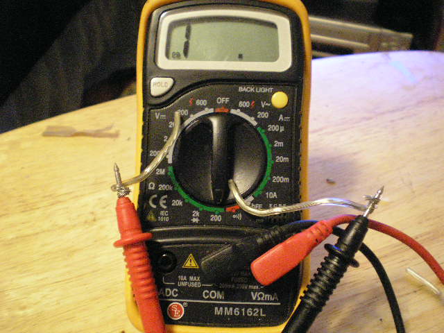

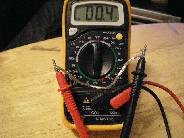

This is a picture of a cheap multimeter measuring the resistance of a good peice of wire. A good piece of wire is less one ohm.
This is a picture of the multimeter with a cut(equal to a burned or faulty wire) piece of wire. Notice in this picture there are no numbers showing,(pay no attention to the number 1 on the far left),this means the resistance is very high(The ohm / resistance are near infinite)and no electron flow.
