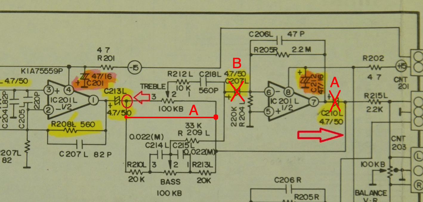

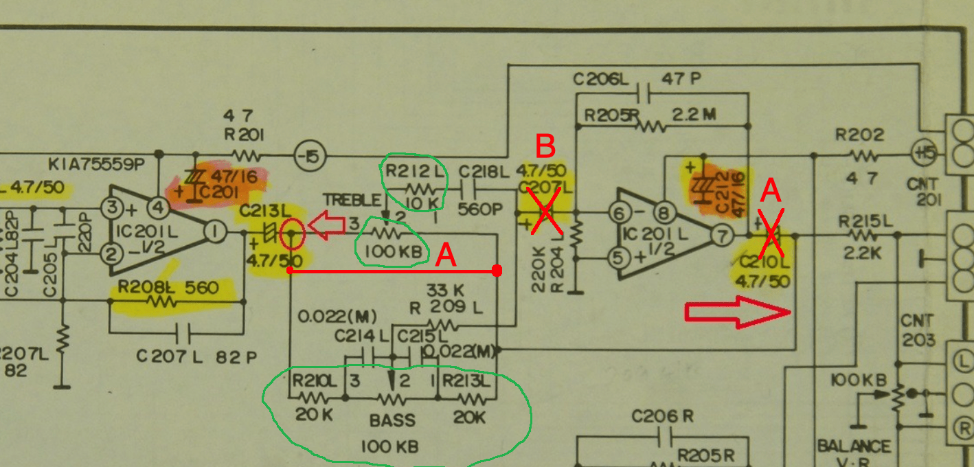

I have an early 1990's Sherwood receiver model RX-4010R. I currently have the tone board (preamp) removed and am wondering if it is possible to eliminate the circuitry related to bass and treble controls. This is a lower-end receiver, but it does have RCA pre-out and pwr-in jacks. So I could use it as a preamp to drive other amplifiers.
Ideally, I would like to have the simplest circuit possible, eliminating as many unnecessary components a possible.

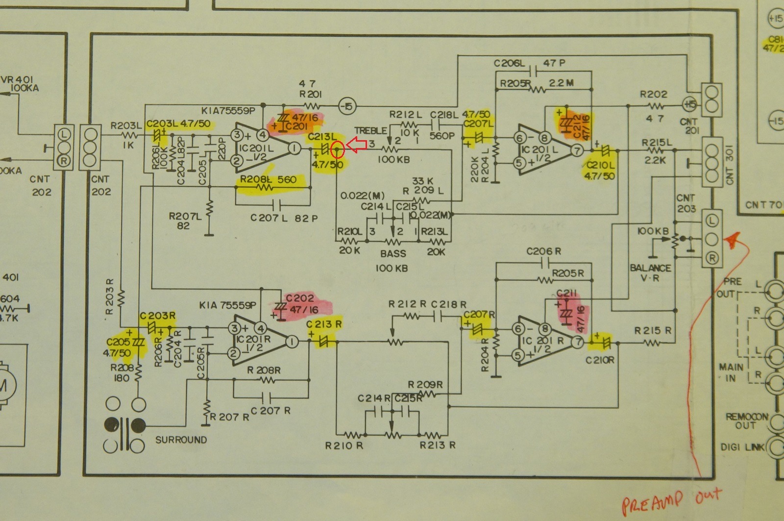

In the schematic jpg posted below, please disregard the pink and yellow, highlighted electrolytic capacitors and the red "preamp out" marking. Those were done a while back and have nothing to do with the questions I am asking in this post.
But the areas circled green, red, and yellow, do relate to the topic. As can be seen, this design uses two dual opamps. I am not sure which half of the opamp actually drives output, or what determines gain as the resistor values and connections are very different for each half of the opamp. Beyond my understanding, and that is why I came here to ask 🤓
1) is the circuitry circled in green the basis of a simple, opamp based preamp? What more would be required to make this workable?
2) can I eliminate all of the components circled in red?
3) regarding the components circled in yellow, basically whatever is connected to pins 5, 6, and 7 of the opamp, if the tone circuitry is eliminated, does anything need to be connected to those pins? Would there be any harm in using only 1/2 of the opamp?
Thank you wg_ski
After pulling C210, should that vacancy be jumpered? I am guessing no.
As per your suggestion, C213 would be driving output, yes?
So then R208 (560 ohm) and R207 (82 ohm) would set gain? Is that correct?
Would gain be changed versus the original configuration? (I don't understand whether pins 5,6,7 have any role currently in gain setting)
Also, per your suggestion, I believe that the unused 1/2 of the opamp (pins 5, 6, and 7) would have a ground reference, but no signal. Is that correct?

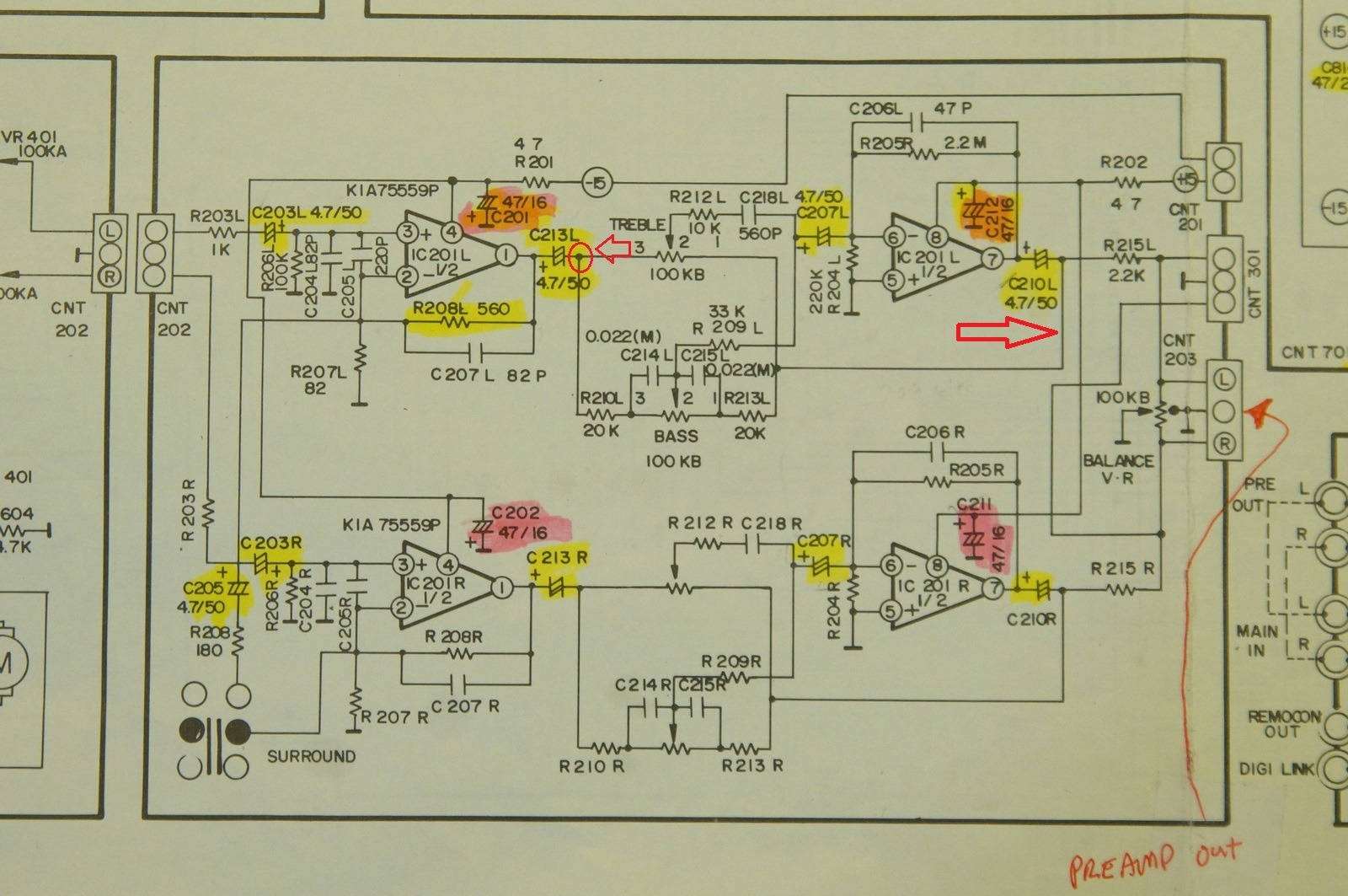

@wg_ski Two final points of clarification if you would please:
Should the additional connection point marked in the pic below, between the negative side of the original C210 and the tone circuitry, also be opened?
Should the unused 1/2 of the opamp should have a connection to ground (via pins 5 and 6) but have no connection to signal on any pin?

It has been pointed out by @wg_ski that the pin 5,6,7 half of the opamp is at unity gain when tone pots are centered. Based on that, I assume that all gain in this preamp is produced by the pin 1,2,3 portion of the opamp.
Guys, another question as I notice that in original configuration, the signal output from C213 is routed through several large value resistors. Eliminating the tone block from the circuit will also remove R212, R210, and R213, in addition to the pots themselves. Do those resistors attenuate signal level?
Wouldn't removing those resistors from the signal path have the effect of increasing output gain? Not sure if "gain" is the proper term, but if this modification is done as described, would the volume knob of the receiver need to be turned CCW to match volume vs the original configuration?
Hi Tom. Yes, I understand that will be the case if the suggested mods are implemented.
But in original configuration, signal went through several large value resistors. It was not straight wire from pin 1 of IC201 to the output. I am asking if removing those resistors from the signal path would cause signal output to be greater than it had been in the original configuration. I am wondering about any possible changes that might result from changing the circuit.
@tomchr
In my post above I am asking about the resistors marked in green below. I believe that those are in the signal path in the original circuit configuration, but would be replaced with straight wire by implementing suggesting modifications. Is that the case? If so, wouldn't removing those resistors from the signal path alter the output signal level?
In other words, would overall gain structure be affected by implementing the modifications?
