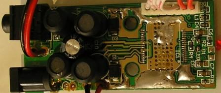

I've been soldering professionally for 15 years and even I wouldn't attempt to resolder a tripath chip by hand with anything remotely resembling a standard soldering iron. You need hot air and flux or an incredibly fine and short tip in a professional compact soldering iron and the hands of a neurosurgeon.
You could take it to someone who fixes mobile phones. Resoldering a surface mount chip is not a good first soldering project. The difficulty level is like hopping on a 1000cc motorbike when you've never been in a bicycle before. It's going to end in tears.
I doubt the chip fell off without any damage to the board.
Sorry. Start with a new T-amp.

How in the hell could the tripath chip come loose?
Anyway, I built my own Tripath amp, and I soldered the chip on with a fine tipped soldering iron. I used solder paste, dabbed lightly on the pins. If you are trying this with regular solder, you are just crazy imo. I was a major pita, but I got it soldered on in about an hour. I bridged 2 pins, but managed to fix it with some solder braid. Go easy on the solder paste. Inspect everything with a microscope, it's amazing what the naked eye will miss. There were a few solder balls in between the pins that i never would have seen without the scope. It's a tough job, but doable if you have some soldering skills, the right equipment, and a ton of patience.
O
Am I some kind of "Surface Mount Savant"? I think not. Not a neurosurgeon either. I think you have just been spoiled by the tools available to you as a professional.
[/B]
Wow! You did that with wire solder? Is that a 2024C? It looks upside down, my heatsink is soldered to the board. That is a top notch looking job. I thought I was pretty good with a soldering iron, but I never could have done that with wire solder and that tip.
The shock from being dropped combined with the brittle pb free solder is what probably caused the chip to come loose.

thank you very much all for your help. it has encouraged me to try to finish this project and start a new one if it fails, so i have started watching the proposed tutorial videos.

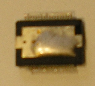

i have made photos of chip and board. i am really puzzled about what happened to the amp, wich worked before i lent it.
looking to the board from above a spike of solder can be seen, wich prevent even to place the chip over the contacts on the board.
is it posible that the chip overheated, melting the solder on pins and the blob on the back, so it passed trough the holes in the board and formed the spike as the chip fell? (the board is upside down when in the original t-amp case).
what is the use of the blobs of solder both in the back of the chip and the back of the board? it seems i have to clean the board before starting to solder the chip.
