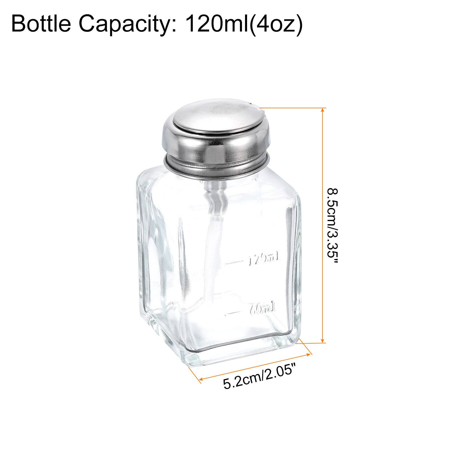

What about this thread? https://www.diyaudio.com/community/threads/least-destructive-dust-cap-removal-replacement.404731/
' The most common loudspeaker glue is black and made by C P Moyen. It is easily remove by applying lacquer thinner or MEK. Apply it with a small brush directly to the dust cap edge at the glue line. Use lots of ventilation. There are some white glues used and they dissolve in water with a small amount of chlorine bleach. Some folks do use a two part adhesive that cures and cannot be partially dissolved and easily removed. Fortunately this is the least common adhesive and is typically used on the spider and rim where the stress is the highest.'
If you could find a suitable solvent that softened the glue, without dissolving the dye or wrecking the cone that may do it. I think I've seen somebody doing something similar here, applying the solvent with a fine tip brush, but don't have a link I'm afraid. It's hard to know which solvent to go for though. Will require some trial and error. If it were me, I'd start gentle with some kind of hydrocarbon first and work up from there. Depends on your cone material etc though.
Just seen the other replies. If the glue is epoxy then solvent will obviously not work. If it's a different glue then may be OK.

If hot air is no option, use acetone or one of the other mentioned solvents. Some of them that work great are really not good for your health.

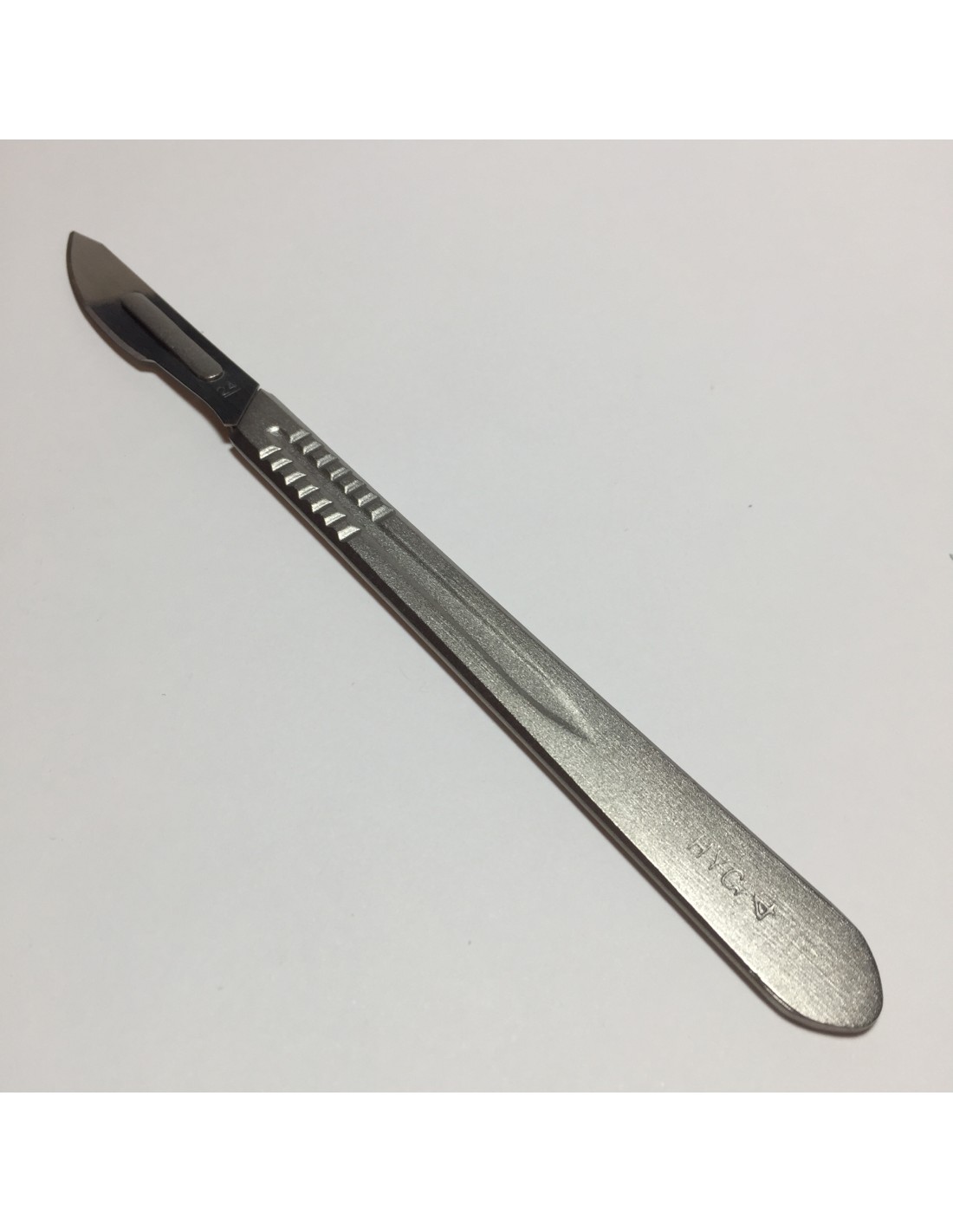

With a really sharp skalpell you can cut through the glue below the dustcap not damaging the dustcap nor the driver.
I would be careful of solvents trying to soften dissolve the glue .... you might soften the cone also, especially if it is paper which most are.
