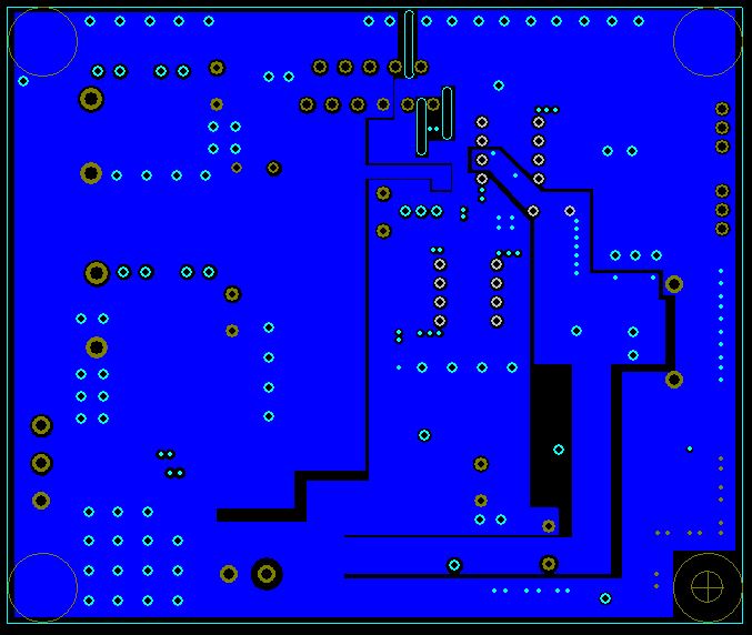

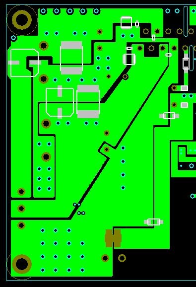

I think i oversized the GND on my 4 layer PCB...
I use the Starground concept.... See the 2th innerlayer.... and Bottom with High Power paths....

Mnay thanks for you Tips ...I tried with two 24V LKW Batteries from my uncle.... then I come under r.a. -102dB noise and the Amp performs now with 0,00083 THD......... so my GND conccept is not good and "swing" on the GND planes under load.... this is what I see.....@Micha2007 - here are a couple of thoughts.
I tested my (much more humble / close to datasheet) LM3886 amp yesterday just to see what was going on. I have a very low spec picoscope so I can't do accurate SNR etc (the AWG on the scope is way too noisy). However, replicating as best I could your first plot (1kHz in and an FFT trace of output) I definitely do not get any noticeable mains harmonics (50,100,150 etc). If they are there they are buried in my noise floor. My best estimate of the SNR I get is that it is in the -90 to -95 range, possibly better. That suggests your much more sophisticated implementation ought to do better than it is and that those low mains-related harmonics are a consequence of layout / design. My power supply is very standard and uses 10,000muF capacitors on each line. The LM3886 has a fantastic PSRR so I seriously doubt there is anything breaking through from your power supply.
Have you tried using a 'near perfect' power supply and seeing what comes out. 2 x 20V high capacity l-ion batteries of the sort you get with serious power tools. That might be revealing.
... ok I take up you hint, but please say in open Words what is " still ...." ?And the layout is not very well made. Not big mistakes but still....
And what could I make better form your side of seeing ?
