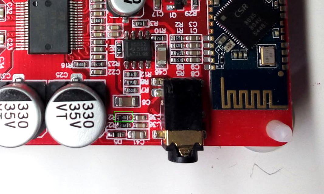

Anyway, I want to make a bluetooth speaker so I purchased this TDA7492P bluetooth amp from ebay.
It's not bad for 10 bucks. The only thing that concerns me is popping when turning on, actually it's not popping as much as it is pushing the cones outwords for at least half a second and it doesn't look safe, so i'm thinking if there is a way to connect something on output before speakers to limit this sudden flow of power. The last thing I would like to put is volume because I would have to turn it down every time I'm turning on the speakers...

Does it pop without pre amp connected ?
It might need a resistor across input to discharge any volts on coupling capacitors.
They're only connected to this amp, nothing else is there. Wireless input --->amp ---> speakers. Thats all.
Maybe build a mute switch in the speaker leads? A couple of big 8-16ohm resistors and a nice big stereo switch?
Well, the BT module should take care on this by utilizing one of its PIOs to drive the Mute of the amp.

A "crude" softstart or longer startup mute time can be accomplished by changing R4 to a high value of i.e. 810k for the case, they implemented it like that. If not (would guess) it needs to implemented from scratch. 3v3 should be avail at the BT module. (Mute Pin is 3v6 max)

Nah, if it's just on power up, an RC filter at the Mute pin will do. like 810k + 1-2uF. Exact values can easily be simulated.
Sorry, i am new to this, but I am willing to learn. You mean I should solder RC filter to the mute pin of the amp? I mean, what side would I need to connect to the pin?
First you need to indent If the pin from the datasheet. Then check what external circuitry is connected to that pin. If there's nothing, solder 2u2 from this pin to ground and 820k in front of this pin with the other end to a valid 3v3-3v6 source.
Here's the pics with and without bckg light:
Seems like a design/implementation problem. Change this 100k for 750k-1MEG and see if it's properly muted then.
Hi Doctormord,Seems like a design/implementation problem. Change this 100k for 750k-1MEG and see if it's properly muted then.
thanks a lot for your advice to change the resistor. I even had an older version of the bluetooth TDA7492P module with two 39 kOhm resistors. After replacing R21 by an 1 MOhm version the evil popping noises are gone now.

I compared both boards and actually would only recommend the TPA3116 version, board revision 2.2 and up.
Reprogramming the CSR modules needs an SPI programmer and some CSR tools, but will check if its possible to reprogramm the EEProm with a simple I2S programmer, which are avail from China for cheap (CH341 based).
Fixing the power-on-plop is as follows:
R21 = 820k
