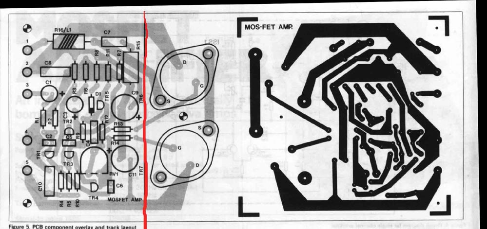

Since building a pair of Hitachi / Maplin Lateral MOSFET amps in 2001, they have been faultless ever since. I have four of these amps, both with the CCS mods.
The amp is based around the Hitachi lateral mosfet apps data, but with added Constant Current Sources, up-rated to run at +/-70v. I would love to post the schematic, but the mods are copyrighted by someone I no longer have contact with (the amp retains the Maplin topology, but uses a CCD to the emitters of the Input LTP and a Constant Current Source to prevent rail sag affecting the Current Mirror).
Up until I added the extra mosfets, which has resulted in the situation I see now, the amp was running just 1 x 16A N-ch + 1 x 16A P-ch Exicon Lateral Mosfet. I've now gone for 4 x P and 4 x N (amps are fully dual-mono).
The mosfets are from sequential production(the kind of issue I have isn't matching related to my knowledge...).
I build the first amp... Bingo! It can sustain up to 3A bias without oscillating. DC offset less than 15mV at outputs.
I build 2nd amp... -32v DC at output... Increasing Gate Resistors seems to make the problem worse! Unfortunately, my 50Meg ‘scope isn’t working, and I can’t even see a blur on my 20Meg ‘scope. Zobel resistor isn’t hot btw.
I wonder if there’s an issue with the VAS, so I swap it against the VAS from the good amp: the working mosfet banks (N+P) are fine with the other VAS, and the bad MOSFET banks won’t work with the other VAS.
As I have a working amp and have swapped the VAS over, I ordered some more mosfets and assumed it was an issue there... New mosfets behave the same…
I match a quad of N-ch mosfets for Vgs and try them – same -32v DC
When I turned on the amp with a +/-50v supply by accident, without any n-ch connections at all (no Gate. Source or Drain), I got -32v DC…coincidence?
There is no voltage between the N-ch and P-ch Gates...v odd. (about 20mV)
The bias trimmer on the problem amp is really non-linear; whereas it’s progressive with the working amp (25 turn pot), it seems to jump from 200mA to 1A bias without warning…almost as if a parasitic oscillation has been triggered….
The amp doesn’t tolerate having a dummy load connected to its output (-32v DC).
The thing that I find puzzling is that the working MOSFET bank works fine with either VAS, with minimal DC offset…
Because the Maplin PCB only has provision for 1 x N-ch and 1x P-ch, I have sawn the PCB off where you see the redline (see attachment). 1.25mm copper wire is used for the Source wiring – it comes off the PCB track and connects to the cases via M3 solder tags.
I can stop the oscillation if I put the MOSFETs back in the place they’re meant to go, still via 1.25mm wire, but with minimal wiring… I can only conclude that my wiring is at fault here… As I’ve included the PCB, I would like to ask: how would you attach the parallel MOSFETs? The Maplin manual shows a diagram illustrating how easy it is to parallel MOSFETs, but doesn’t say how they should be wired…is 1.25mm solid wire too thin?
One idea is to common all the Sources via a heat-transfer bracket, but I don’t know how you’d do that as silicone compound is needed to ensure thermal transfer, which will compromise the quality of connection…how do you do that one? Currently, I have them insulated on a heatsink.

I've tried a variety of Gate Stopper methods; single resistors up to 330R and the Randy Sloane method, where you put resistors on each Gate terminal, with them all fed from an extra resistor.
I powered up 4 banks of N+P and shut them down individually to see how many would be running * if * the oscillation stopped... It didn't...even with just 1 x N / 1 x P.
However, when I put just 1 x N / 1 x P in the same space allocated for the original MOSFETs, fed with 1.25mm wire instead of the PCB which I chopped, all was fine and perfect Class B operation ensued (i.e. current draw went up as oscillator level increased and bias pot was predictable).
With the MOSFETs in the original place, all leads are less than 1" - my problem is trying to figure out how to emulate this with 4 banks of each type...
The most frustrating thing is having one perfect amp...both amps are identical, but the second one won't play ball with any MOSFETs, unless I remove the VAS and couple a pair as they would be in the original amp.

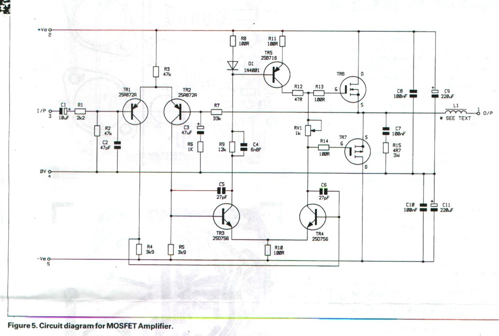

I've attached a schem for the amp. Note that the 47R resistor going to the LTP emitters is replaced with a CCD and R9 is replaced by a CCS. Some resistor values are uprated for higher voltage operation and the Current Mirror driver transistors are replaced with Hitachi BJTs for higher voltage operation and extra drive.

that schematic shows the FETs driven directly by the VAS.
This is not a good arrangement.
The high output impedance from the VAS fights against the low source impedance required by the FETs.
One normally sees a pair of EF drivers between VAS and FETs.
The high output impedance of the VAS could be exaggerating the instability problem with the FETs. In addition, the 4pair have 4times the transconductance of a single pair. This extra voltage to current amplification can also give rise to instability.
As for one amp working and one not, that could be explained by the last paragraph to follow.
Since you are separating the voltage amp from the FETS, can you squeeze a couple of complementary drivers into the spare PCB space vacated by the FETS?
All the voltage tappings for the drivers are there and you would only have to tack on a single or pair of emitter resistors between the drivers.
The FETs vary in voltage between each other far more than BJTs. to get better matching over a range of currents the source resistor absorb some of the difference in Vgs when the currents become unbalanced between the Nsets or the Psets.
At low drive voltages the source resistor has less effect and here accurate matching of Vgs at the operating currents are far more important.
At higher output currents the volts drop across the source resistor becomes ever more significant.
Match the source resistors to better than 1%.
Match the Vgs to better than 10mV.
You have 4pair in 4amps. That's 16pair. You should be able to group your FETs into sets of 4 and hopefully there will be less than 10mV between top and bottom in each set.

It may help if you post a photo of each channel so we can compare them. Identical may not be so.
Andy

AndrewT said:that schematic shows the FETs driven directly by the VAS.
I stand by my statement.poynton said:You have to be careful with statements like that.
The design may not be optimum but you have to remember that this design was published in the Maplin magazine and reviewed again, years on.
The design was also sold both as a kit and as ready-built. Thousands were made or sold. I have six with no problems at all.
Had there been any problems, you can bet that this would have been fed back to Maplin and the design would have been modded.
There have been numerious reports and technical/performance discussion on the error of trying to drive FETs directly from the VAS.
It may be adequate for a low cost, low quality magazine design but that Maplin did not increase the transistor count by two, does not and never can make it good.
And no, I will not take your bet, I am liable to lose.

thermionic said:One option I have yet to try is fitting Capacitors between Gate and Source. I've seen this on a few versions of Hitachi amp and it was also suggested to me by someone with experience on the Exicon MOSFETs.
BTW - Can someone explain to me why I would need Source resistors? I was under the impression they were needed either to prevent Thermal Runaway (not an issue with Lateral MOSFETs) or to provide a voltage for protection circuitry sensing - what other benefits do they have?
Thanks.

sam9 said:
Did any of those reports mention the ESP P101? If so, I would be curious to see if R.E. has a response.
The ESP P101 has both the caps and the resistors.
