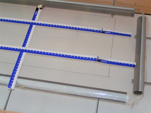

I prefer to use the draw-a-rectangle-and-measure method. Additional tip: use paper rulers (see picture) that are fixed (tape) on one end so you can read the change in length on the other while stretching.
The amount of stretching needed depends on the mylar properties (tensilized or not, thickness, etc...) and on what you want to achieve with the panel (hig/low res, bias etc). My experience it you'll end up somewhere between 0.5 and 3 % in length.
