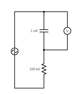

So I did draw a simple and quick mock-up circuit (using an online circuit editor Circuit Diagram Web Editor) which could aid in measuring DC offset on the mains using a multimeter, the multimeter is connected in DC mode and measures any voltage offset over the capacitor C.
R and C values are chosen so that the R is of sufficiently high value so that the major part of the voltage falls over R while near to zero voltage fall over C (that is when there is no DC offset on the mains) at 50-60 Hz, C should be a bipolar electrolyte capacitor, or two back-to-back polarized electrolyte capacitors, the values R = 100k, C = 1000uF in the attached circuit were only arbitrarily chosen for now.
One thing to consider with regards to the R and C values is that they have to accommodate for electrolytes leakage current.
Any opinion whether this could be a suitable circuit to use measuring DC offset on AC mains voltage ,and will I get a sufficiently good read out of the DC value? 🙂

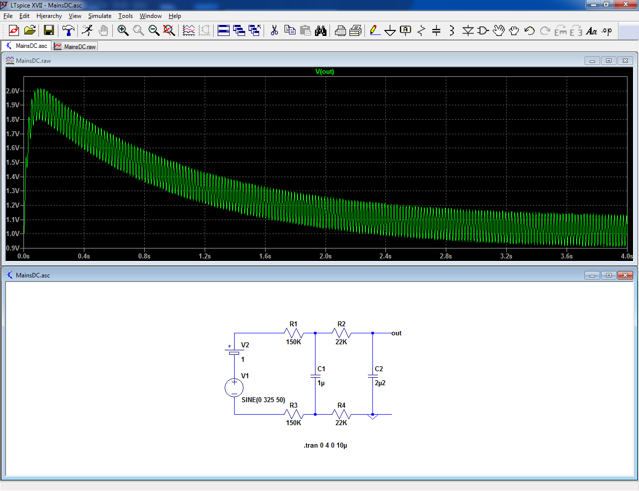

A two-pole, symetrical filter would be safer and more effective:
attachment.php
Note that if your multimeter has a low internal resistance, you should take the 350K of the filter into account.
The filter leaves 100mV peak of 50Hz on its output, which should be no problem for any type of multimeter
Thanks Elvee, that is a better circuit with regards to safety having high value resistor on both side, and good point regarding multimeter internal resistance.
