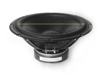

That Peerless 8" is really a 217 mm, which is somewhat larger than 8". A normal 8 incher is usually between 215 and 220 sq cm.
The normal way a cone is measured is to go from the edge of the diaphragm on one side to midway into the surround on the other side. There are different ways of measuring it, but that is the way of audio writer David Weems, and it usually yields results similar to the published specs.

So, when I said 7" I was basically measuring from edge of surround to edge of surround. The basket is 8" in diameter but 1/2" on either side is the mounting flange. So you're saying that I should subtract another ~1/4" (half the surround) from my measurements.
Svante:
I don't think it makes that much difference, but I was given to understand that it is not mid surround to mid surround, but dege of diaphragm to mid surround.
I think both answers would be close.
Using either method, I think Azira will get a Bl number which will give good results in Martin King's TL models.
Yes, that is what I am saying. If the outside edge of the basket is 8", I think you will end up with a result between 200 sq cm and 220 sq cm.
