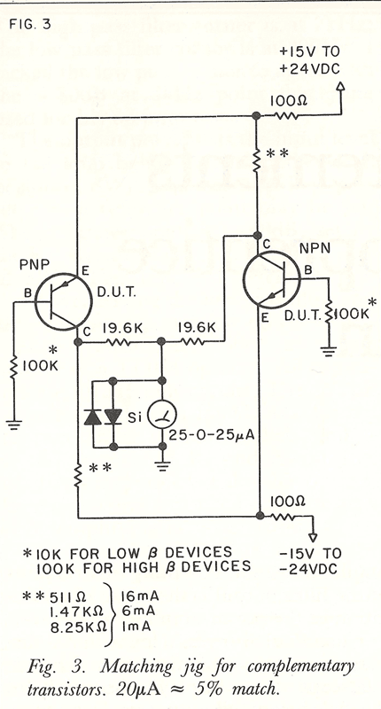

Anyone to know, How to matching PNP with NPN Transistor?
I buy 2N5551= 20 ea. and 2N5401 = 20 ea. then hFE measure is more difference
hFE of 2N5551 = 110 to 130
hFE of 2N5401 = 210 to 230
I am making the power amplifier, when I put them in the circuit, It may be not good sound.
Have anyone suggestion?

The best you can do, short of buying more transistors, is put the closest ones together. If these are for n and p diff pairs, match your pairs then use the closest n and p pairs. This will be better than most production amps so don't worry too much about it.

are you matching Hfe at 1 bias current?
Once you have sets that closely match try measuring the Vbe at a very low current(100uA to 1ma). Select for both Vbe and Hfe matching.

My experience shows that, in order of importance, the pairs must be matched (NPN to NPN, PNP to PNP). Then, each pair should be matched to the other. There is a difference if you include the last step.
If you match these at one current, say 1 mA (common test current), you are already ahead of the game. To complete a great job, thermally tie the pairs together. Now they track.

I normally buy signal transistors in lots of 20 or 40. Generally speaking I can get a decent match in pairs that way. I don't bother matching VBE, hFE is more important. I match them around 1mA collector current, but any suitable value will work. I get very good results this way.
In equipment I service and match diff pairs, they always sound better unless the amp is a piece of scrap to start with. Phase Linear and SAE respond well as do Haflers. So don't become so worried about it.
I match drivers and outputs also. Can make a difference.

The differential pair only works properly when the gains are matched. To get rid og offset, inject a small current into one side of the diff. pair. This is what everyone did before servo amps. Marantz put temperature compensation in as well. Neat huh?

Try this. Find your own values for the transistors you are matching.

This little jig might help you.
