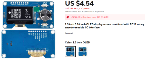

Hi! Did not find any guides about it. Interesting to make such a control frontend for AKM and ESS DIY boards. Something like small OLED screen + encoder and (stm32 ?) development board. But what about coding ?

If you're looking to extract the code, modify and put it back in, then I think that doesn't quite fall into the beginner's league. Besides, you're linking to a China board ...I'm noob in programming, remember only Basic from ZX Spectrum. Hope that may be it possible to correct the finished existing code according to DAC specific settings.
