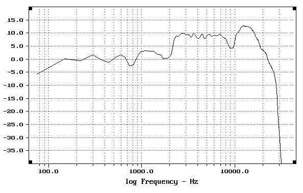

For starters, here's a 1M on axis curve in a large flat open baffle.
It's probable that you will not want to EQ this to flat, but rather to
about half way, and you will likely want to vary the shelving frequency
and amplitude to taste.

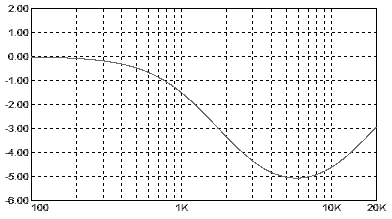

I pulled that up with MicroCap 9. You can download a student edition
from spectrum software. If you want to do that, I'll email you the
file.
www.spectrum-soft.com/demo.shtm
