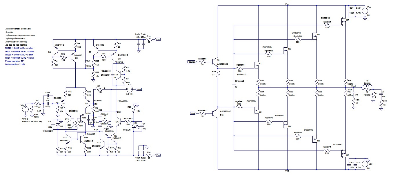

Hi everyone,
I think that I finally hit it my objective, I've to thank you all, especially to astx and ostripper (Peter V), this amp is capable of perform 200W/4 ohm with THD20 of less than 0.005 % and 100W/8 ohm with THD20 of less than 0.004 % 😀
THD1 remains bellow 0.0001 %, (4 Wrms into 8 ohm with 0.000004 % THD1 xD).
To achieve this I've removed the zobel networks (because they cause a huge phase lag) from the MOSFETs and EF, and than with more phase to spare, I can use lower TMC values to increase slew rate 😉
The reverse of this improvement is less OPS stability, due to the absence of zobel networks, but I don't see another option, zobels kill the amps phase margin 😛
Now the amp has 68 degrees PM, acceptable, right?
I'm a little concerned about OPS local stability while driving inductive and capacitive loads 🙁
Circuit diagram attached + models
Best regards,
Daniel
Best regards,
Daniel
Dear Daniel,
you may try some of these steps:
Run SOA tests to be sure your output drivers and power fets will survive.
And then it would be time to build a prototype to verify that your BUZ901/ BUZ906 do what you want.
Good luck, Toni
- try to use BC550C or BC337-40 for Q13/Q14/Q5
- try to use BC560C or BC327-40 for Q4/Q7
- try to use KSC1845 for Q11
- split R6 into R6a and R6b and check when Q12 begins to limit current on maximum load or overload - it should not start current limiting of Q5 even if you are at or near clipping.
- add 47 - 100R to Q17 base
- add 47 - 100R to bases of Q15/Q16 and add a capacitor 22µ parallel to D5
- replace D1-D4 by a green LED and add a parallel capacitor 22µ
Good luck, Toni
Dear Daniel,
forgot to say: don't skip zobel and output coils. This helps to keep your amplifier and speaker running and avoids high frequency oscillation on complex load or EMI from outside. E.g. use split zobels:
amplifier output - 47nF/10R - 1µH coil ||10R - 47nF/10R - speaker output
I have done many measurements and hearing test - this filter doesn't kill your good THD values.
Br, Toni
Br, Toni

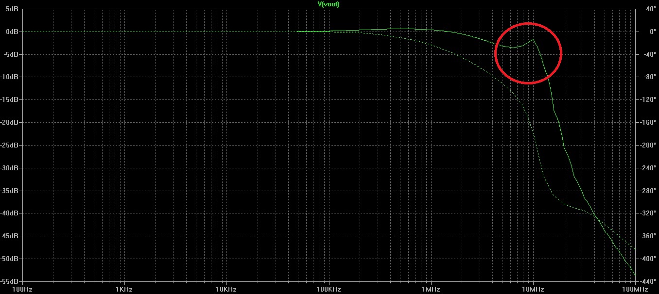

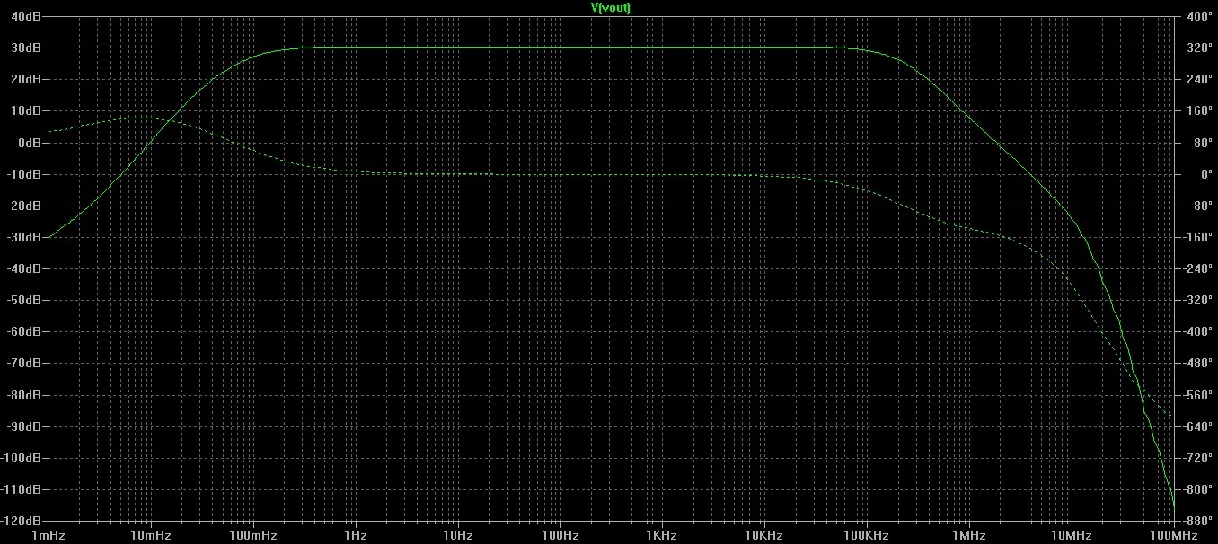

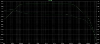

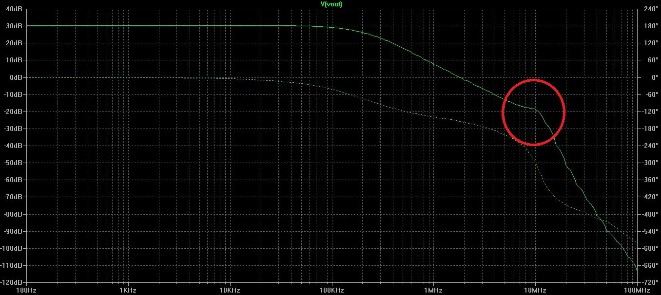

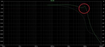

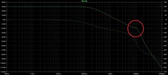

Hi everyone,
I've made some changes as astx suggested, the ones that I've seen that slightly lower THD, and I've added the capacitors. Now I'm concerned about a gain peaking appearing at the MHz region, I don't know if that's normal or it's some form of instability that should be avoided (vout bode plots with v1 influence and vin influence attached). After solving this problem, if it's necessary, I'm thinking in incorporating a simple output protection circuit, maybe similar to the one that astx used, how the values are calculated?
Do you think that I should use a Hawksford error correction circuit like bear suggested?
I don't know almost anything about error correction.
It seems that the problem that causes this peaking is in the IPS or VAS (TCS or TIS) because the amp7_tmc.asc circuit has a similar IPS-VAS topology and BJT output and the same happens. With NPN (IPS) and PNP (VAS) there's almost no peaking, like in circuit amp7_tmc_hb6.asc
PS (about amp7_tmc_hb5.asc): The amplifier has good square wave response, without overshoot.
The circuit's phase margin is 68 degrees.
Best regards,
Daniel
Best regards,
Daniel
Hi everyone,
That peaking was caused because of the MJE340 on the VAS cascode, replaced VAS transistors with KSA1381/KSC3503, and know that's fine
Best regards,
Daniel
Best regards,
Daniel
