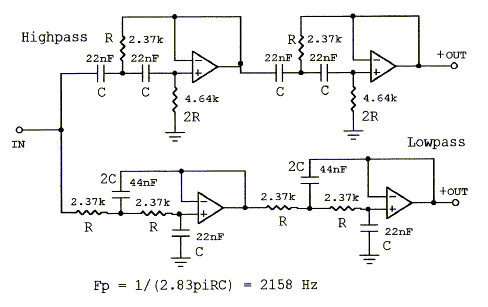

Can anyone point me to a thread that explains how to implement a LR 24db active crossover? I'm sure there must be one somewhere but my searches have come up empty. I don't know where to set the corner frequencies. I'm using Sigma Studio fwiw.

You can just take the example circuit and scale the resistor values for a different frequency.
If you want a lower frequency than 2158Hz, then increase all the resistor values by a factor of ( 2158 / f ).
