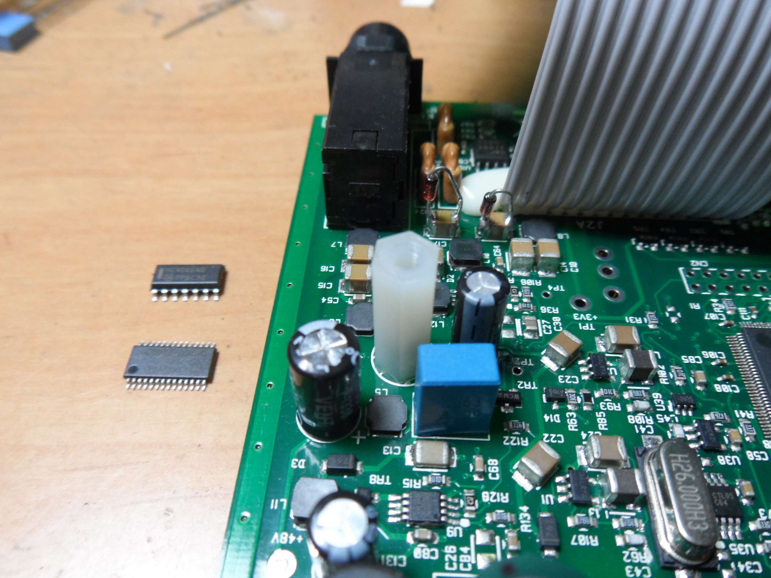

Parts arrived.
- CS4272 (TSSOP-28)
- 74HC4066 (SOIC-14)
I replaced the parts. The TSSOP is easy to solder without special gear (only fine iron and round hot air nozzle), even in a 4 layer PCB with ground planes under the IC, provided that some solder/flux is applied both to IC leads and PCB pads, then hot air never fails.
A quick loopback THD measurement proved both channels in/out to be in good condition.
I added two 5.1V zeners in parallel with the output capacitors of +/-5V PSU. Calculated zener impedance in the 50mA to 100mA range is 12 ohm. Calculated sinking at 6V is 75mA, plus another ~25mA from op-amps, etc. (Picture attached.)
I added 100ohm series resistors to signal inputs (8 in total), by shaping them adequately and soldering them in series with input AC coupling electrolytics. The average drop needed across these resistors to provide the 100mA required to elevate the +5V rail (also used by CS4272) above +6V (CS4272 abs. max. analog Vcc) is 10V, plus the 6V of the rail itself, plus the 47uF electrolytic allowing 2.1V more each 1ms, or the 10uF allowing 10V more each 1ms (until something blows, now the CS4272 has far less chances). (Picture attached, also sowing replaced ICs.)

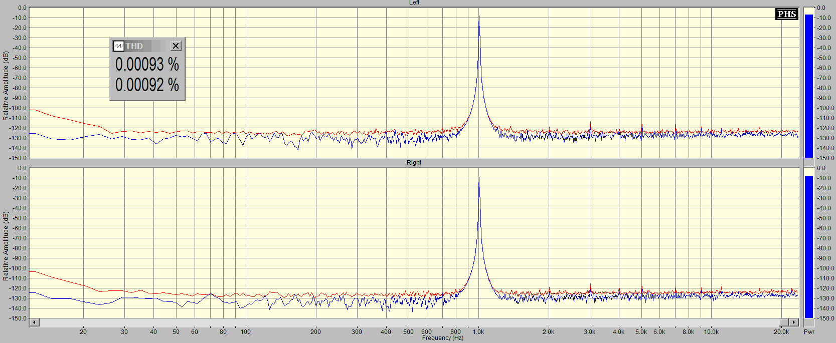

I did a final THD loopbcack testing, it goes to 0.001%, so it is OK for measuring THD. (Picture attached.)

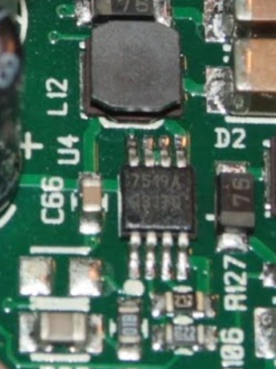

Hello. I bought a Scarlett2i2, 1Gen broken. An HC 4066 was burned. Because of this I lost +/- 5V voltages. Unfortunately someone tried to repair it and he removed U4 I.C. Does anyone know what model this I.C.
Thank you very much for your help!
It's a shame that neither series resistors nor zeners are included. Input protection is cosmetic. The codec chip is only rated +6V abs. max. It has a sticker that says "will fail if input is overloaded".
Series resistors would raise the noise-floor, remember these are also microphone inputs. The lesson is you need to provide your own attenuator/protection circuitry for high power signals.
In other words a dummy load / attenuator unit is what you need to measure power amps using a microphone-capable input section.
7519a (or ISL97519A) pwm stepup regulator.
