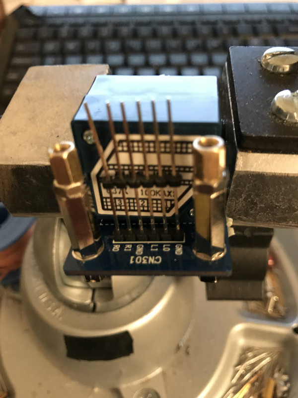

How to install ALPS R27 Volume pot
How to install bigger Alps volume pot....
you do not need additional standoffs.
Connect the long Hex nut and the short Hex nut together with an extra screw included in the kit.
