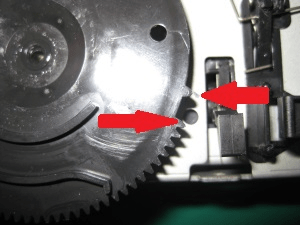

Meanwhile I found an easy way to adjust the tray gear and the cd-tray:
After having taken off the cd-tray, then the metal cover over the tray gear, replaced the gear, then inserting the tray gear (the big black one) so that the edge where it's missing a few teeth - first there is one tooth, then missing a few, then comes the teeth again, is pisitioned so, that the first tooth of the long row of teeth sits a few milimeters after the little hole in the chassis plate, which is left of the bent metal strip for the microswitch. see pic. On the pic the position is not correct it is the tooth that is pointed at, which should be aligned with the little speed marker line on the chassis plate.
Following the picture, the two red arrows should be aligned and point directly towards each other.
As you then slowly slide in the cd-tray, it passes the switch, clicks and then catches on the tray gear teeth. You know it's correctly positioned, when the cd-tray meets no resistance as it's fully puched in.
Another point: if one changes the other gear that may crumble and break, the laser sledge gear "B", be carefull when re-positionin the laser, so that it sits in the middle between the two micro switches that controld the movement stop forth and back.
Hope it make ssense.

Thanks A LOT Jacques for this VERY USEFUL information! I never found the right way to do it on my Krell KAV300CD other than a great number of tries and errors... This should help all CMK4 owners. I keep it on my tagged pages.
