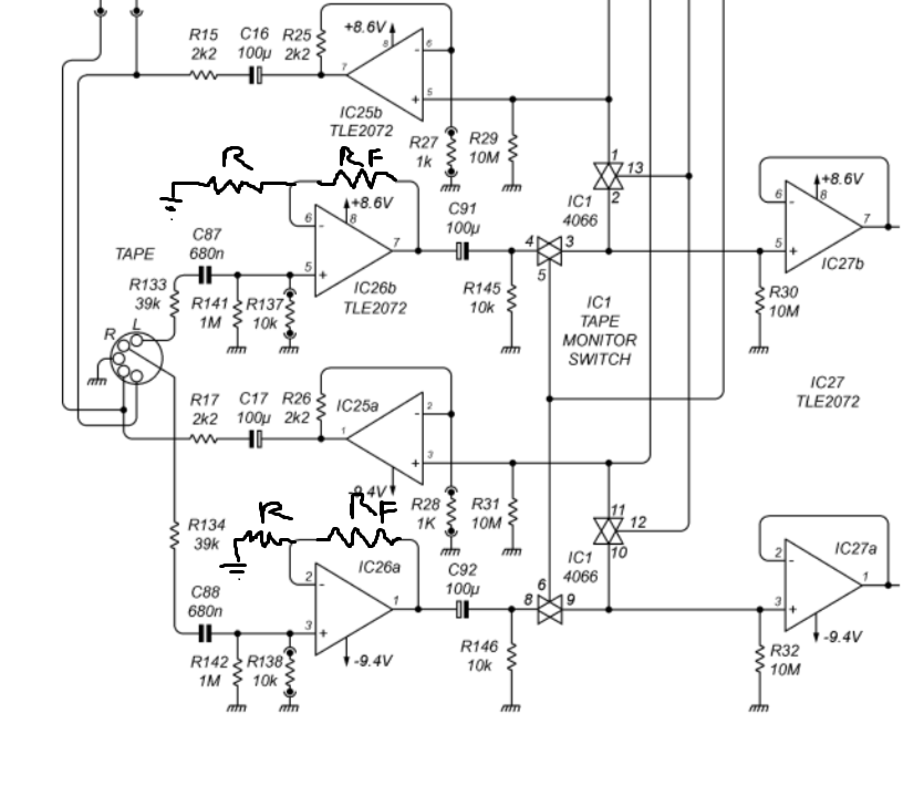

Is there an easy way to increase the gain of the tape input of the Quad 34 preamp, say double.

Cut the print and insert a resistor ( RF on my diagram). 10k to 22k would be a good value. Select R to give as much gain as you want. Gain = (RF + R)/R so using say 15k for RF and 4k7 for R would give a gain of just over 4. Drop R to 1k and you have a gain of 16.
Edit... I've just spotted the input resistors too. If R137/138 are fitted then you have a large attenuator effect. Make sure they are not fitted. You could usefully link out the 39k's in series with the input imo.

Nice idea Mooly, unfortunately its a very early 34 and they dont have op amps on tape input, all inputs are switched to one op amp and increasing gain here would increase all gains. I could add op amp to tape input as in your diagram but that is getting quite major for me.
