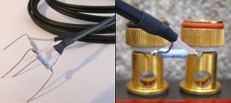

I know you don't need it, but in case someone else ends up using this thread as a reference, I found this picture from the 6moons article useful for building the cable (6moons audio reviews: FirstWatt F4).
Also, having personally built the Elekit, you'll know which speaker output is attached to ground and should be soldered to the RCA ground wire, but everyone using a commercial SET to drive the F4 should double check. As I was warned by Nelson, black does not always = ground.
