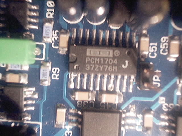

Could any body please tell me how to identify the grading of PCM1704 (say U,J or K) on the chip package?
My CD player claims that it use PCM1704-K, but only have "PCM1704" marked on the chip.
is it U grade?
is it U grade?
It would seem so. Perhaps people here know more about you particular player if you tell us which one it is.

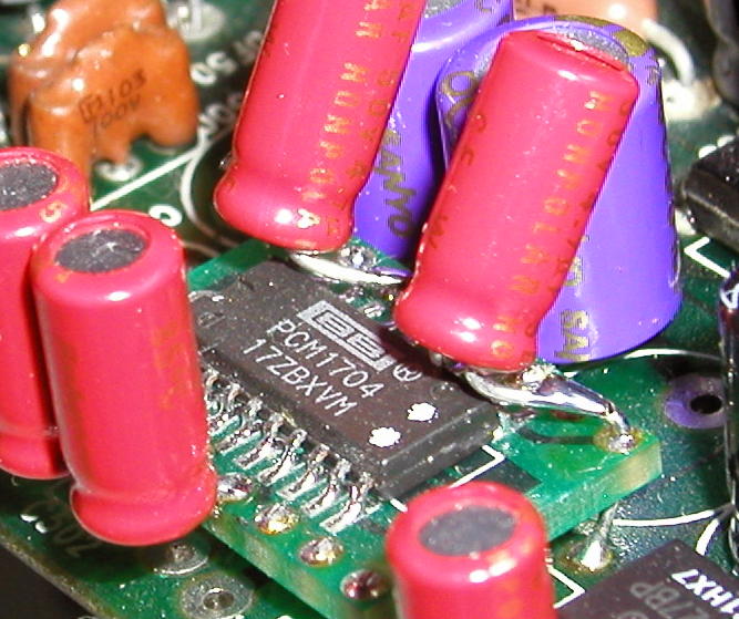

I wrote to Texas Instrument regarding the dot markings.
Here is their reply to my query:
"In response to your query on PCM1704 kindly note that due to marking machine issue, we are marking grade rank by white dot on package.
J-grade is one white dot
K-grade is two white dot.
Hence two white dot pcm1704 parts are from TI and is really K-grade PCM1704."

How about this CHIPS
http://cgi.ebay.com/DAC-IC-PCM1704-/110225607485?pt=LH_DefaultDomain_0&hash=item19a9f54b3d
They have 3 dots 😕
