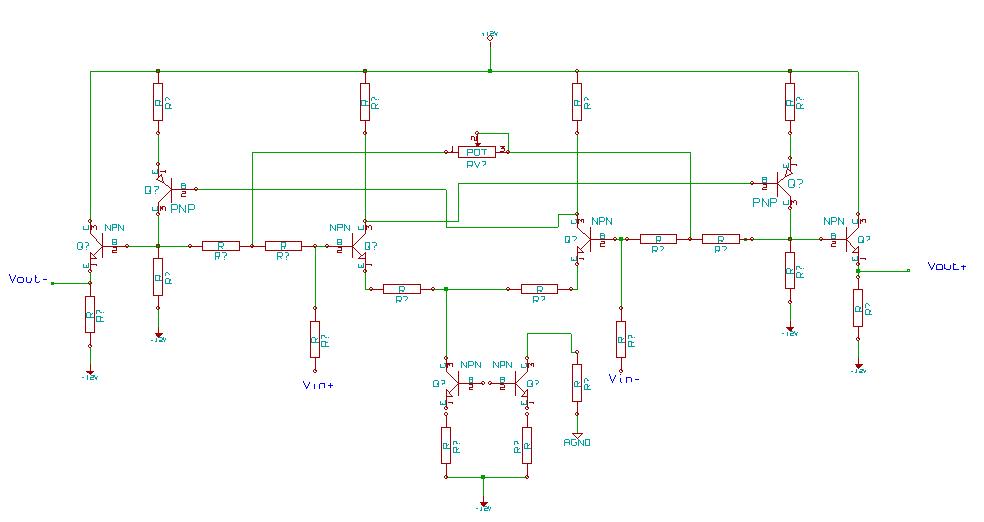

Hello,
Everything is in the subject: i try to build a low frequencies preamplifier with a differential structure (40dB, input voltage swing: from 0.01V to 0.1V and a good THD over the entire bandwith(audio)).
I simulate my circuits in ORCAD Pspice.
With a simple diff pair with current sink followed by a class A amplifier DC coulped with the previous stage (for the feedback) i can't lower the thd specialy when the input voltage rise and i would like to get a good thd over the dynamic of the signal.
When Vce swing Ic swing too so béta swing too=>distortion,
I heard somewhere that cascode could minimize the third order distortion is that right?, is there any other solution?
I also heard about cross coupled amplifier...
If somebody can bring some theory about linearisation of the bjt diff amp...

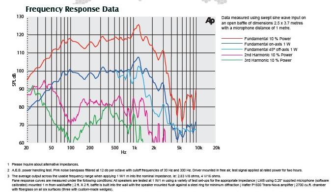

And how I am supposed to learn if I dont join in and ask questions !!!!!
I have been in electronics for 32 years so I hardly a novice !
You need to take a long hard look at a speaker datasheet before having a dig at me.
The Fane Collossus has more curves than Pamela Anderson !!!
nelsonvandal said:
Why don't you show us your schematic?
Enclosed...........

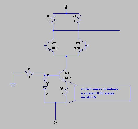

you don't seem to have any global feedback, which is really important with a diff amp. another possible problem is your "current source" which looks like it's operating more like an "amplified" resistor. a better approach would be to dump the "mirror" transistor in the current source and replace it with a pair of diodes. the way a current source works is that it sets up a reference voltage at the base of the CS transistor, usually with a pair of diodes or an LED. the transistor tries to maintain one diode drop across the B-E junction, while dropping the other diode drop across the emitter resistor. the voltage across the emitter resistor reduces the B-E current until it stabilizes at a preset current, and the current source is in equalibrium. any attempts to change that current (such as changing the voltage on the collector) will cause the transistor to maintain equalibrium, which keeps the current constant.

forr, thank for your links,
unclejed 613, i forget to connect the B&C for the current mirror and there is a negative global feedback formed by resistor after class a common emiter stages.
Another question is : if the transistor is current feed then the distortion comming from Ib(Vbe)(with the exponnential relationship) will be cancelled? => if this is right this kind of attack could support a greater voltage input swing than a classical voltage attack (so with less distortion)?
So there is 2 kind of distortion (dependant on amplitude)?
sincerely,
ch
Your EF output stage is not inside the feedback loop. If the output swing is significant, compared to the supply rails, then this will create some distortion. It could be improved with a current source - if you want to keep it outside the feedback loop.
