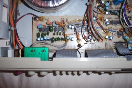

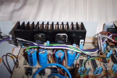

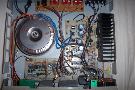

I have an amp that I purchased about 6 years ago for around $100, that is a really nice sounding little amp made for Computer sound systems( although it makes a great little integrated, with a bypass for the EQ). I just found out last night that it uses 2 LM3876 chips. Problem is, it hums. It's not very quiet at all. I really like the sound, but dont like the noise. I snapped some pics of it last night, and was wondering if some of you gurus can look at the pics of the layout, wiring and topology and come up with suggestions of things to check. I looked at the grounds a couple years ago, and tried to clean them, but it do any good. Any other suggestions?

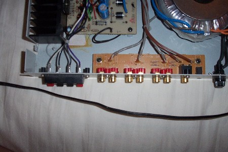

I have one suggestion for you...unscrew that input board at the back and look for some cold solder joints on the bottom.....I had a sony A/V receiver that was humming every once in awhile.....I touched up all the joints and never had a problem again

at the risk of sounding like a NOOB, What do you mean by a cold solder? I notices that night that one of the 4 blue caps by the ICs, is loose on the board. I need to fix that right away. i'm just curious if all the little gizmos, like the output level leds, the eq, the eq bypass, Sub out Mike in, etc is causing too much interference.
I was referring to a cold solder joint...it can happen after repeatively plugging in and out at the back.....if you have a loose capacitor then definately solder that.....while your at it inspect the rest of the bottom of the board and touch up any joints that dont look good....its just something simple causing your noise....the amp is definately worth fixing it has a hefty power supply

Sorry about the double post. Not sure what happened. Well, I checked the input board, and all the solders look fine. I need to get a jewelers screwdriver to get the heatsink off, and I'll check out the rest of the board. I was wondering though, I've been dealing with car audio for a few years now, and one of the biggest forms of noise is signal wires being too close to power wires. Could that be casuing the problem?

The amplifier section should be OK sounding, but the Pre-Amp could be crappy...
Take a look at the ICs in the pre amp, what OPs are used?
Maybe substitute them for better ones...
Maybe bypass the equalizer...
Budget hifi often uses crappy OP amps for preamp, and cheap euqalizers do not enhance the sound like they should, they rather make it worse...

allso if you get a chance try making the sheilded wires going to
rca's longer and moving them away from the transformer they look a little close. one thing i would do is just find somthing to sheild the transformer. try a small pot from the kitchen. sounds weird but it worked for me😉 in the past

I agree that the Pre-amp could be cuasing the problem. There's just too much junk there. and I'll also try to make the cables longer. Any suggestions as to what brand of high quality wiring should be used? (without breaking the bank of course)

leave the sheilded cables for last. try replaceing all 4 caps first one may be dried out or bad. if it was me i would just pull it apart and make a gainclone out of it😉
