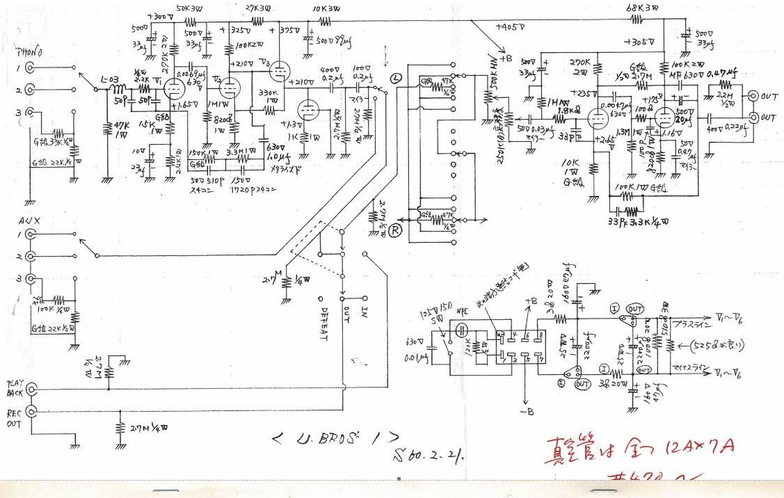

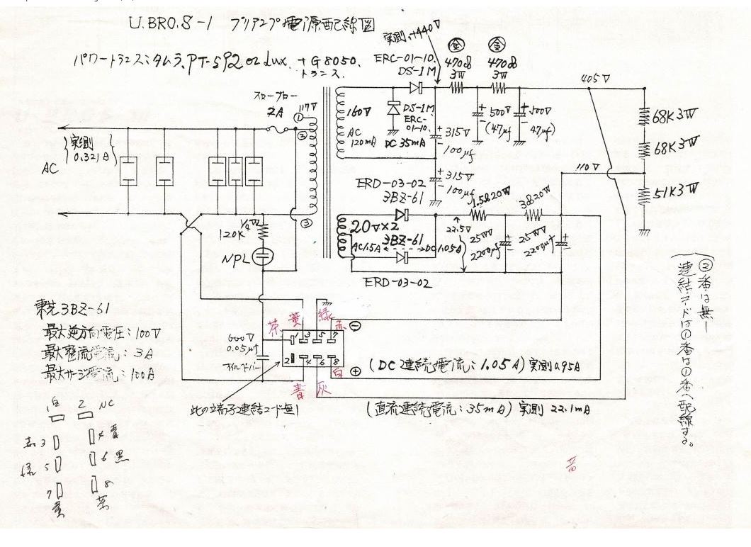

Looks like an old thread but I thought I would ad the attached for prosperity.
I can't tell you much about these schems except that the fella I bought my U1 from passed these along to me.
Anyone out there with a U-1?

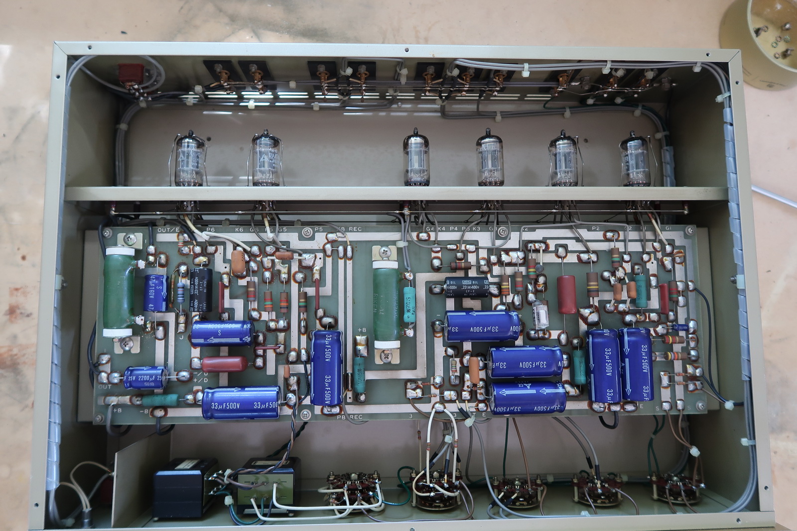

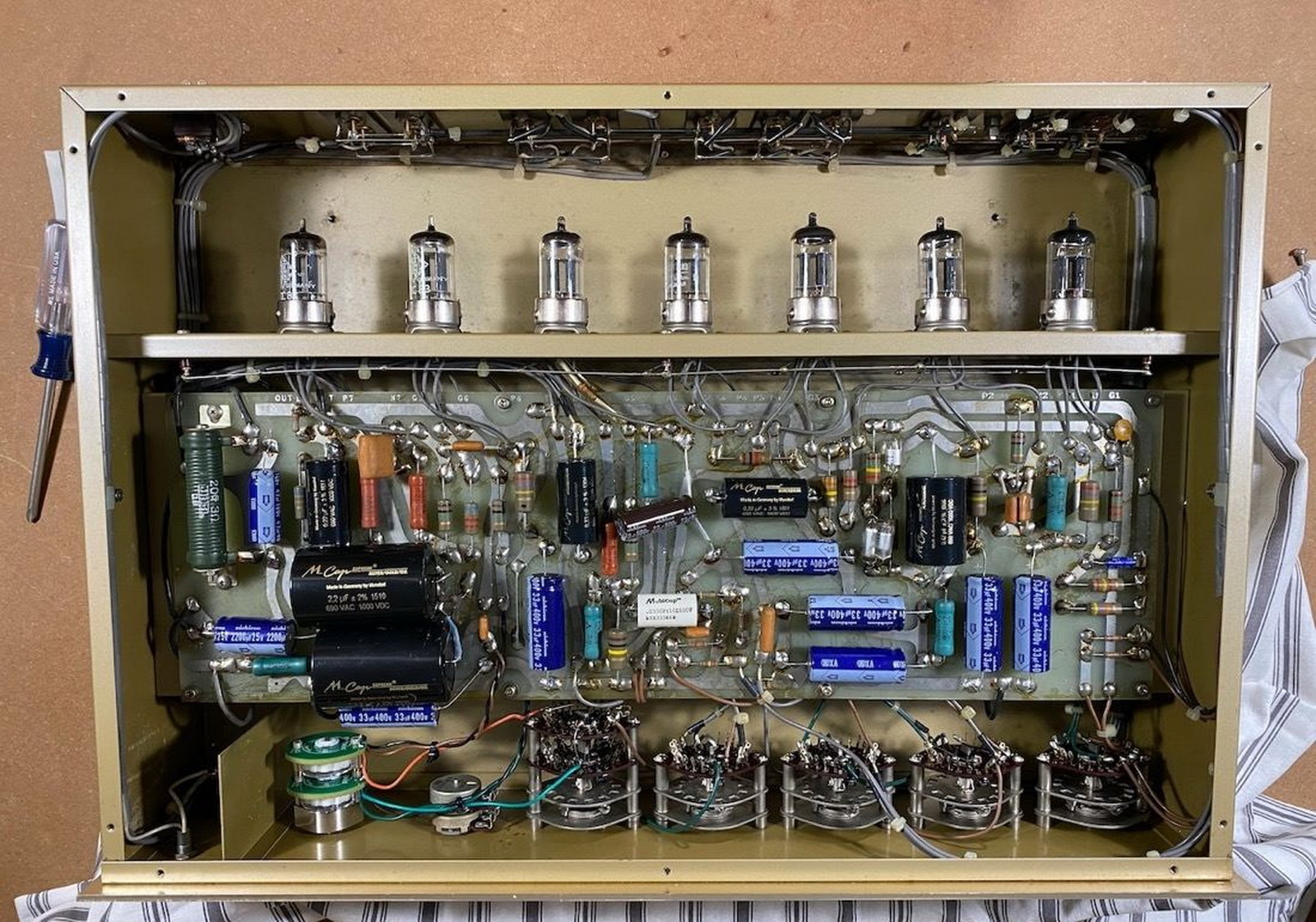

Odds are that seventh tube is a cathode follower output buffer for the line stage. Same specs otherwise.On a side note, my preamp uses only 6 12AX7 tubes. The second photo shows my friend's Rich, 7 tube version converted to a hot-rod. How would it alter the specs the additional extra tube?
