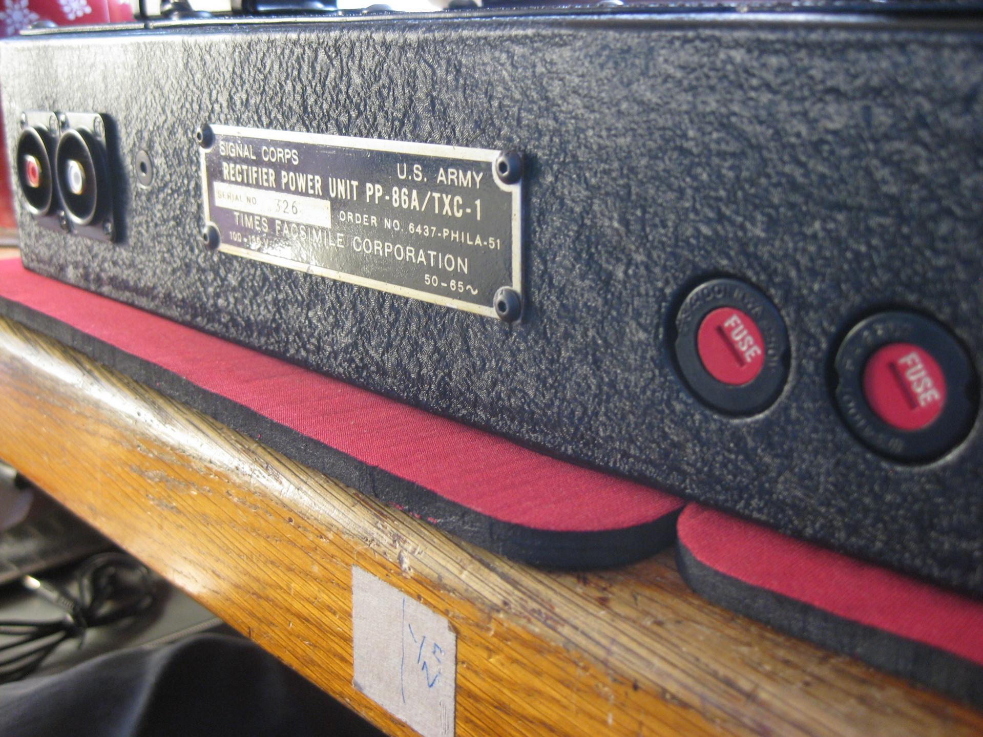

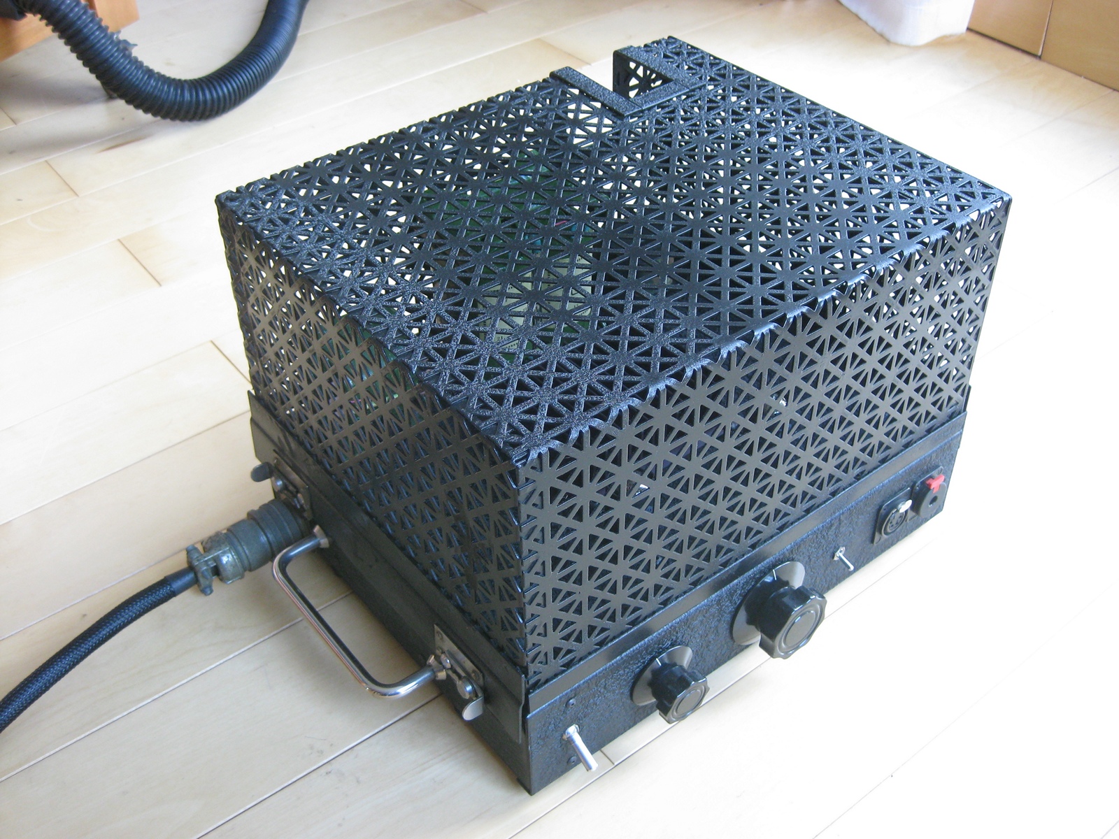

That is how mine was made with the front, back, and top being one sheet folded, then the two sides are spot welded on. Chassis is a repurposed military power supply so i cant take any credit for the design...

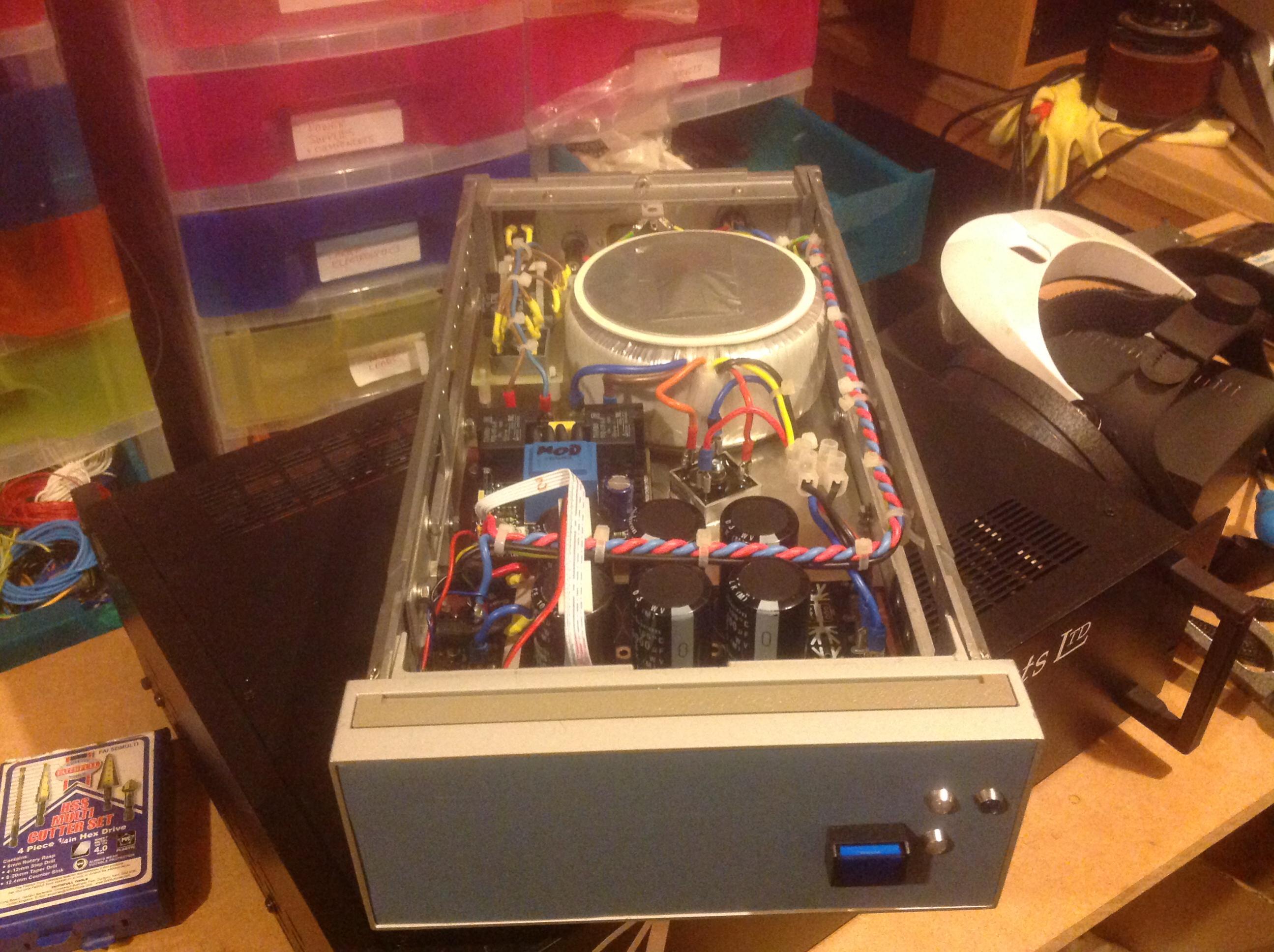

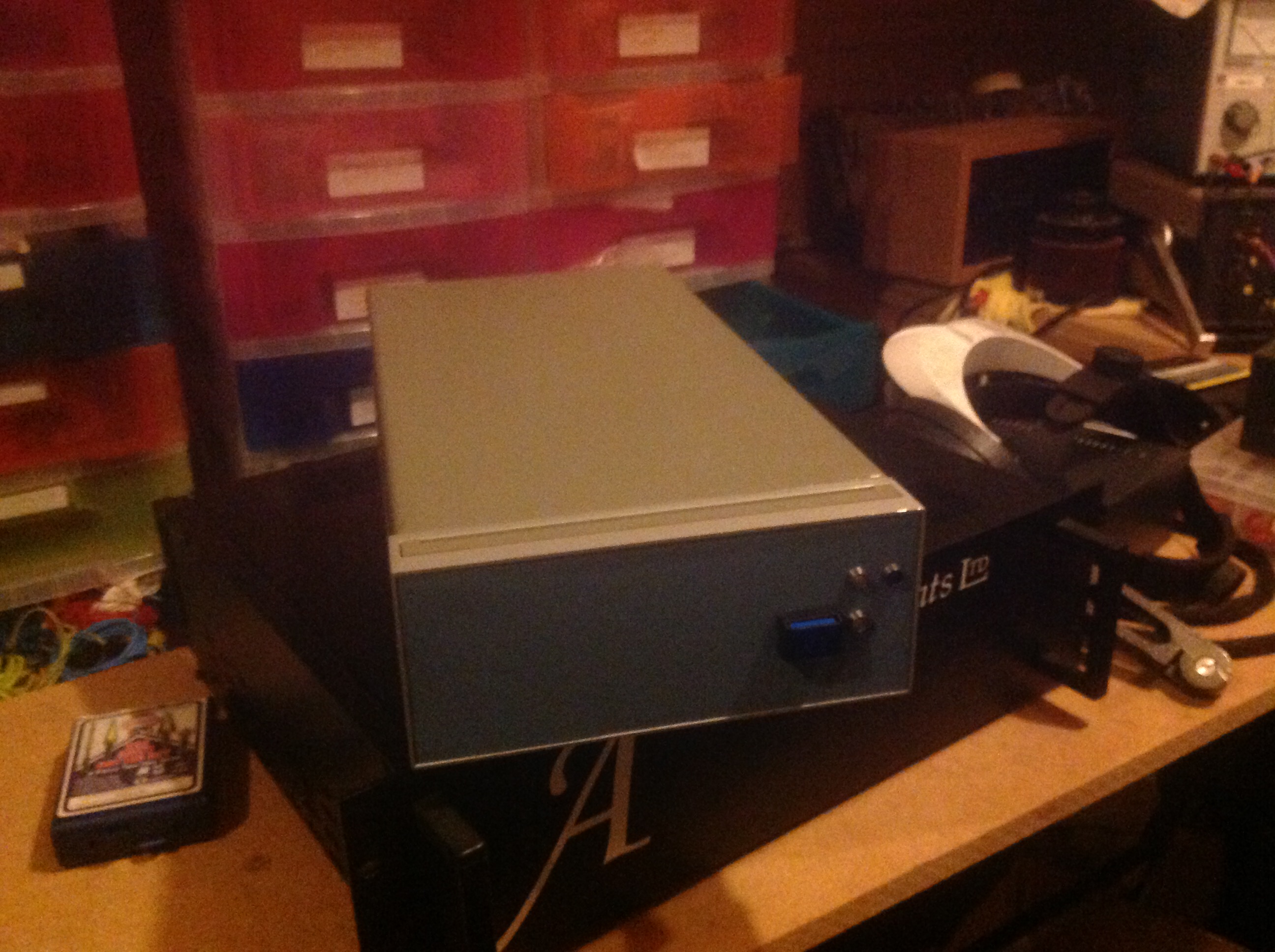

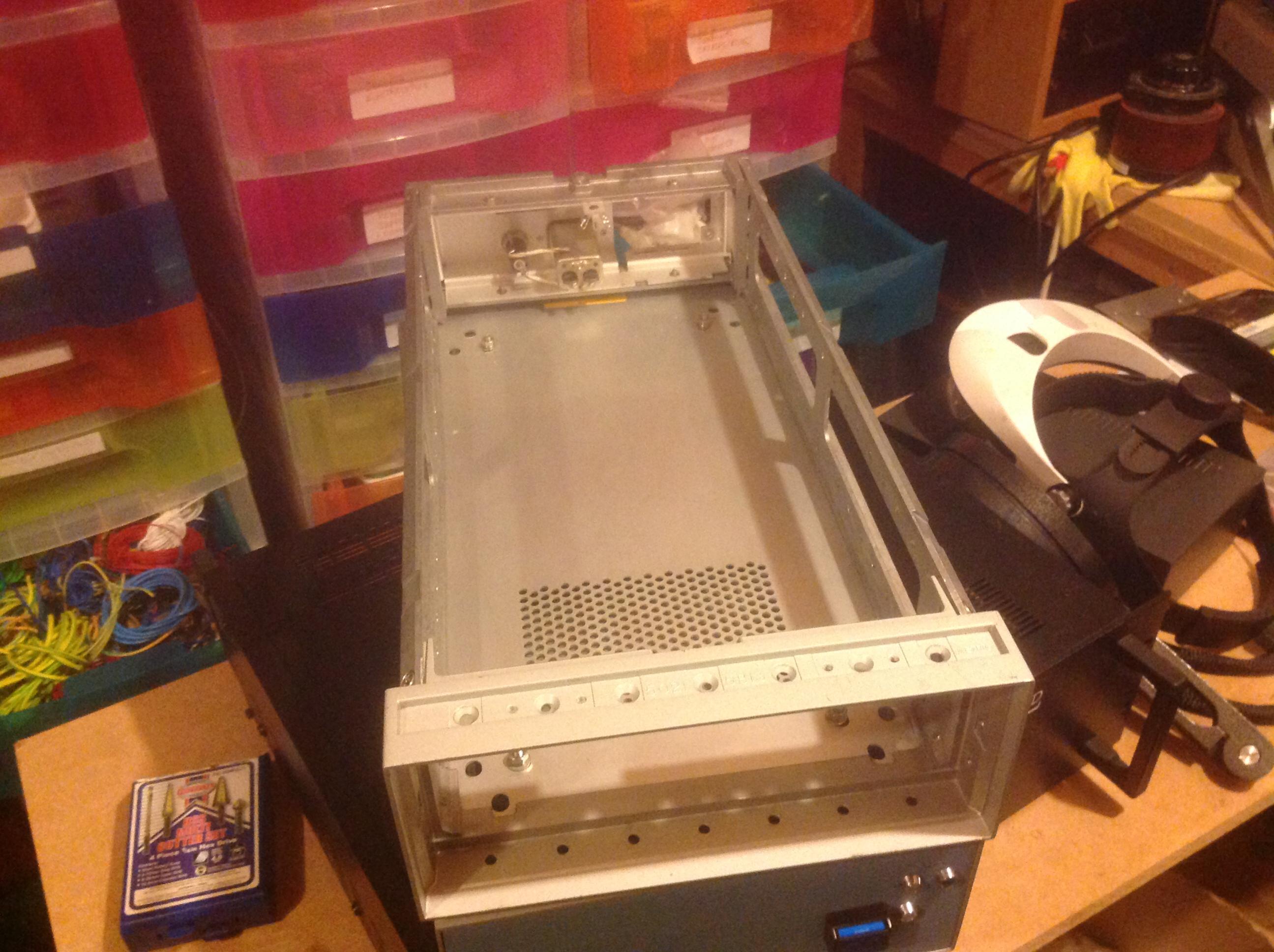

Personally I find it gratifying to buy old instrument cases and adapt them.
Here's an old HP function generator case I got off Ebay for £20 and fitted in a 500VA power supply for my class A amp. The case is superbly built and I often find you get first class components such as IEC mains connectors etc.
Mike
