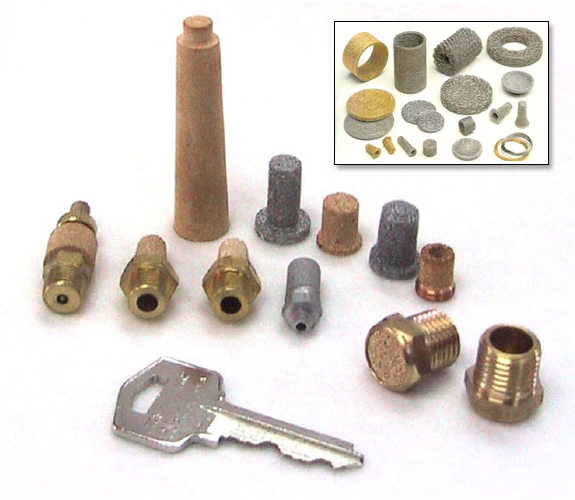

On a lighter note, if a REALLY rich guy got into this field, this is what he might use:
No need to be a rich guy inventing the wheel again, in the pneumatics world you find widley available so called Sintered metal filters and mufflers for small money[FONT=Arial, Helvetica, sans-serif].[/FONT][FONT=Arial, Helvetica, sans-serif]
[/FONT]My pleasure to help you. [FONT=Arial, Helvetica, sans-serif][FONT=Arial, Helvetica, sans-serif]🙂[/FONT]
