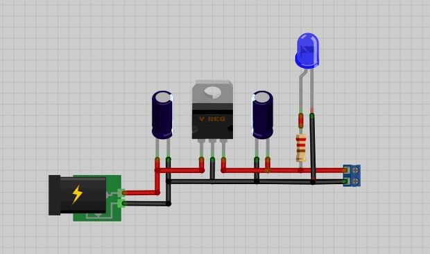

Thanks Rayma, I will go with pre regulation, have attached a pic of the lm7806 reg circuit, can I simply swap in a 7808 regulator or would I need to change the resistor or any cap value?

Stu, the Rasperry Pi should run at 5.1Vdc and optimally the power supply is best specced at 2.5amps.
The 7806 board is only rated at 1.5 amps as far as I am aware.
Also using diodes to drop the voltage may cause issues later as the diodes may vary their voltage slightly depending upon current draw.
Don't forget to put a smaller cap in Parallel with the main reservoir cap to give you a low impedance at higher frequencies and reduce noise.
