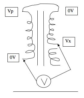

Hi On,
do you have a DVM to measure Vac?
connect one wire from each secondary together to form a temporary centre tap.
Measure the voltage from one free end to centre.
Measure the voltage from the other free end to centre.
Now measure the voltage between the two free ends.
The two free ends should equal the sum of the first two measurements.
If it reads near zero volts you have to swap one secondary around. Disconnect your temporary centre tap and swap one secondary tapping for the other.
Now recheck the voltage between the free ends.
if the voltages are as expected, then proceed.
Note your colours or mark with indelible ink as follows.
First free end = 0Vac, same winding at centre tap = xVac, other winding at centre tap =0Vac, final free end =yVac.
The two 0Vac and the two Vac are in phase.

The secondary phase relation in your solution is good for dc supplies like for amps and so on. Here the relation to primary is not considered. Whereas the trafo manufacturers' 0V will mean in-phase windings. As explained, the mains waveform will be followed by the secondary.
your method determines the relation between two or multiple secondaries, and may not relate to primary. It does not matter in amps, when u don't need to be in phase with the mains i.e. primary.
There are applications where u need to know this.
This relationship can be found without an oscilloscope.
Here it is...
Let all the wires be secured on a strip
Find out secondary phases with your method.
Now short one of the secondary lead to one of the primary lead.
Power the primary and measure voltage at the single primary end and single secondary end.
If u measure Vprimary+Vsecondary, U are in phase.
That means the shorted connection is a OV of one winding and Vx of other winding.
Now relate your secondaries to the primary.
Gajanan Phadte
Edit- In the first method also, the primary relation is not found out. So both the methods do not relate the phase to primary. Do not connect the scope to mains unless u know what u are doing
