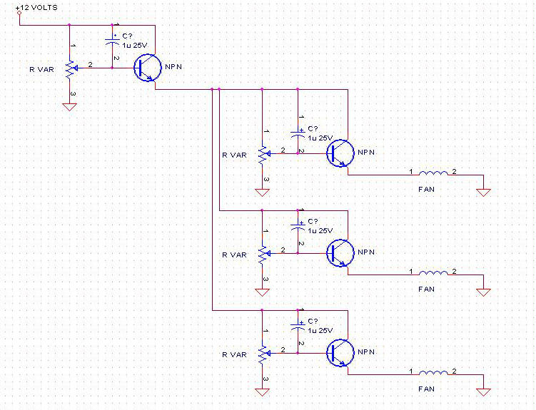

I think that you maybe making it over complicated. Your 12 volts is already regulated so all you need is some npn transistors and some pots. (See attached)
The first cap (connected to the 12 volt rail) should really be equal the sum of the capacitors of the individual fan controllers.
Thanks for the schematic RJM1. The main reason I used LM317 in my design is that it is among the few active components that I actually know 😛 You're suggesting to use npn transistors, but I still don't know what to actually look for when I go shopping... I mean they come in hundreds of varieties and I'm not really sure what parameters to look for. Do you think you could give me an example of a suitable part?
Also, why is my design more complicated? 😕 To my eye it looks simple, and actually very similar to yours (only it replaces NPN transistors with LM317)...
Unless... hang on, what is the role of the 1uF caps in your schematic? They do the "kick-start" function, right? Ah, well in that case, your design is indeed simpler, and in fact exactly what I need. 🙂
