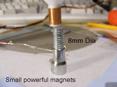

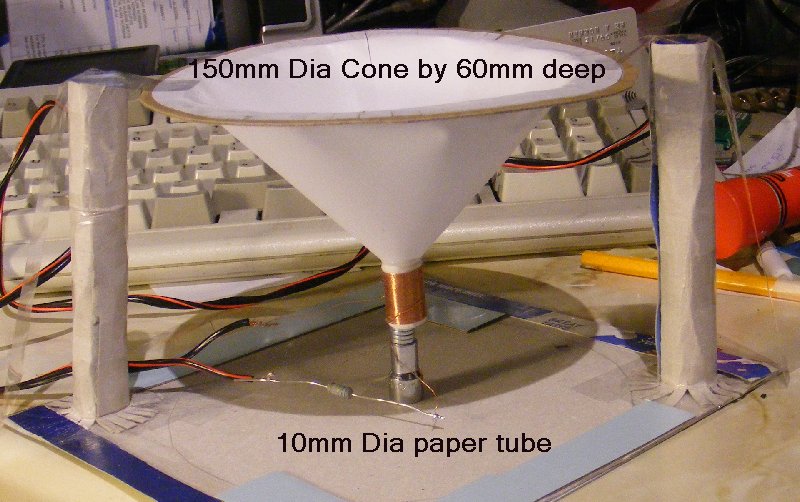

As they say over here, Here's one I made earlier.
This is a demonstration of how a loudspeaker works and can be assembled when needed.
Needs some copper wire. paper, card, glue and sticky tape and a few small neodymium magnets.
Wind the coil on a paper former large enough to slip over the magnets, the more wire the better upto a point - mine is @ 0.6 ohm so needs a resistor in series to stop me melting my amp! If this is 4-8 ohms then you can connect direct.
Suspension is by sticky tape from the paper tubes
Its inefficient, distorts, but demonstrates the principle.

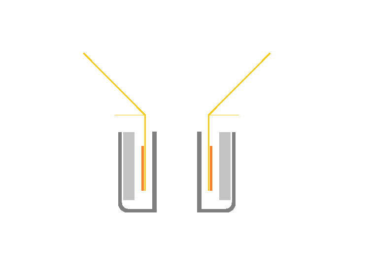

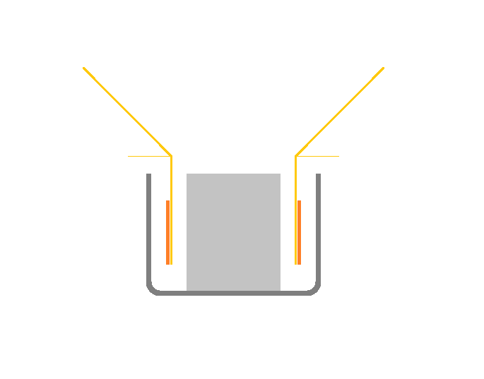

Still an awful arrangement with all the magnetics and coil very wrong.
Not saying it won't make any noise, I am saying it illustrates a total lack of
understanding of the fundamental operational principles of such a device.

And your working design for a demonstration unit from the scrap box 😉
That I don't have one doesn't mean I wouldn't know how
to build one, incorporating the basic fundamental principles
used in nearly all driver designs, and as such as a teaching
tool it would be far more useful than something that works
very poorly because no appropriate principles are used.
I'd have teaching field day giving students 9 neo magnets *,
saying you need steel pole pieces, a coil, a cone and some
form of suspension, go off and try to build a loudspeaker.
Only those who really know their stuff would make any sense of it.
Only the really brilliant would do most things right, very unlikely.
rgds, sreten.
* in this case disc plate magnets, N/S across the discs.
Though an an exercise its never going to happen, its too
difficult in concept at the level I teach stuff to students.
For God's sake, Sreten.
You can be certainly counted on to produce a bitter comment about anything.
As a demonstration device, it's fine.
As of what could pupils learn from it, it will be as much as from a properly designed speaker, even a commercially built one, that's to say NOTHING if left on their own, simply because most Electrical phenomena are not at all self-evident (as, say, Mechanical phenomena are).
Electricity, magnetism and a host all other Fields are invisible to the naked eye, yet they are real and can be explained.
Teacher's commitment and ability to explain is the key here, and since I very much doubt you were in Spiny's class, don't know how you may have the gall to comment unfavorably on what was taught there.
If anything, build a working example, write an explanation and post them here.
Then let others decide.
Regards 😉
