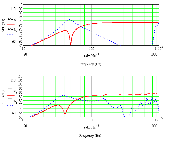

Just as a note, Mark Audio drivers generally require rather less compensation for step loss than most drivers as they have some correction for this built into their own response.
The transition from a bass reflex to a QW box occurs at the point where the tuning of an enclosure is affected by the standing waves present within it, so basically as soon as you need to modifiy the vent dimensions because of this.

How does one know when the standing wave is effecting the vent design? Does this become obvious from software? Does it only become obvious in MJK's software?
As noted above, when the cabinet is no longer tuned to what bald BR math states it 'should' be. Regular BR modelling software doesn't show it, Martin's worksheets & Augspurger's TLwrx are probably the most accessible of those that can. Hornresp can to an extent, but it's limited in terms of driver location, damping etc.
See attached. Same driver, in two cabinets of identical volume, with identical vent dimensions, yet Fb is 10Hz lower in the case of the 2nd cabinet, plus you can see a series of pipe harmonic resonances. This is only a quick example -neither cab. is optimal, but I had it to hand.
