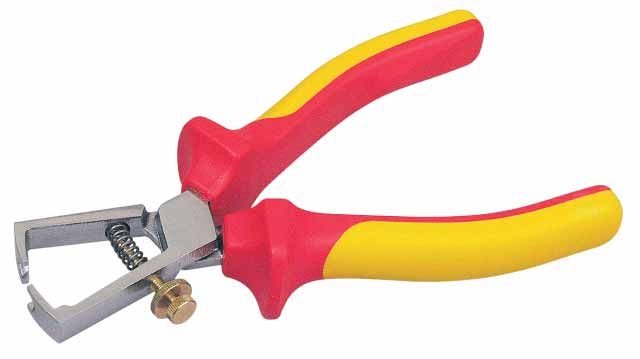

I am working on a switch mode power supply.
I have found that using four strands for a conductor works well.
However I was told that Litz wire is the best way to go.
How do I work with say 100 strands ?
How do I remove the insulation for soldering ?

If you adjust this one not too tight it will work OK. Otherwise precutting with a Stanley knife works too. One circular cut and one vertical one should be enough. Test a few times on a piece of that specific cable and try to cut just deep enough so without touching the copper. You can pry the cable's insulation open by the vertical cut and when you reach the circular cut you'll see that it can be removed easily.
