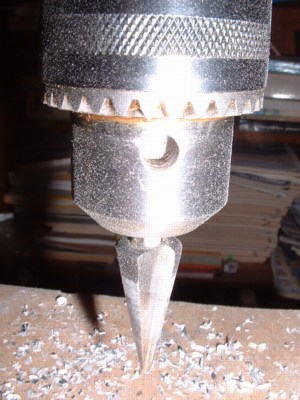

The very simple step drill that pinkmouse mentioned is a very cheap way of getting the job done. They generally cost less than $30.00 if cost is an issue. In addition to cutting the hole they can also deburr the opposite side when you turn it over. I have punches I could use but I prefer to use the step drill for this operation.😀
Joe
Joe

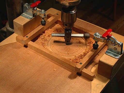

Just to give you another possibility:
I have recently cut some large ~70mm holes in 6mm aluminium.
I used a "fly cutter", at least that's the UK name.
You need a "pillar drill" (drill press). It must be run at the lowest speed.
It was necessary to bolt the workpiece to an MDF base, and to flip and cut from each side, (changing sides at half time🙂)
The results are good, but I wouldn't recommend it for "normal" chassis work, just for thick material, or holes too large to punch.

I have had good luck with a circle cutter for big holes and unibits for the smaller holes.
ck
ck
