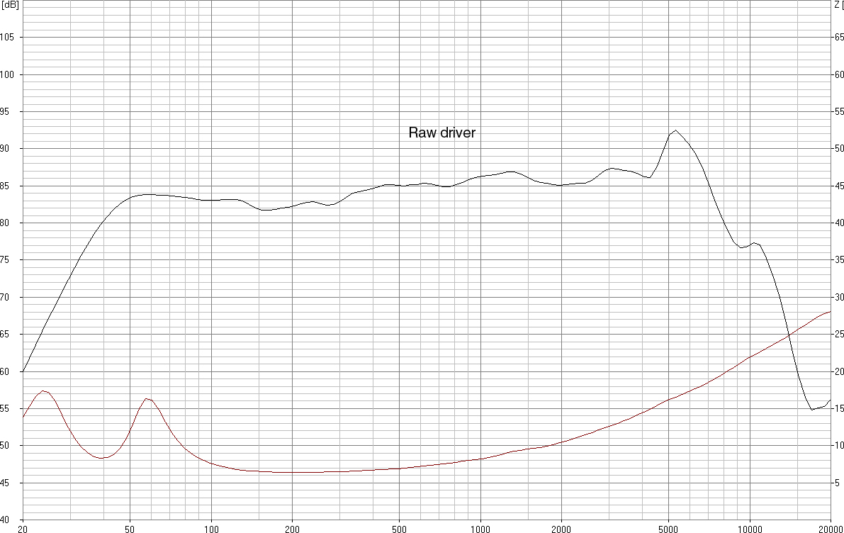

I'm planning to do a Baffle Step Compensation for my woofer. I calculated the values of BSC on the website and the website told me to use Rbsc = 6.1 ohms and an inductor(Lbsc) of 1.8 mH in parallel to make a BSC (image 1).

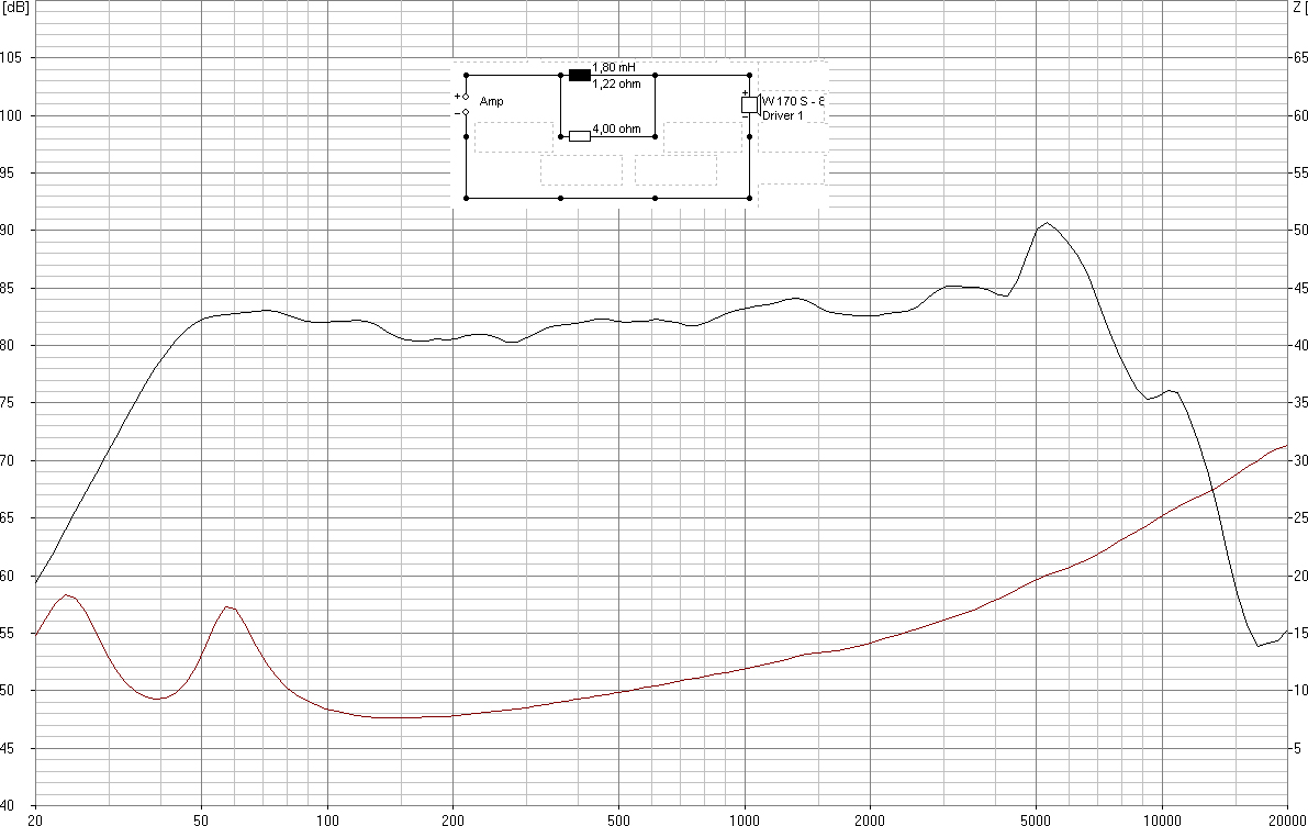

The problem is when I went to look at an inductor, the inductor was said it has a resistance about 1.22 ohms on it. So if I install all the components (image 2), Do I have to choose the value of Rbsc to compensate the effect from inductor's resistance ? and How is that value ?

Thanks a lot for all above answers but I still don't understand, sir. 🙁
I want to know if I want to build a BSC that require a 6.1 ohms resistor parallel with a 1.8 mH inductor. BUT in an inductor, there's some passive resistance of 1.22 ohms.
So, Should I have to replaced a 6.1 ohms resistor with a (approx) 4.88 ohms resistor to compensate it ??? 😕 (in order to make the whole resistance of this BSC's remains 6.1 ohms)
Note : The value 4.88 ohms comes from 6.1 - 1.22 ohms.

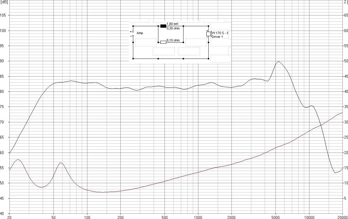

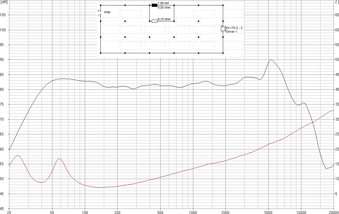

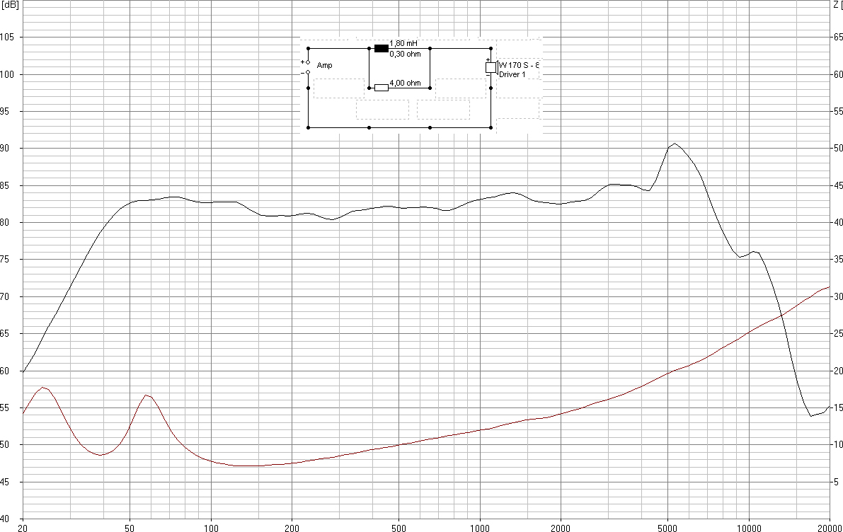

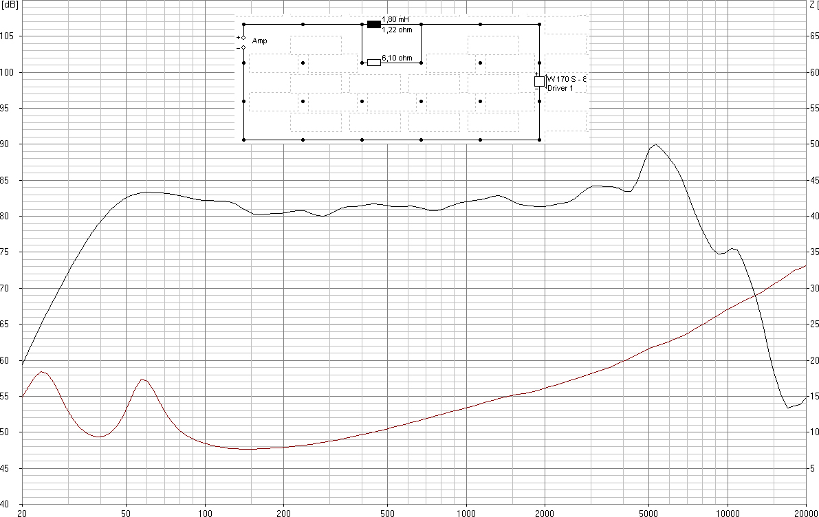

This should clear any doubts. If you are not concerned about 1,22 dcr
of the coil and what it does to your bass response, go with it and 6,1 ohms
of bsc resistor. These simulations base upon using Visaton W170 S-8.
Lowering resistor value of bsc, lowers the effect of bsc filter.
