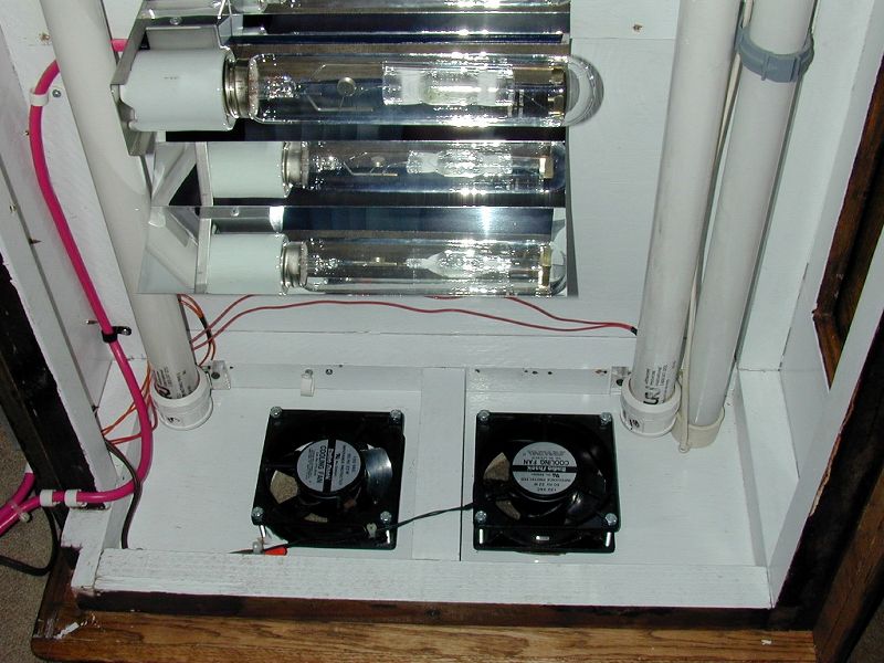

I read this on the net, is it true? So how should I ventilate the bulb? From above drawing air out? Any body have sugestions on ventalation. Its a 150watt MH...
One more thing
If I make a reflector like this parabolic one for a fish tank will it be O.K.? Because someone said about the light hitting the bulb and it overheating? THis is basically 5 pieces of mirror and flat shaped I guess we wont curved the whole way around 50% bulb?

Hi Tinker,
Don't worry about reflected light from such an arrangement killing your bulb.
It would only be a problem if your bulb were at the center of a spherical reflector with a HIGH percentage of reflected light (anything above 25% ish) being directed straight back into the bulb.
Bill.
