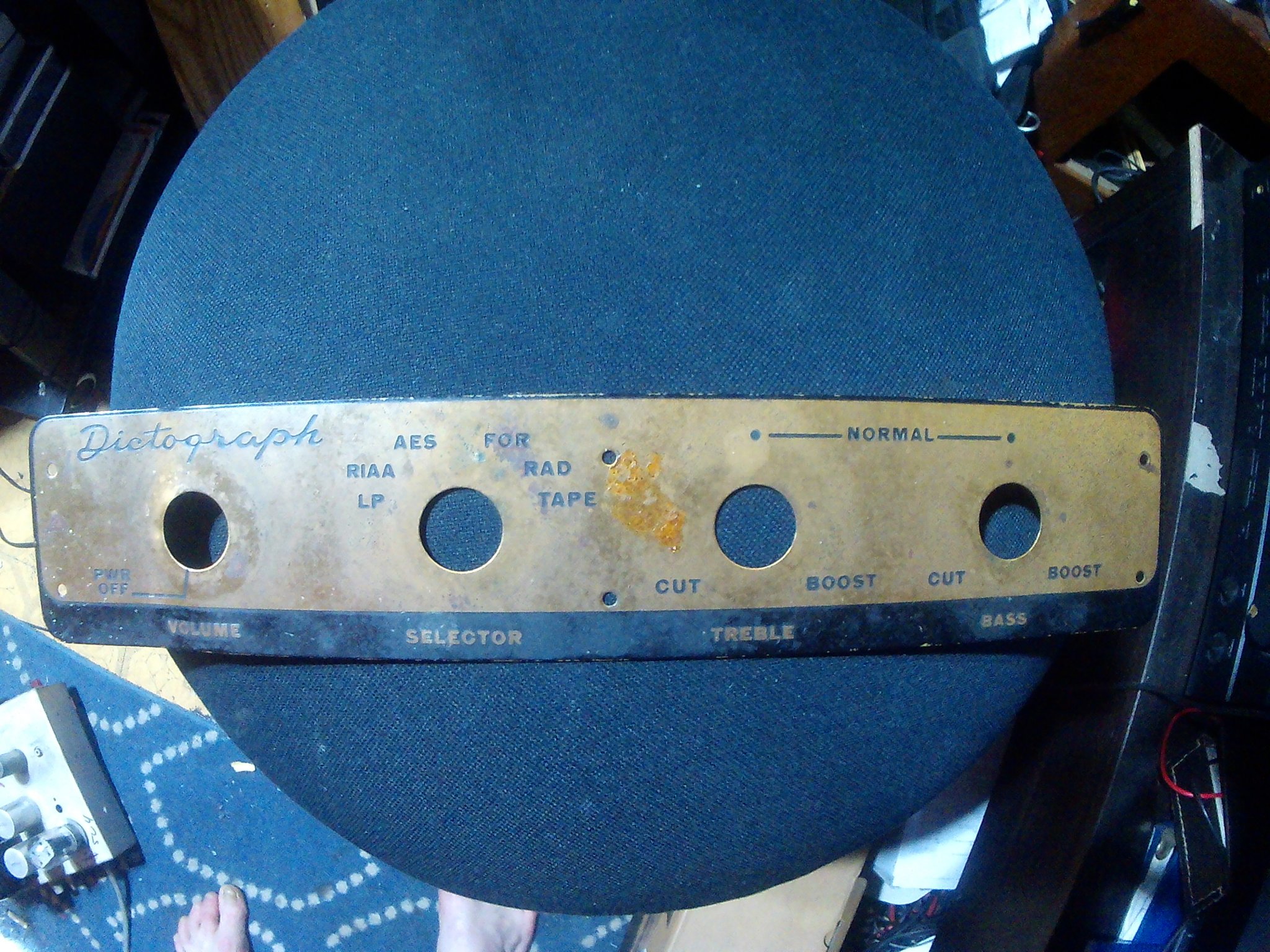

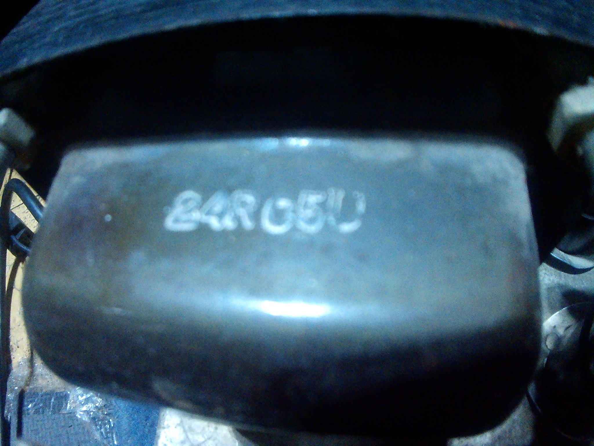

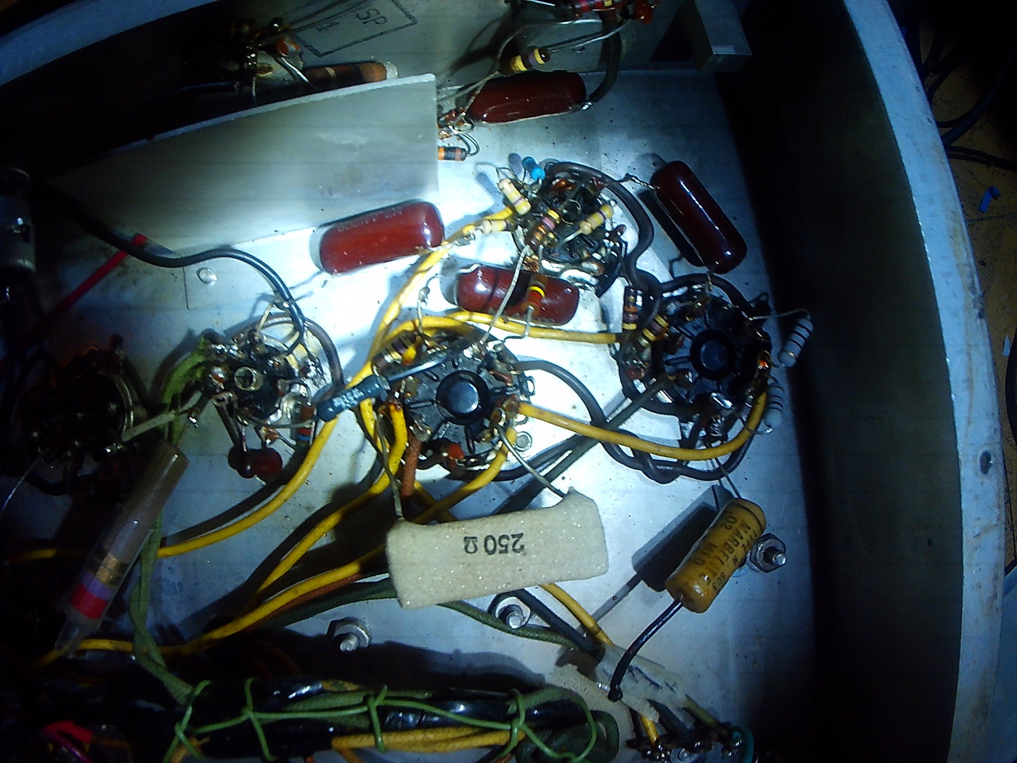

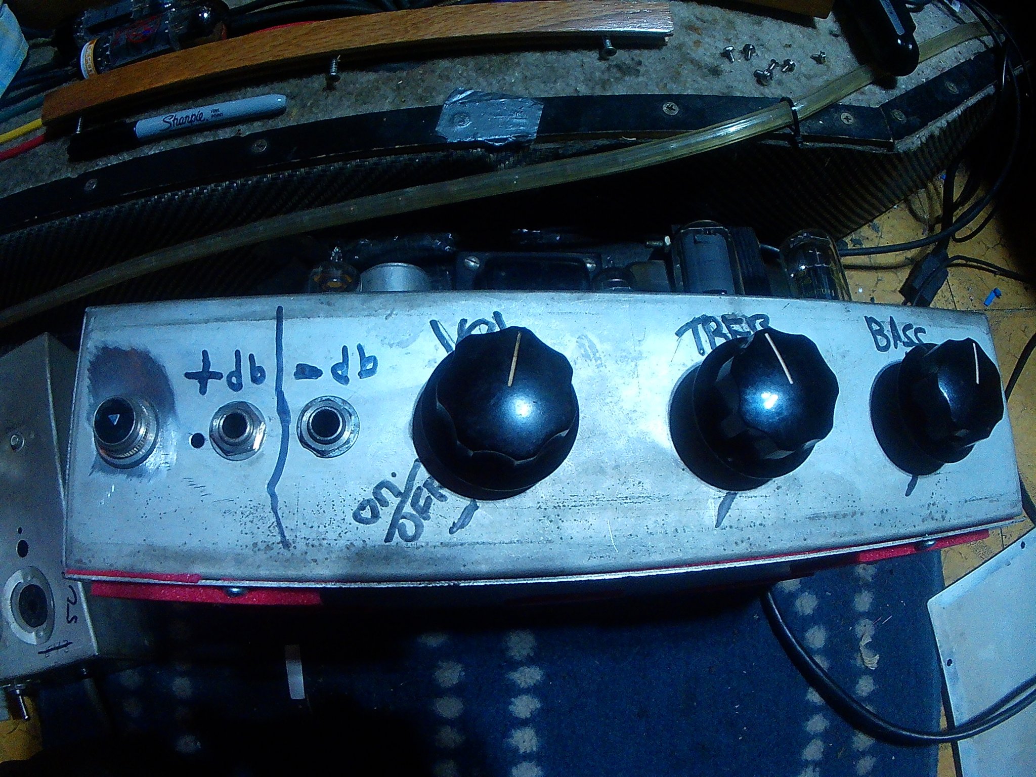

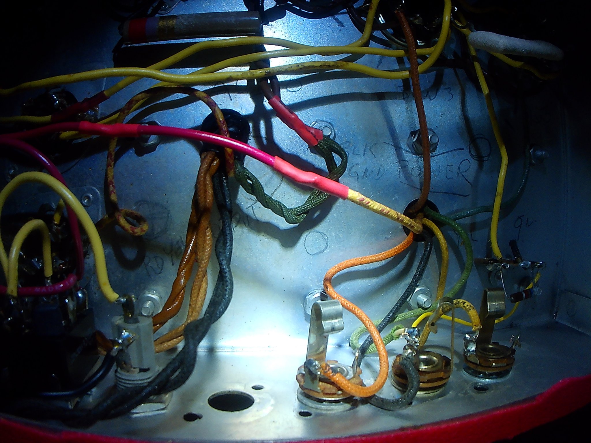

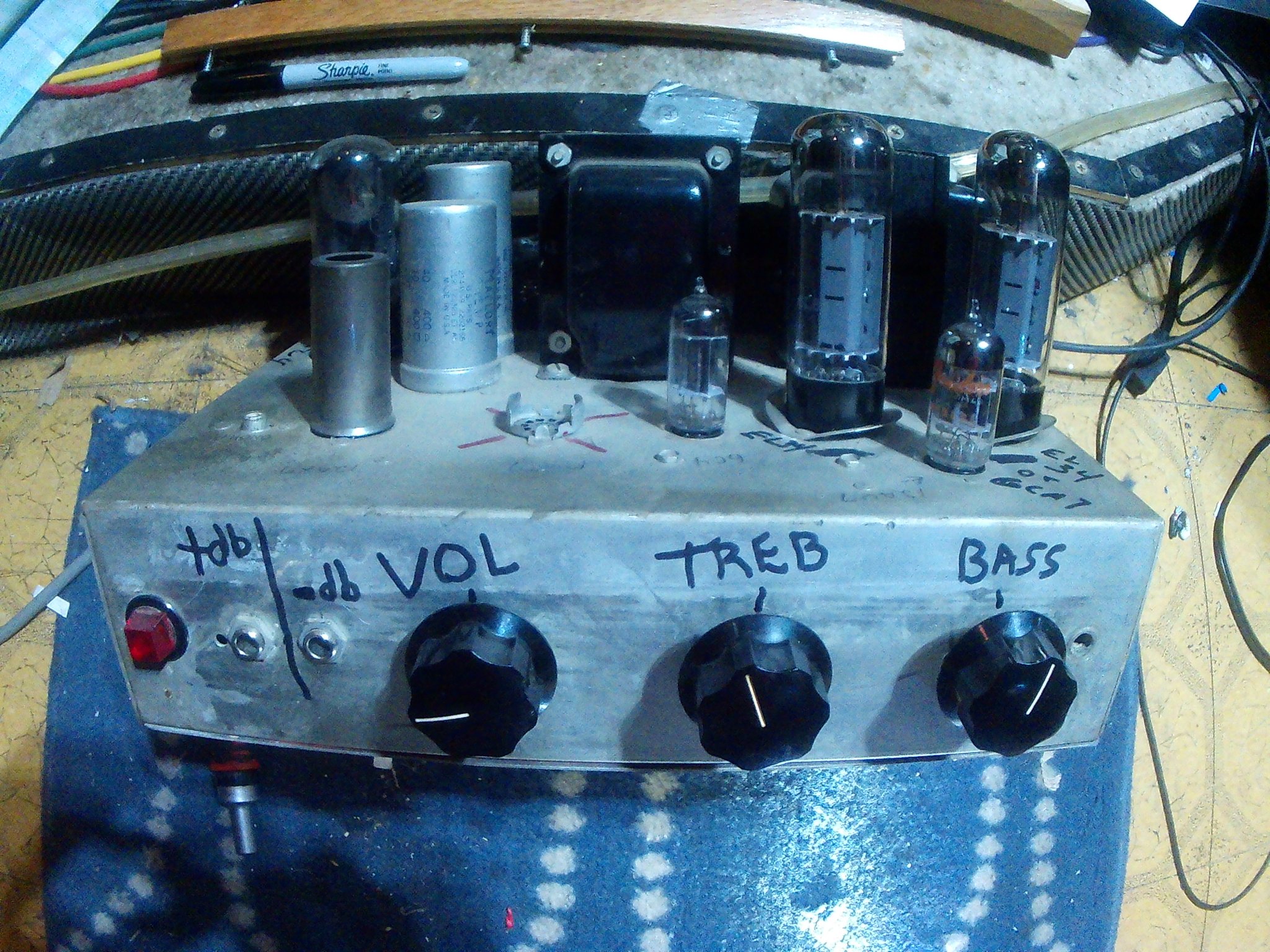

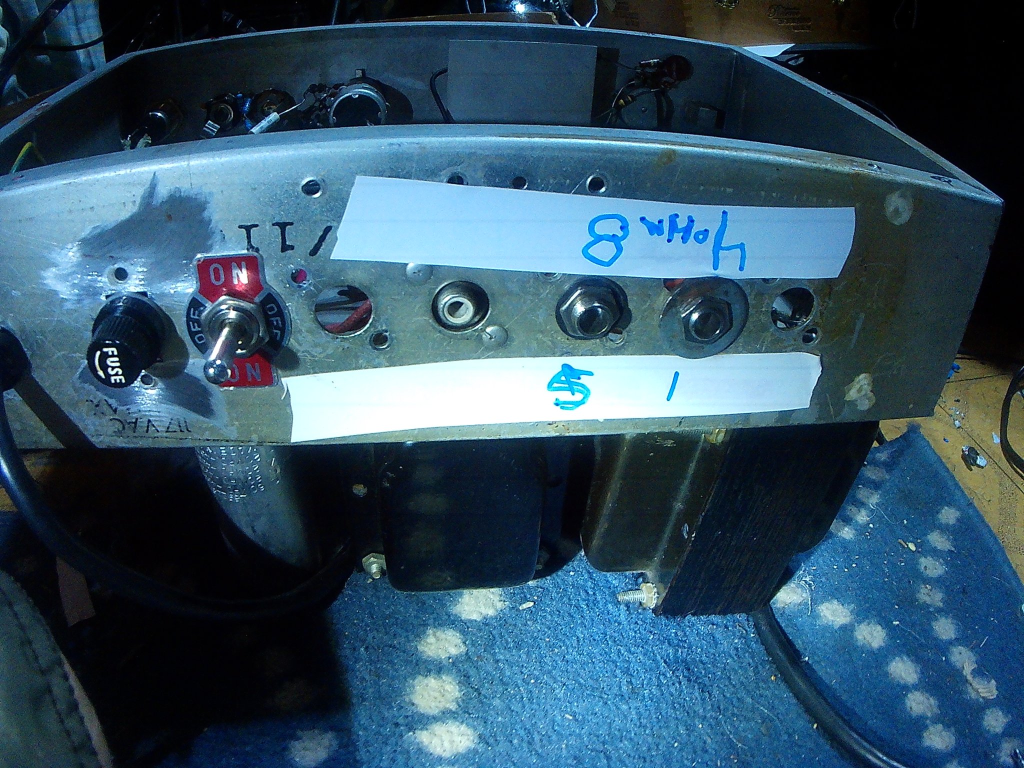

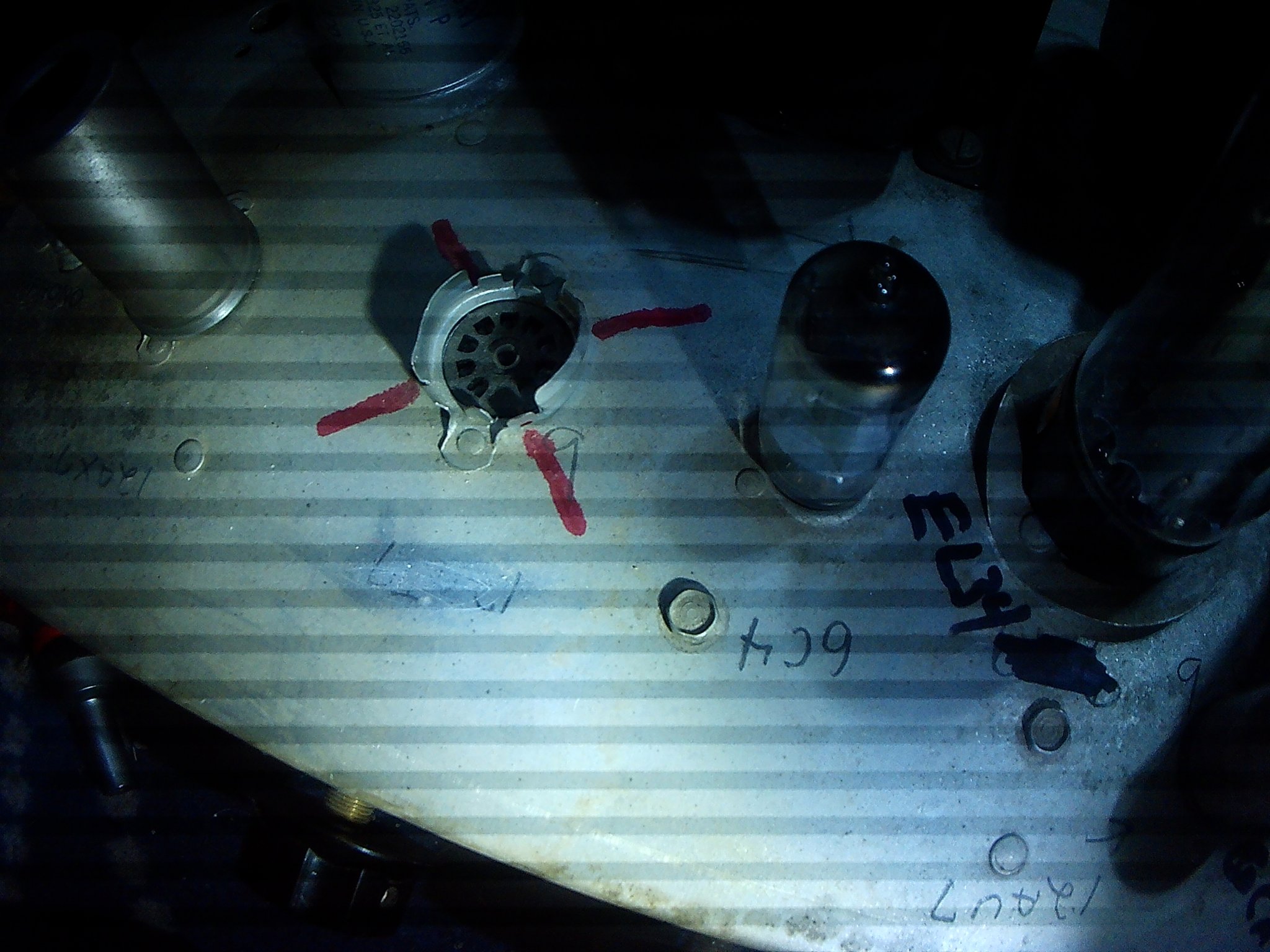

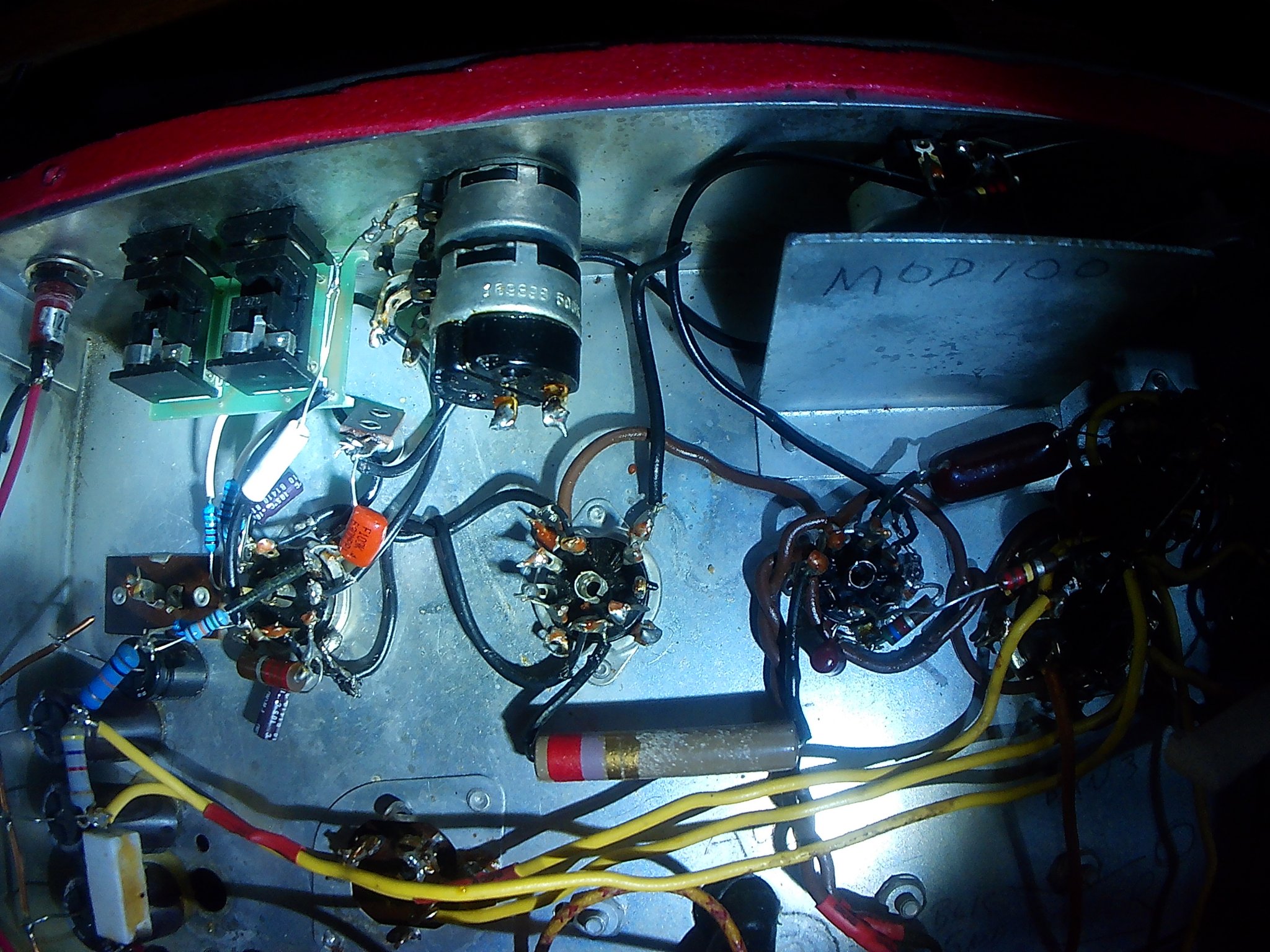

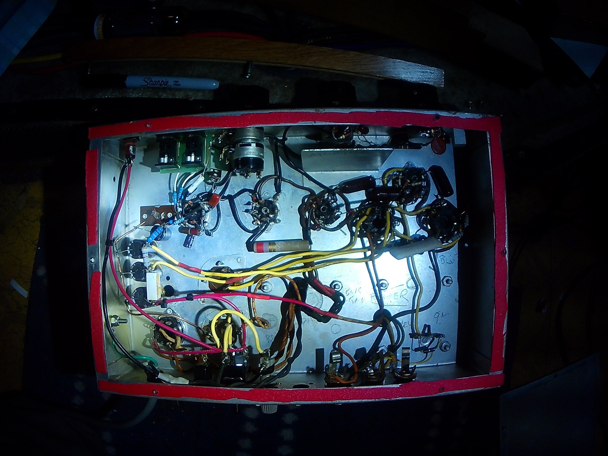

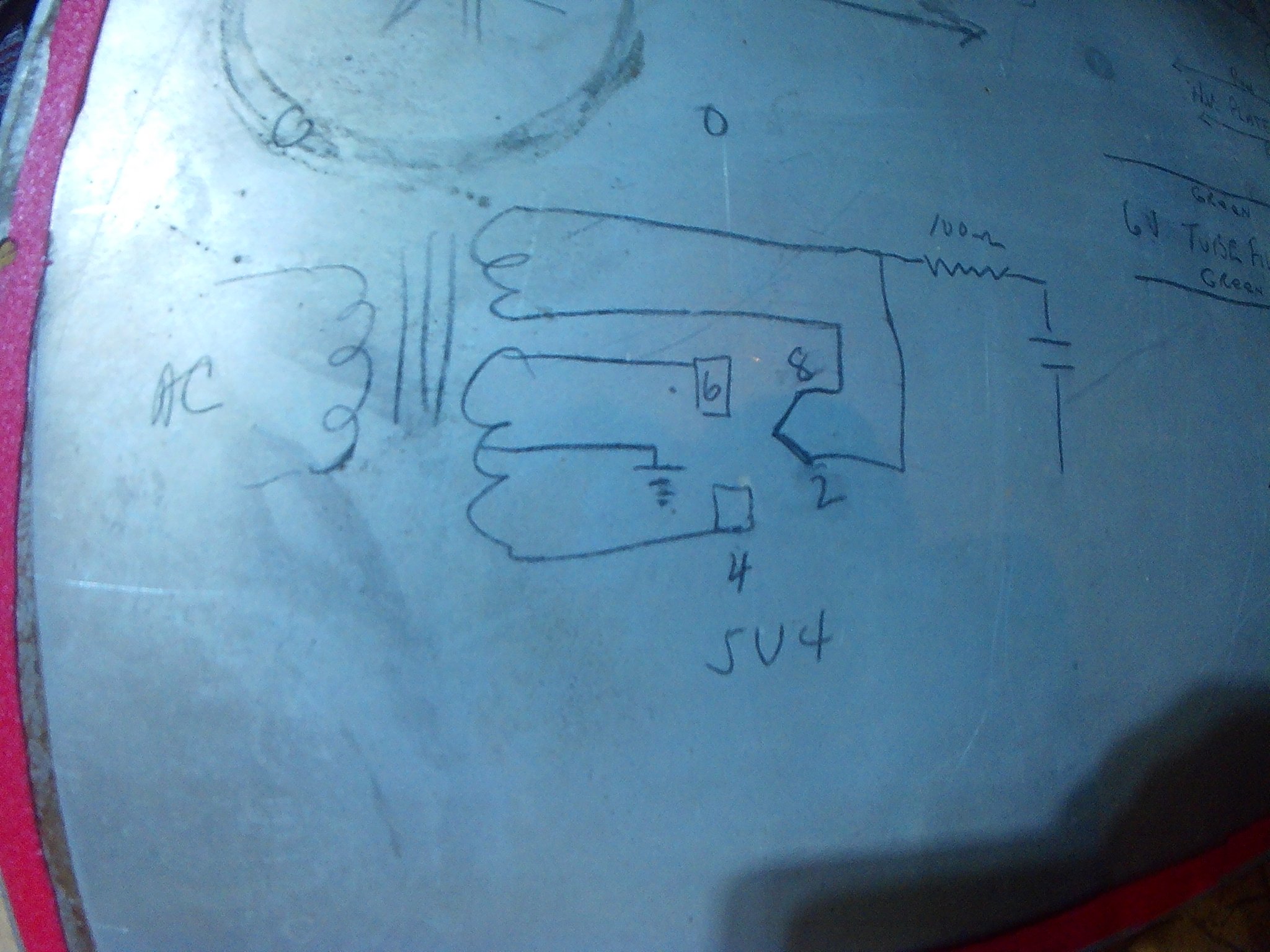

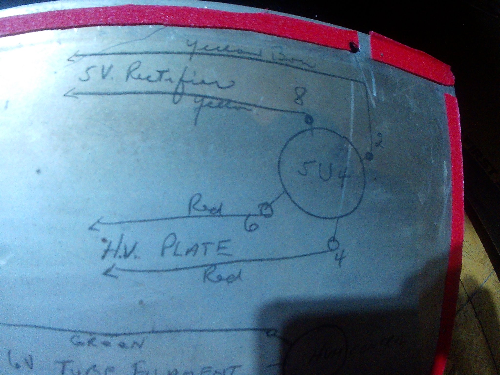

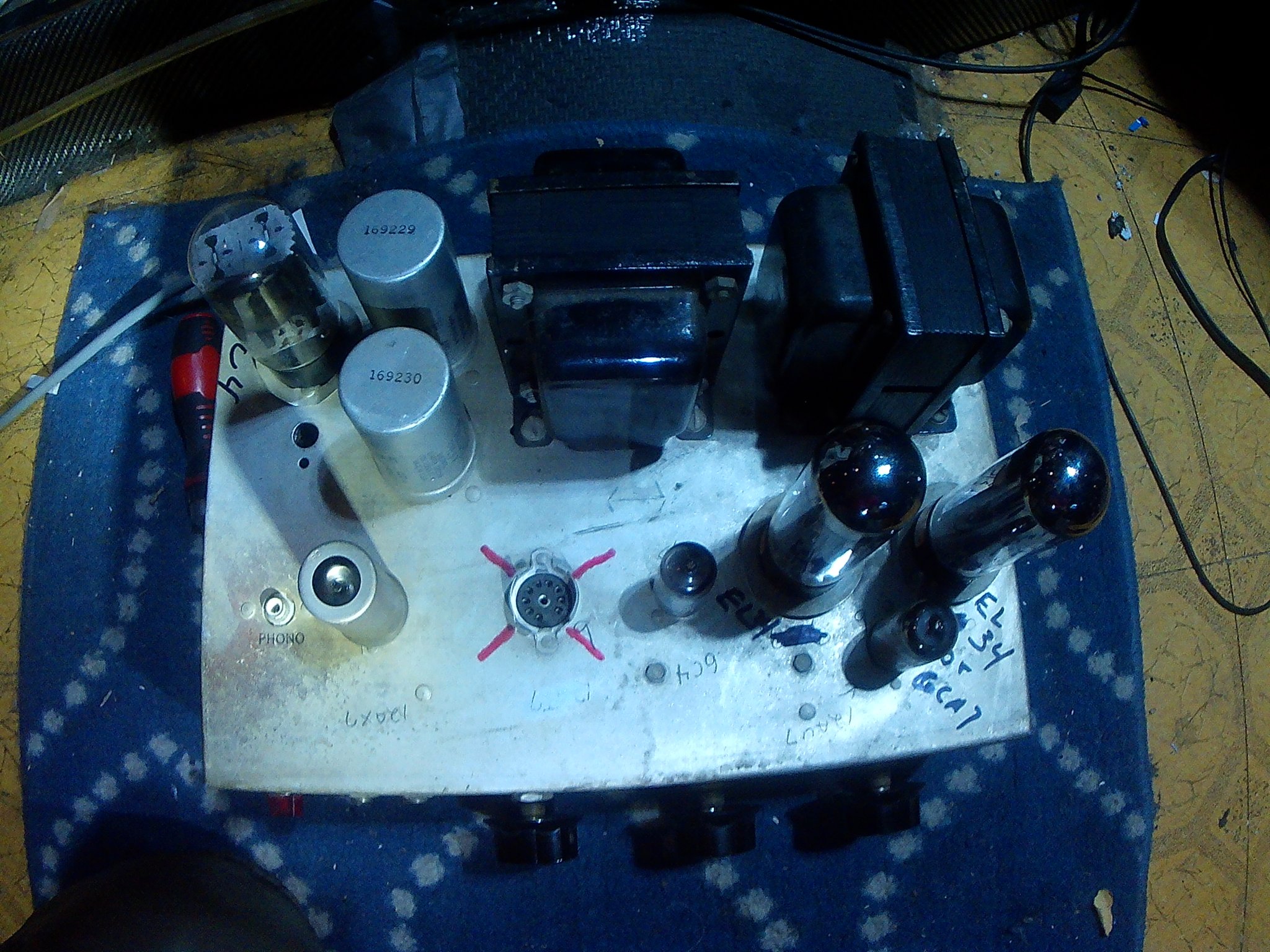

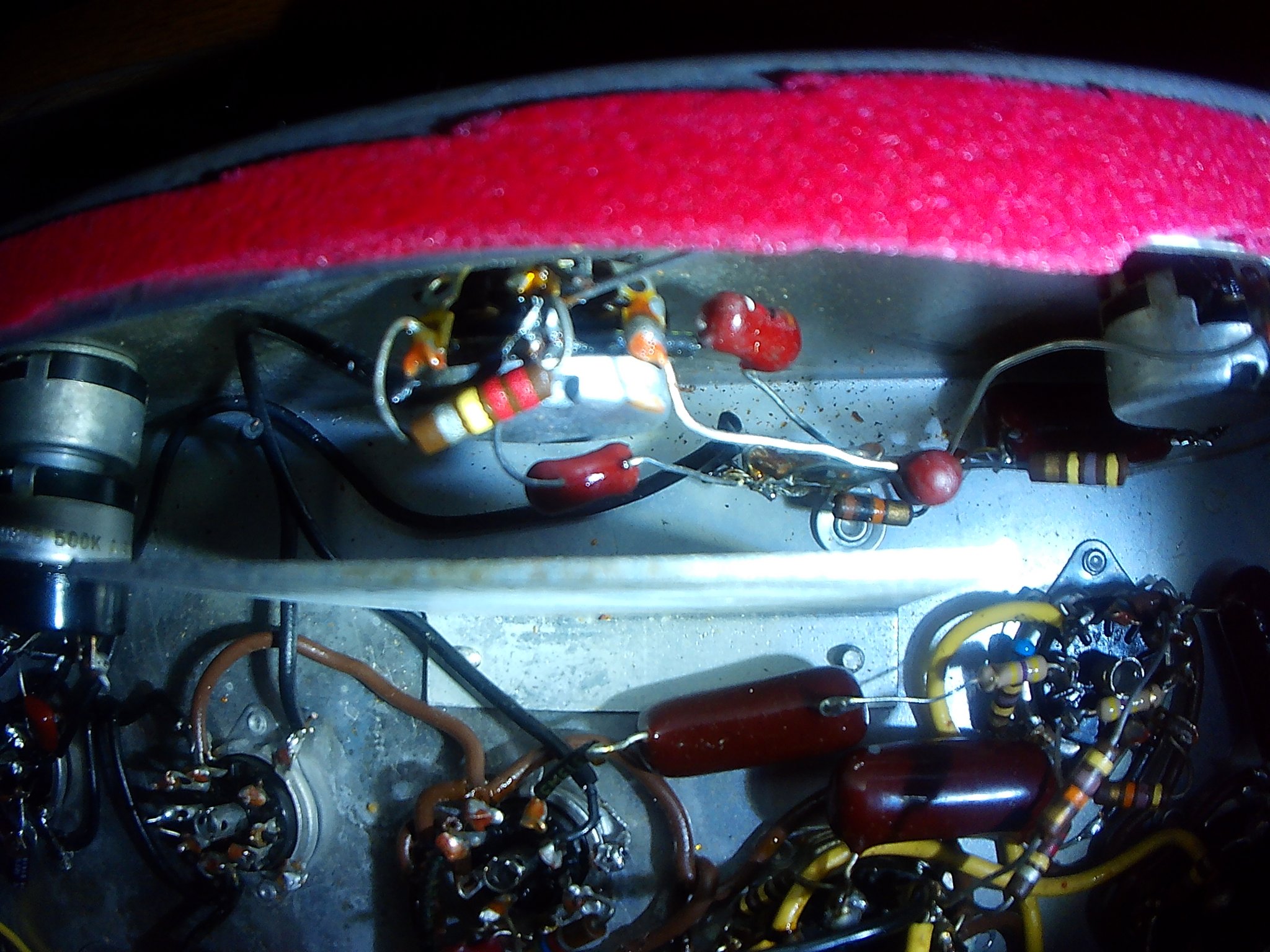

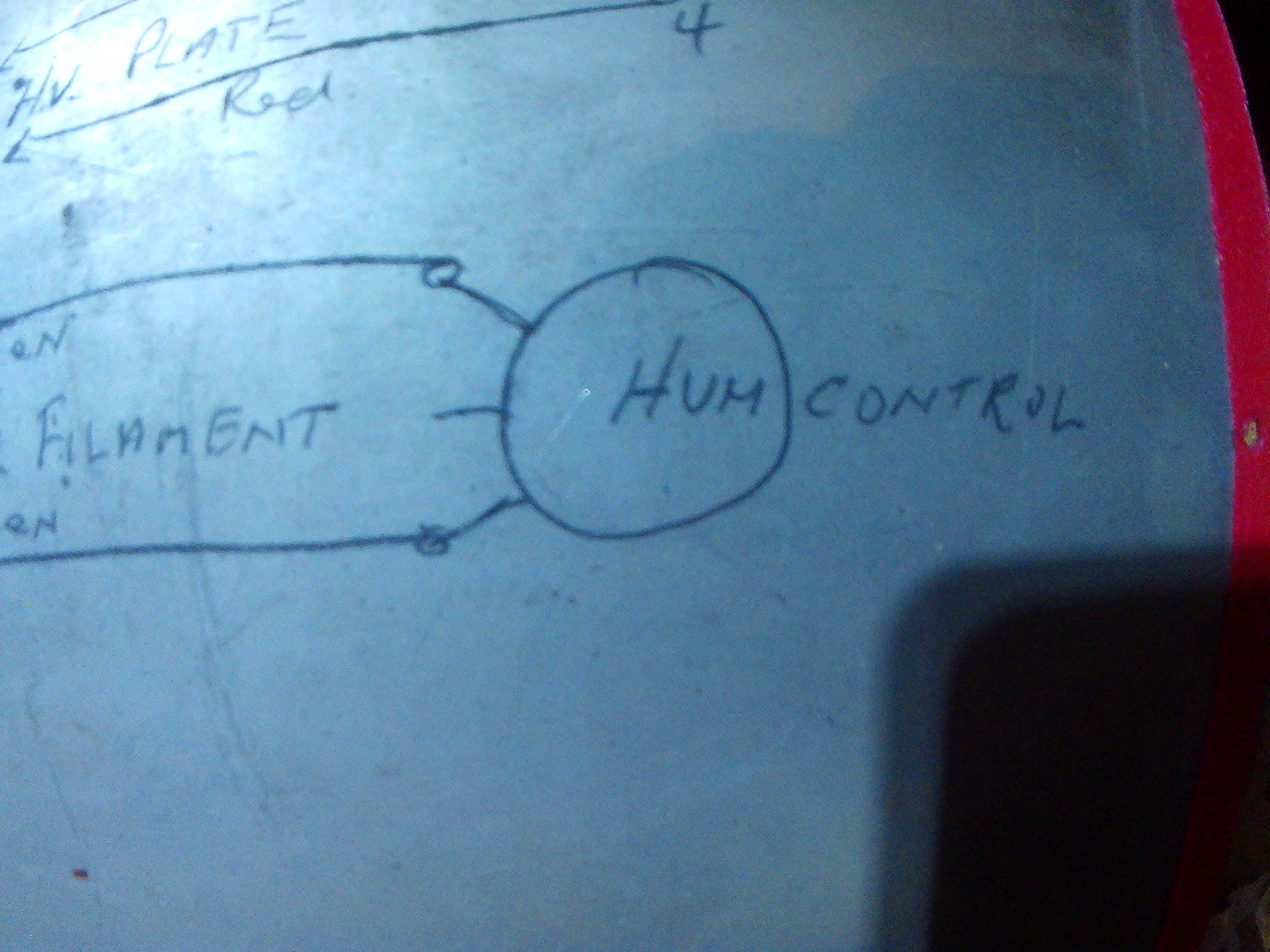

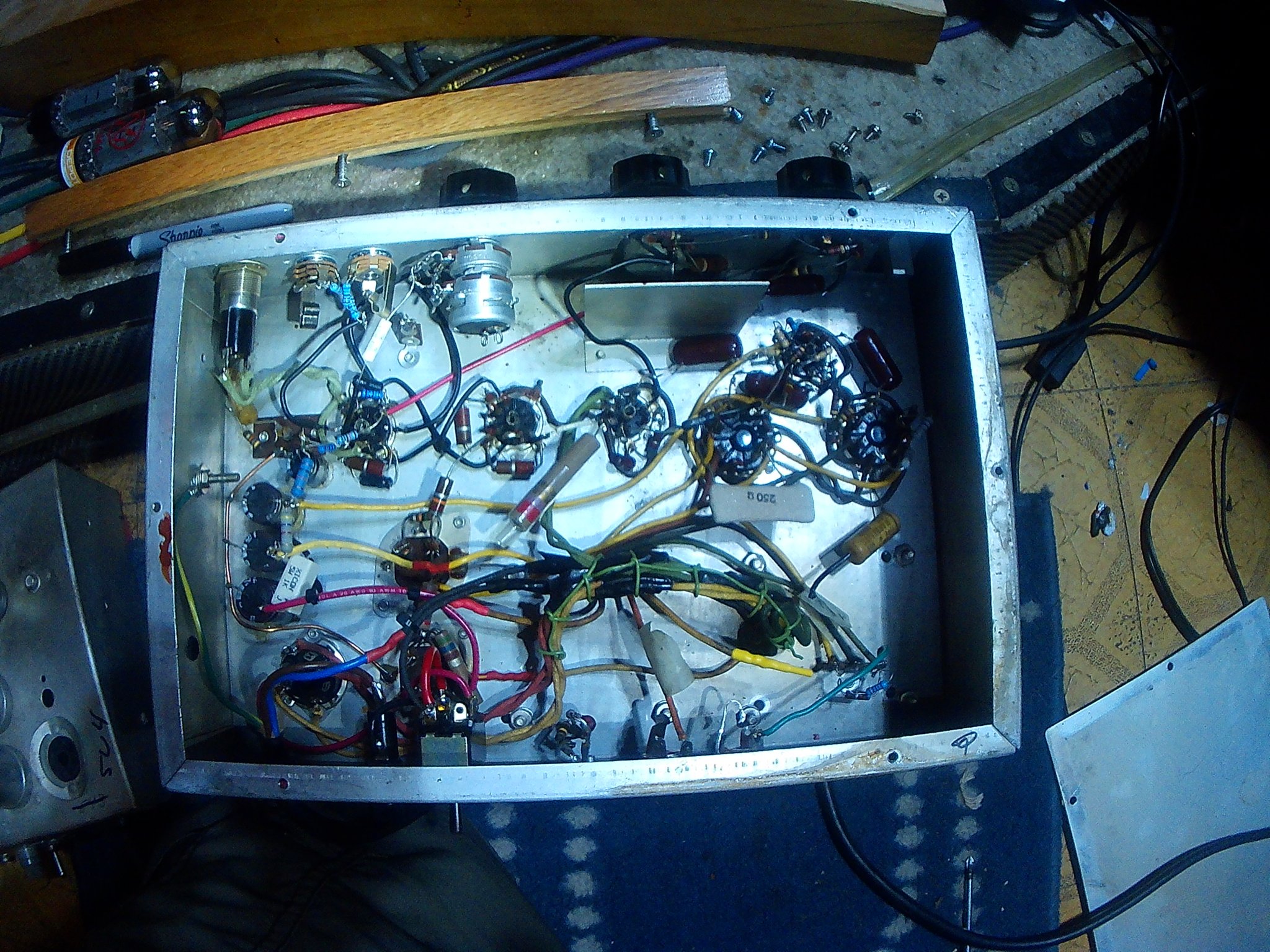

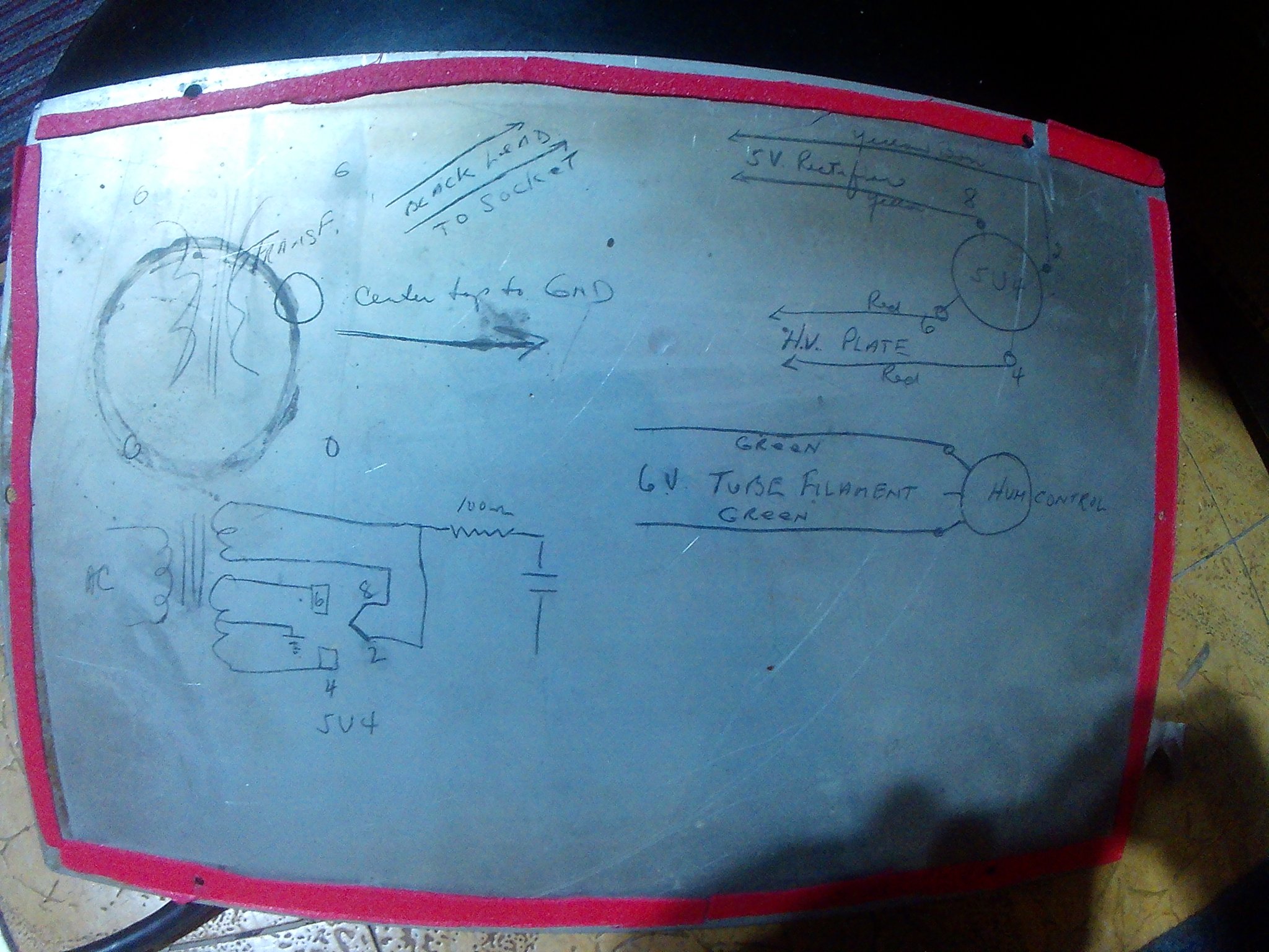

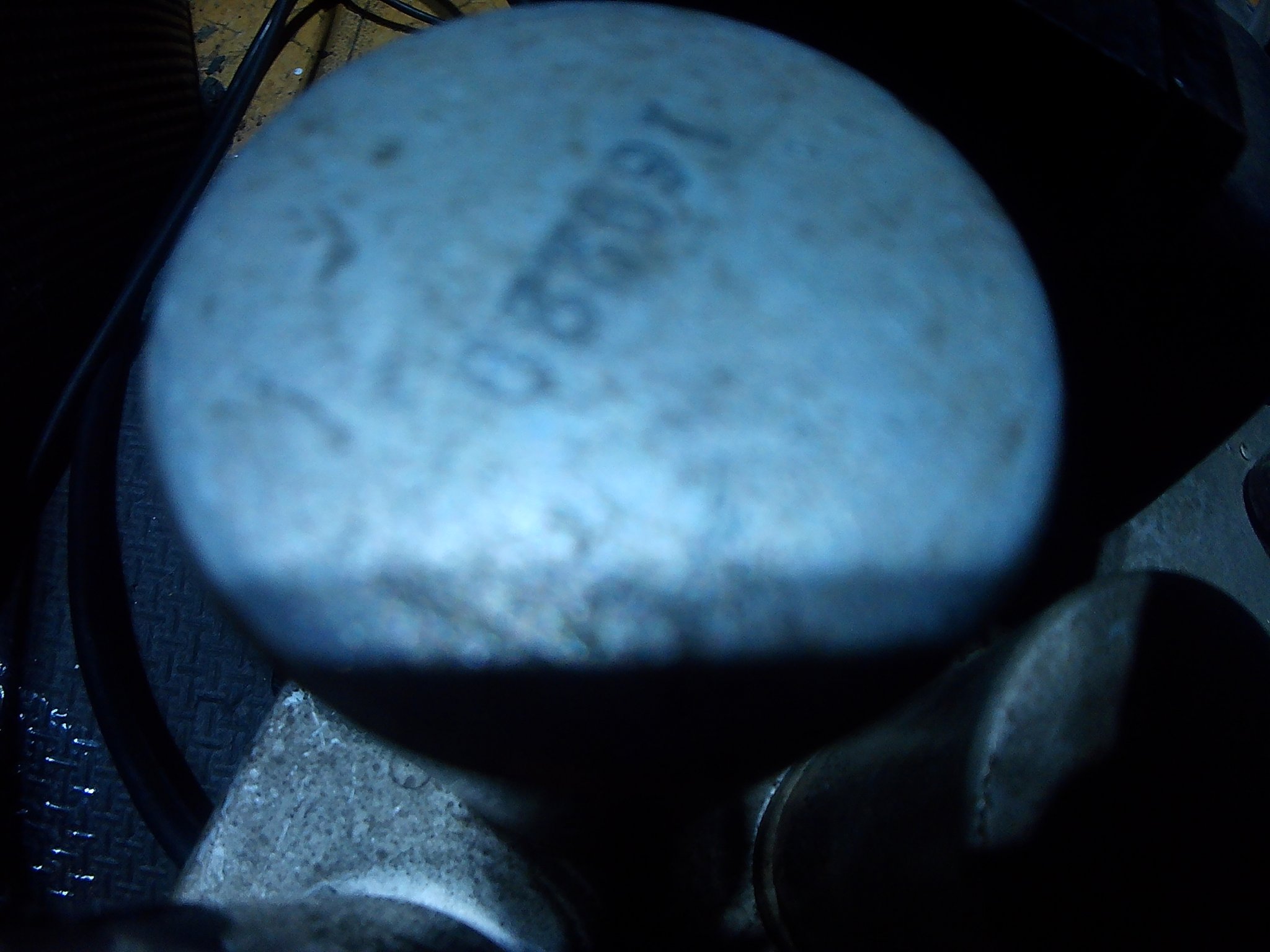

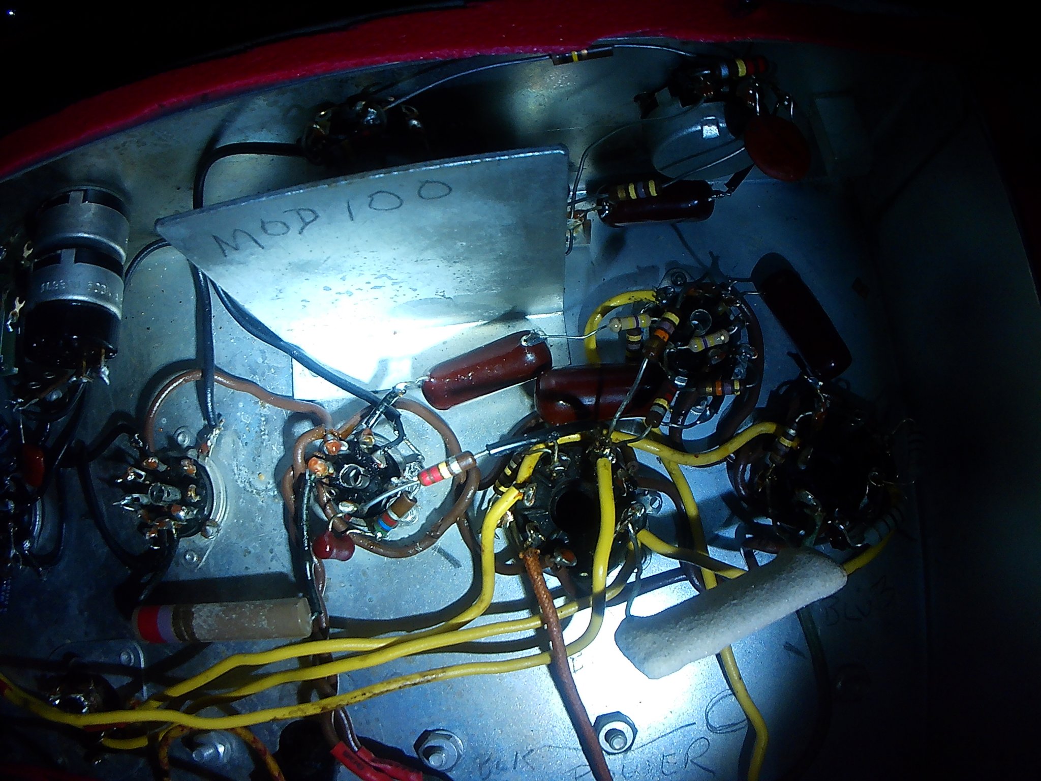

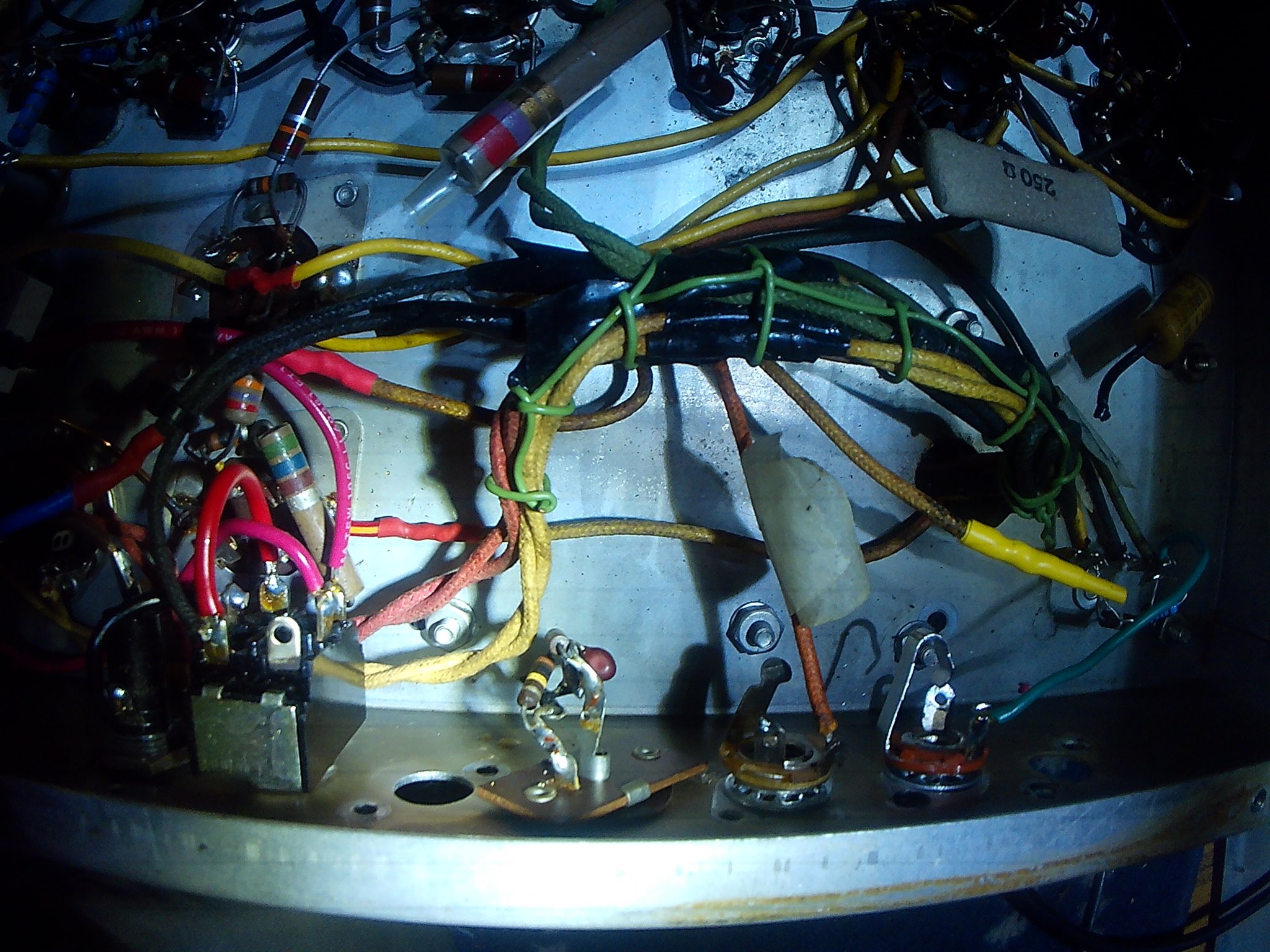

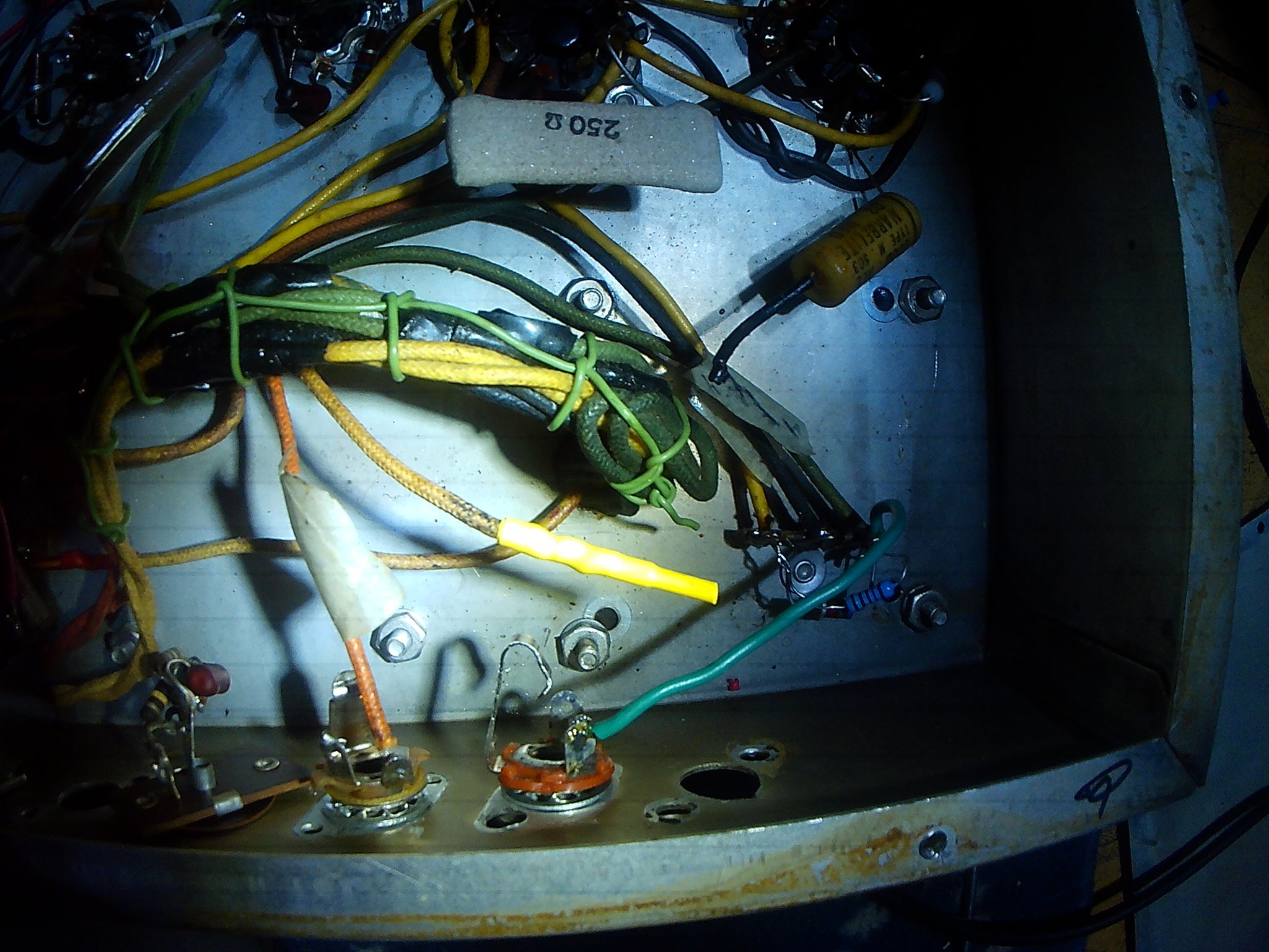

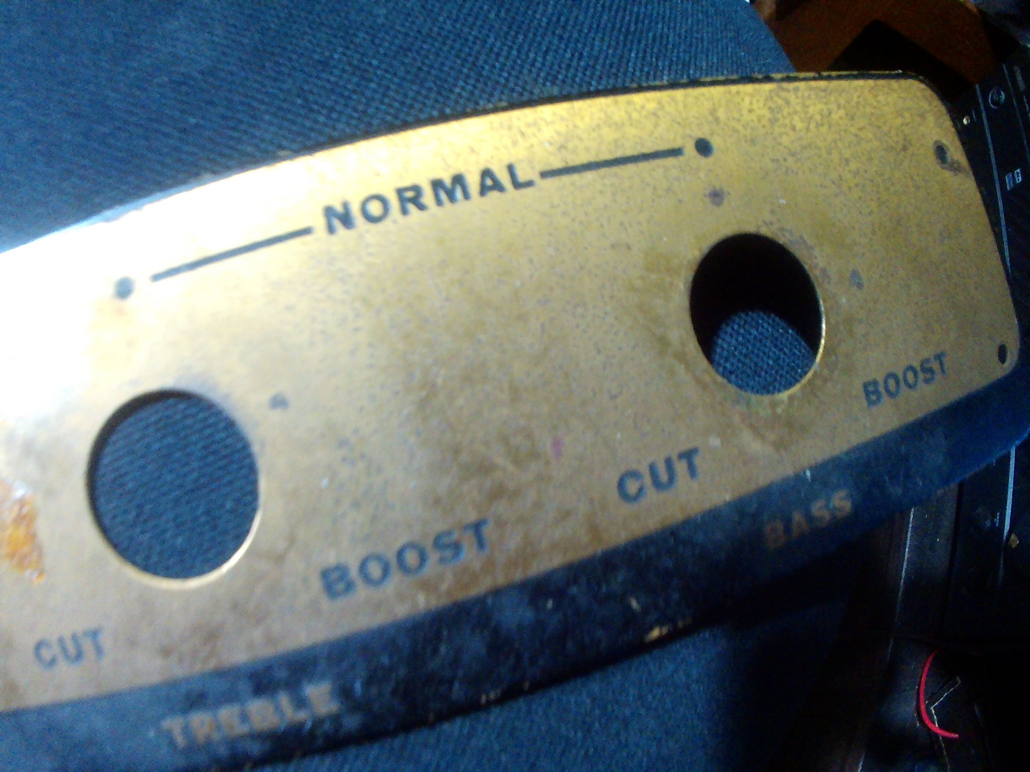

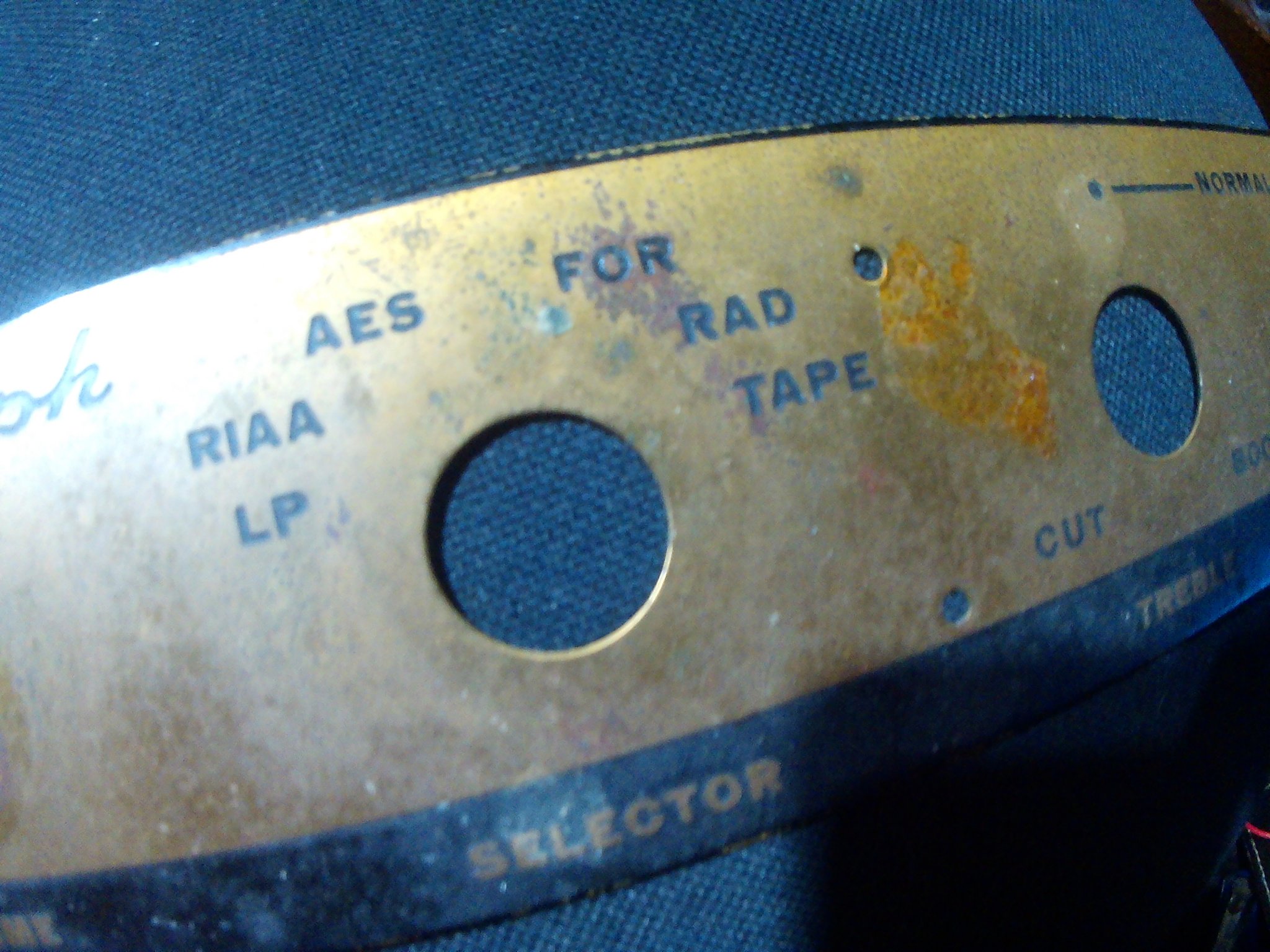

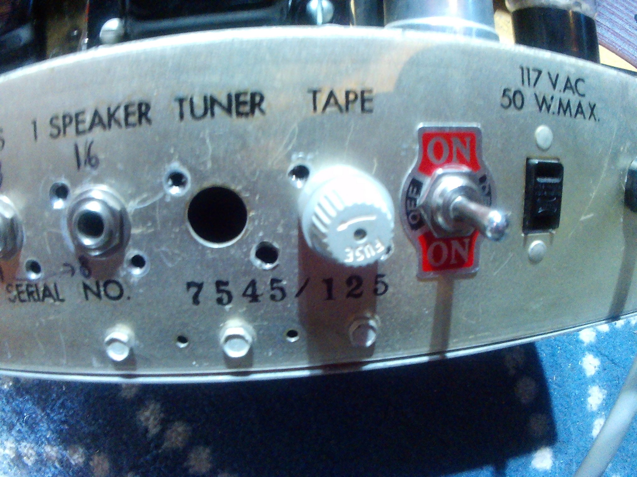

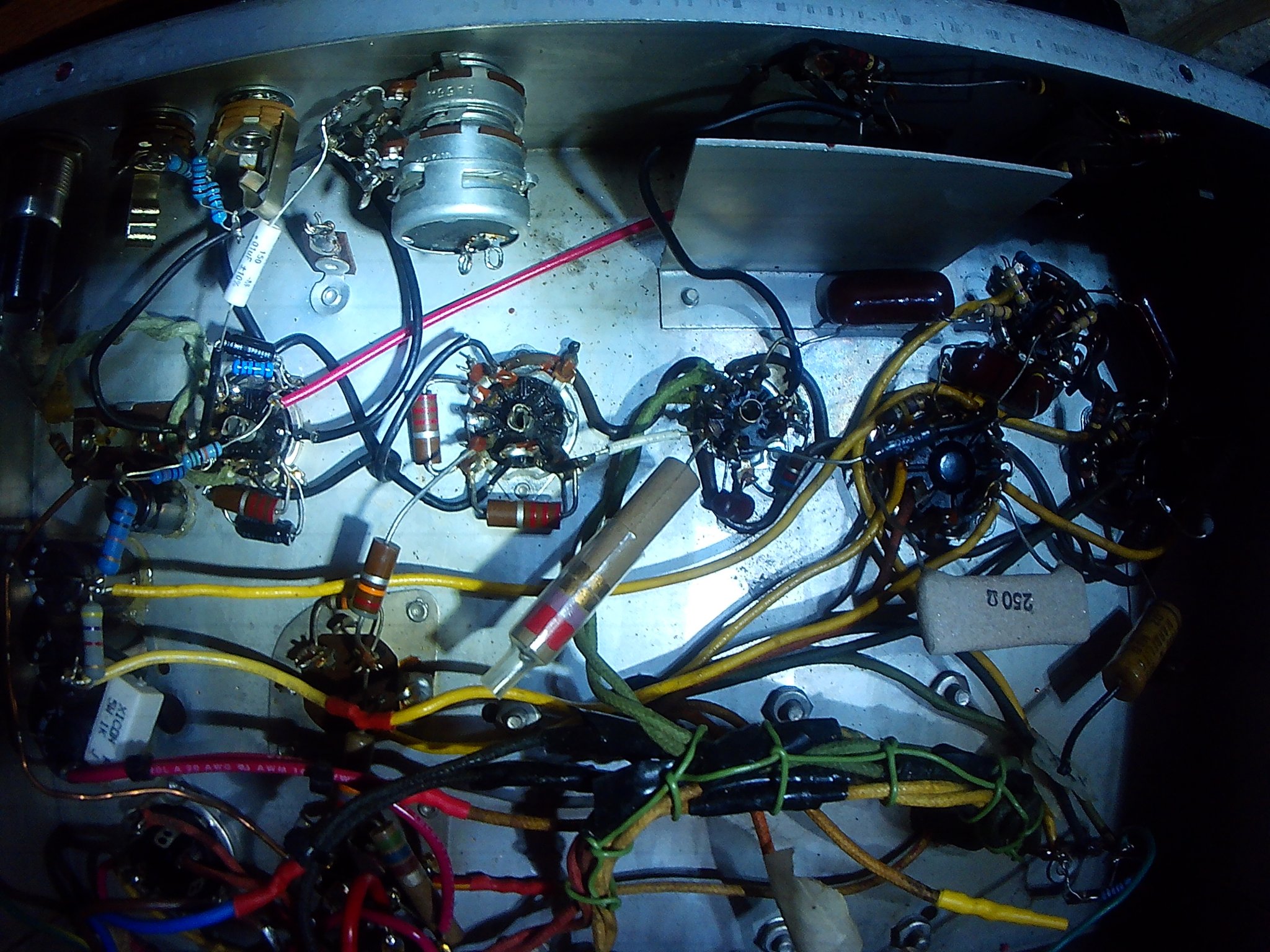

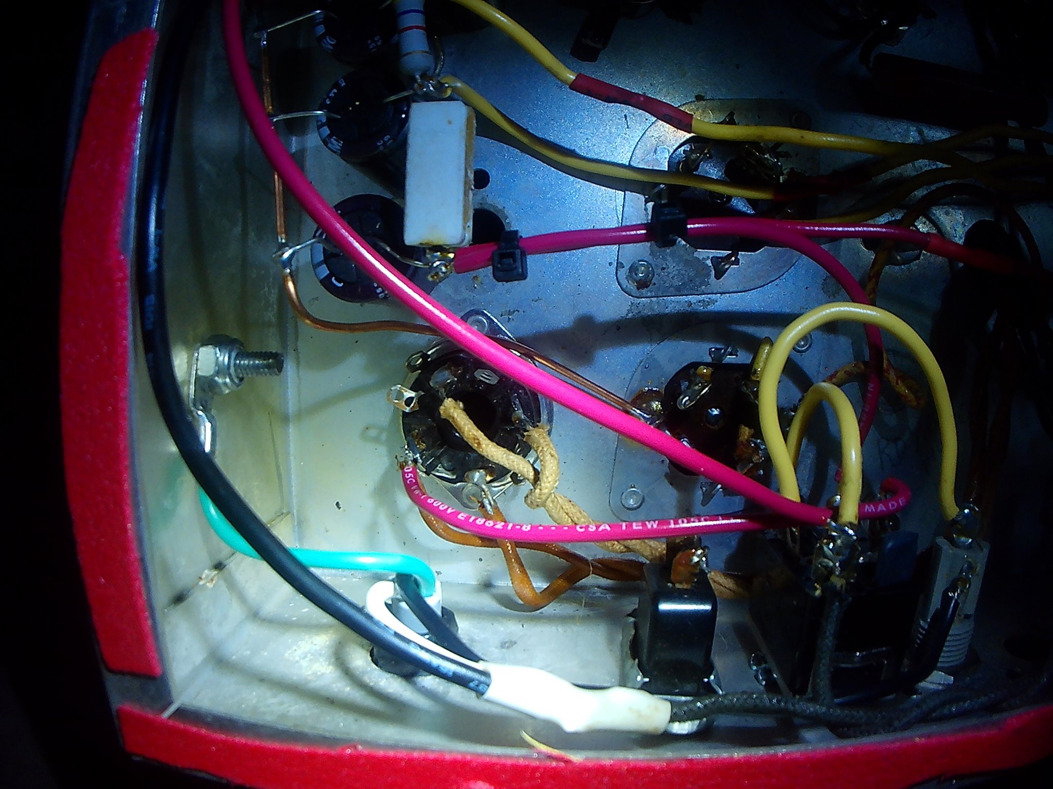

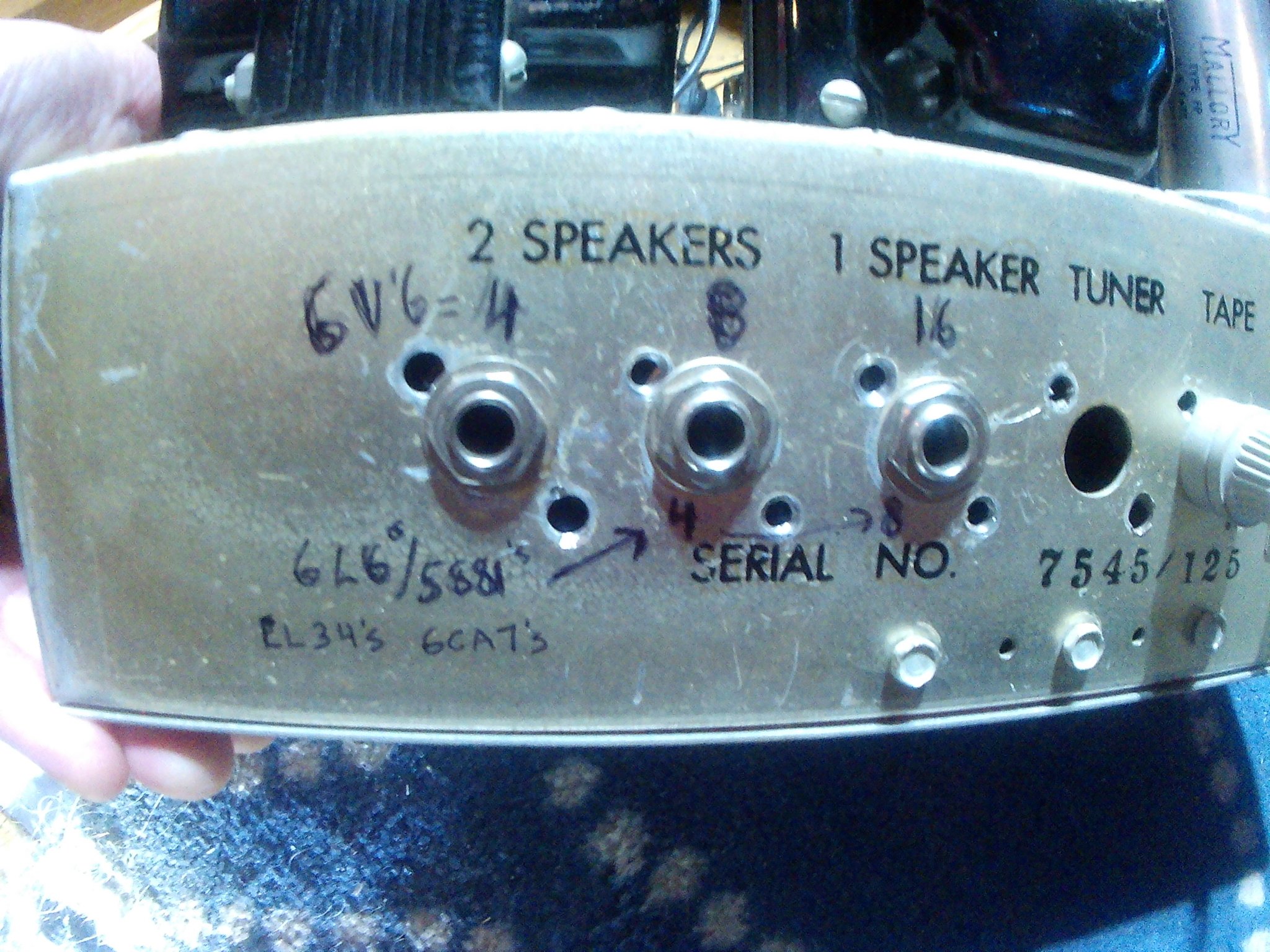

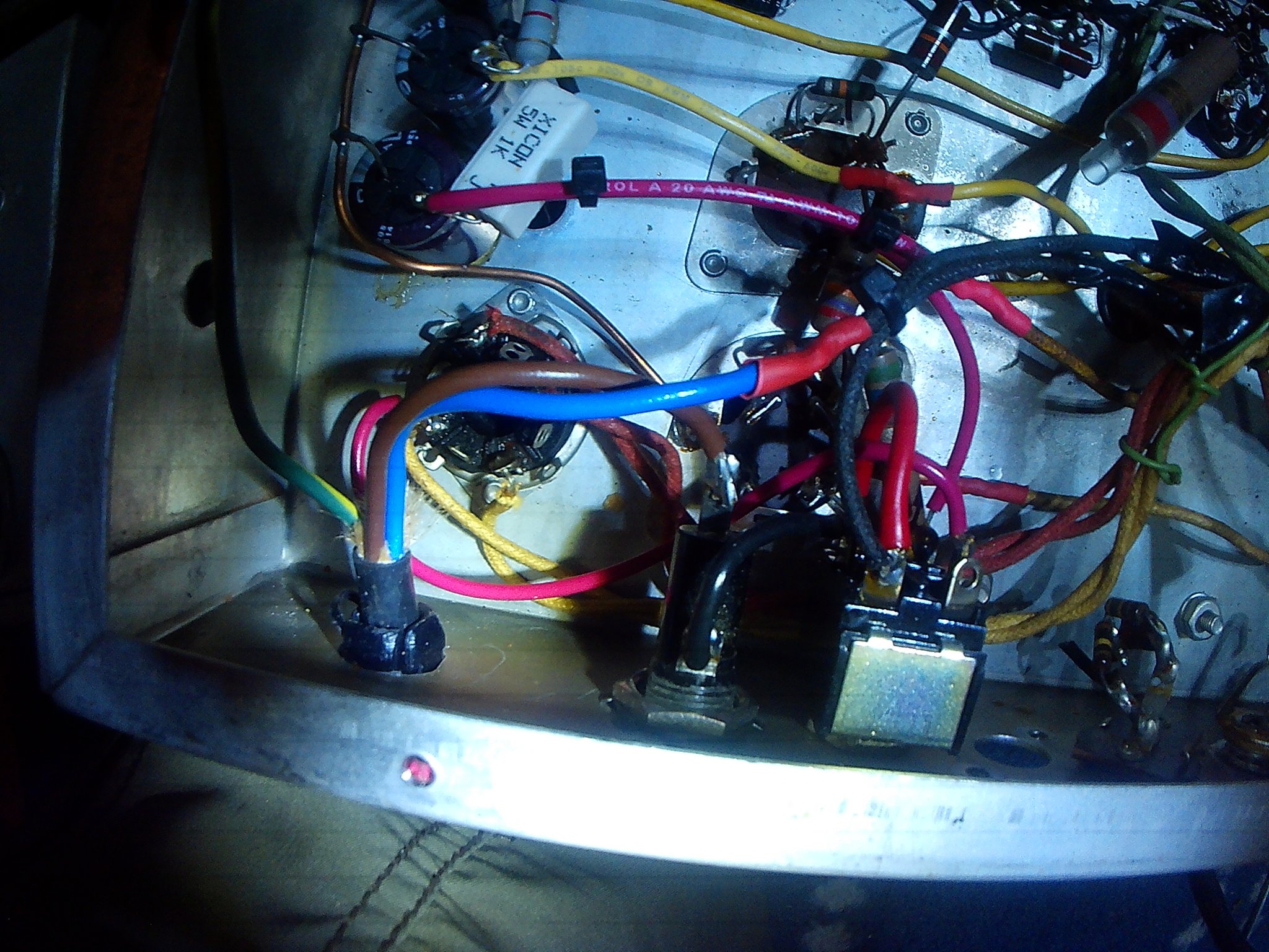

ok here are the pic's of both dictogragh amps ill only put pic's of the amp that was converted to run 6CA7 or EL34's in this post and the other amp ill put all the pics on my next post there is a schmatic ill put those pics on both post

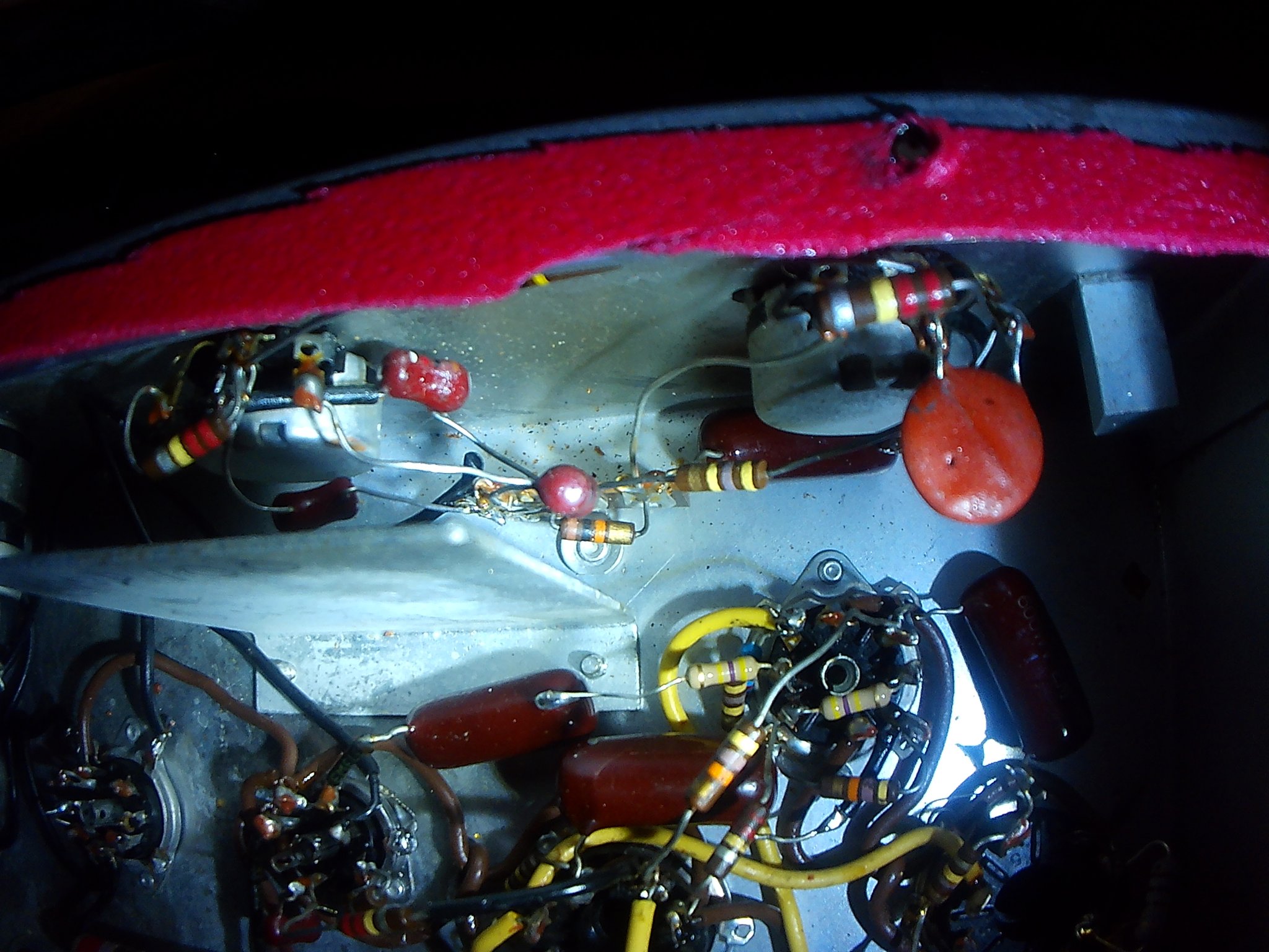

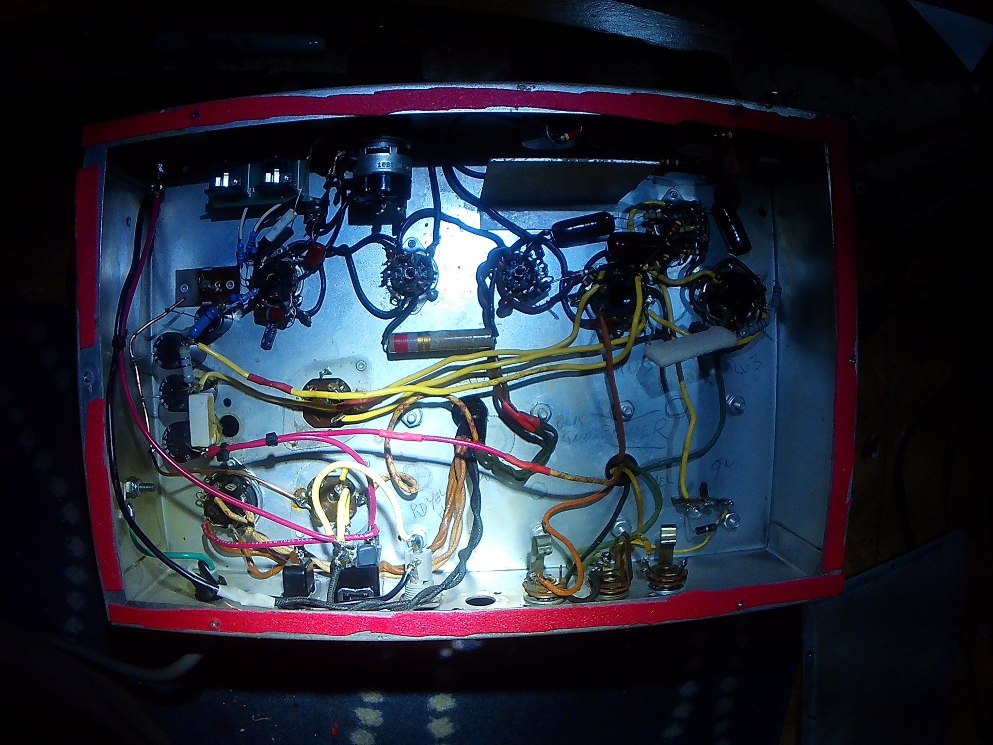

Okay, so one thing the modifier did was to relabel the speaker outputs for EL34s to reflect a lower load on the output tubes. Still doesn't answer a lot of questions. Can you send pics of the underneath of both amps? There must be some further modifications to the circuit.

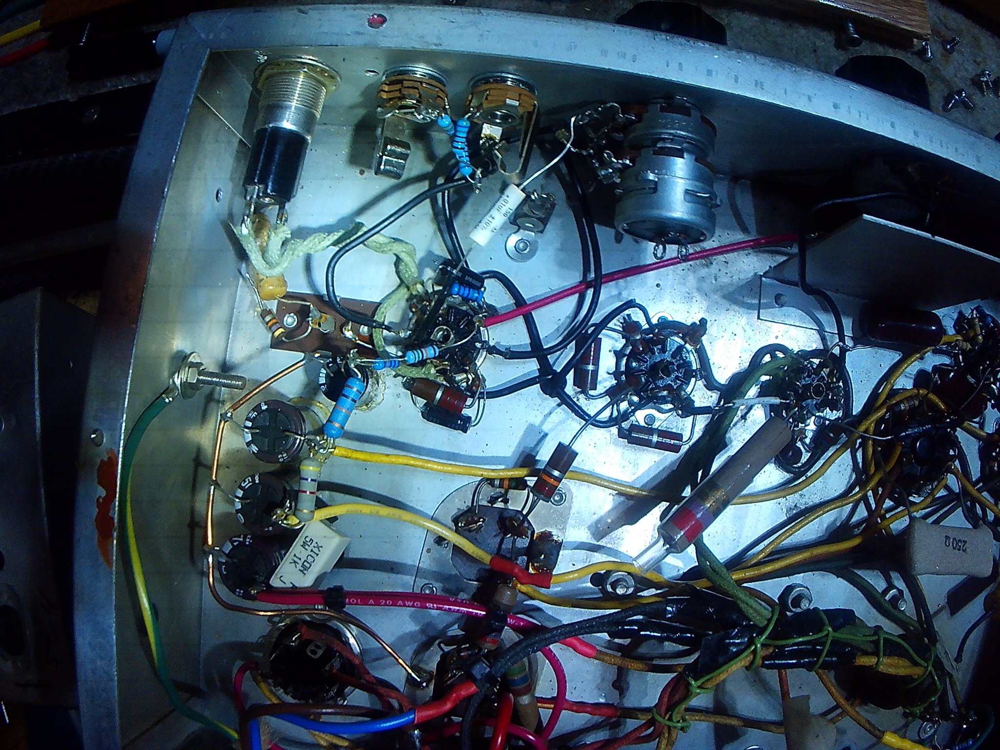

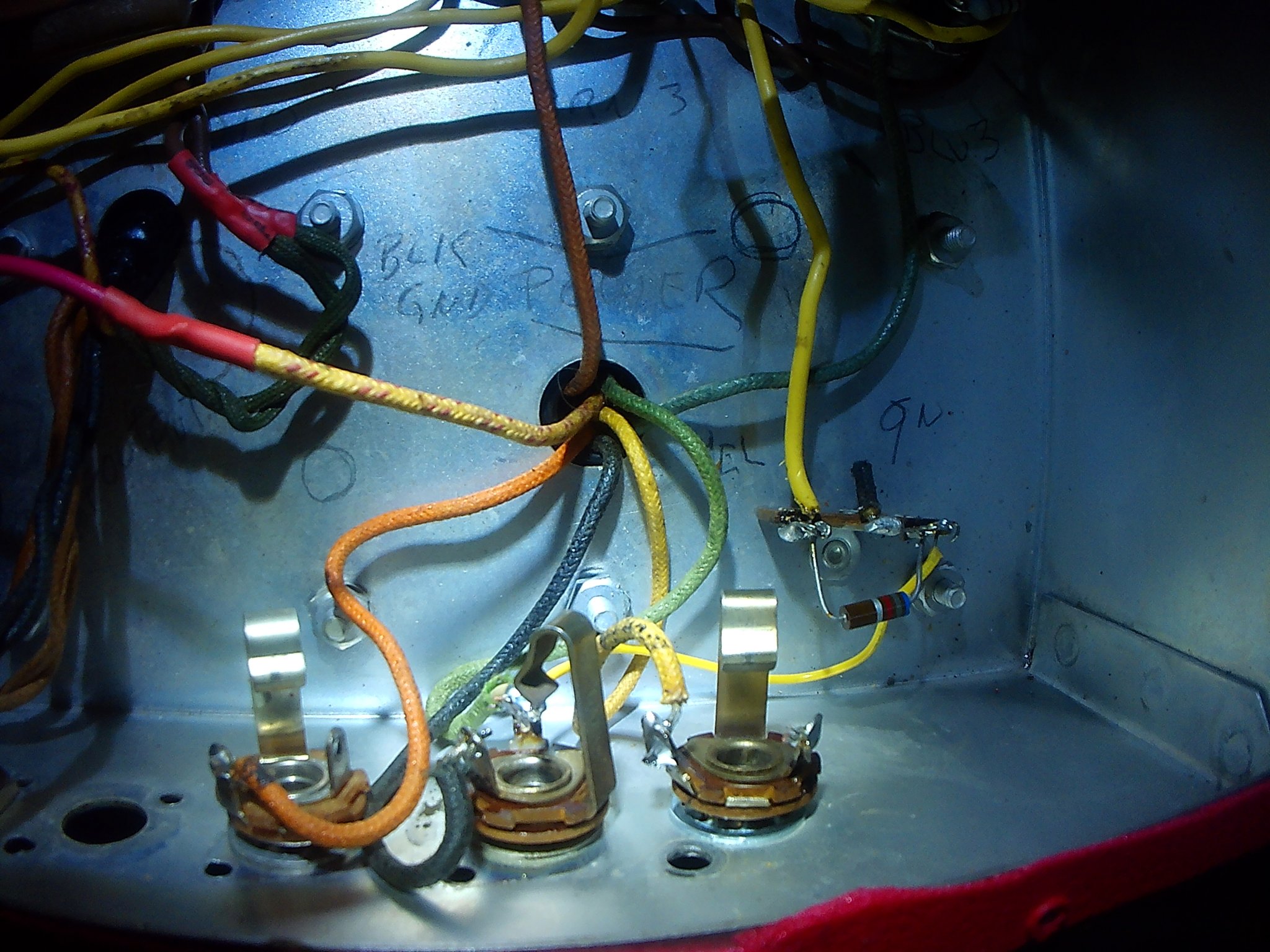

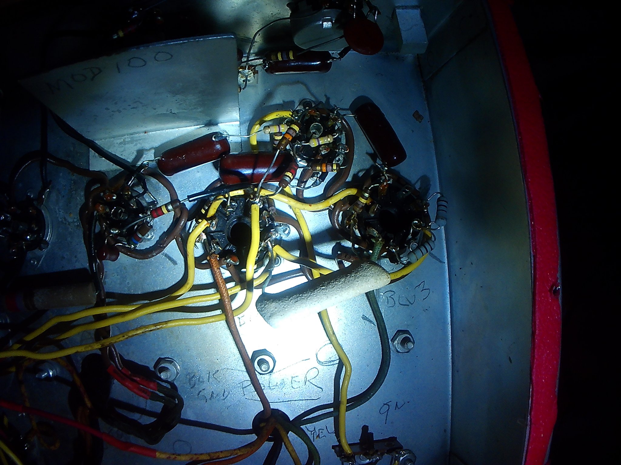

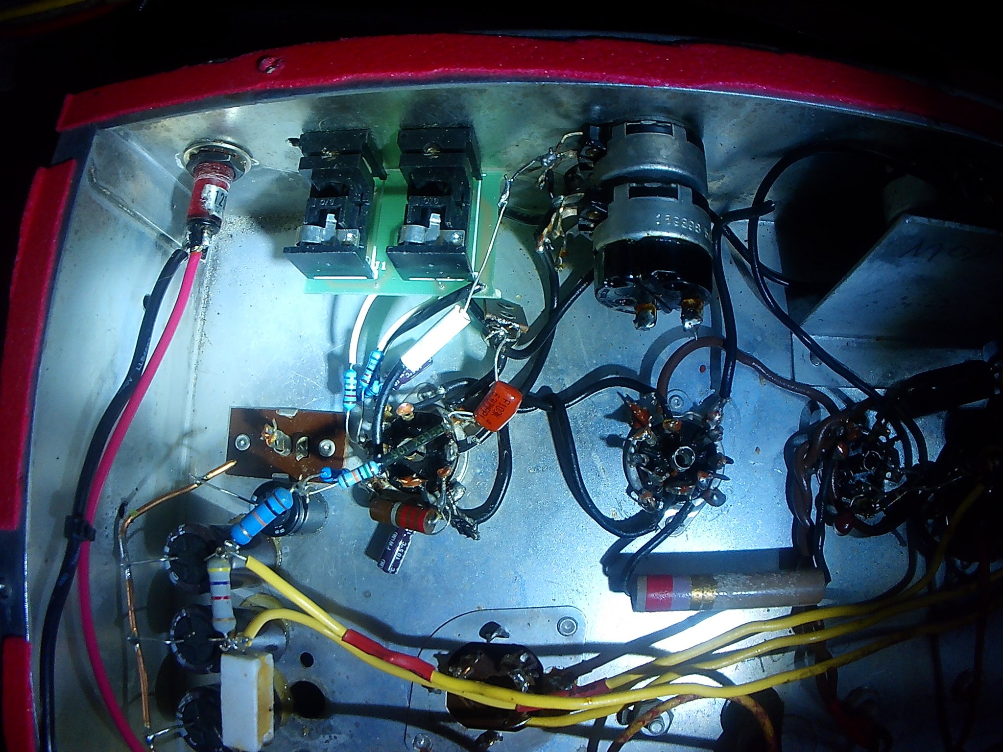

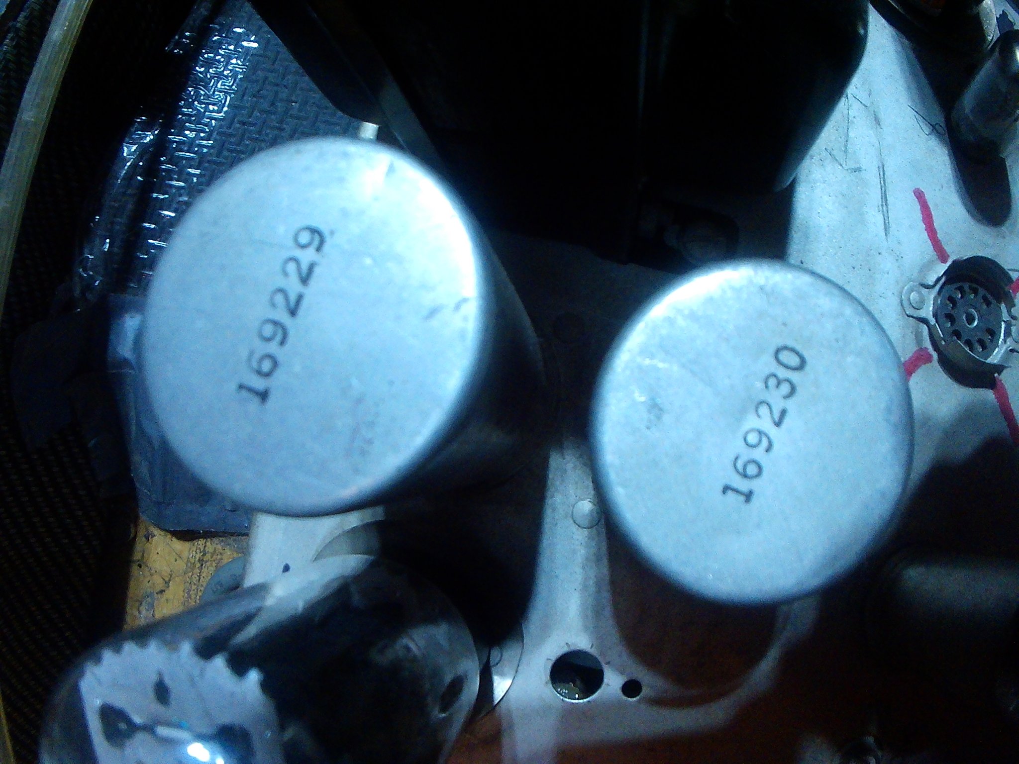

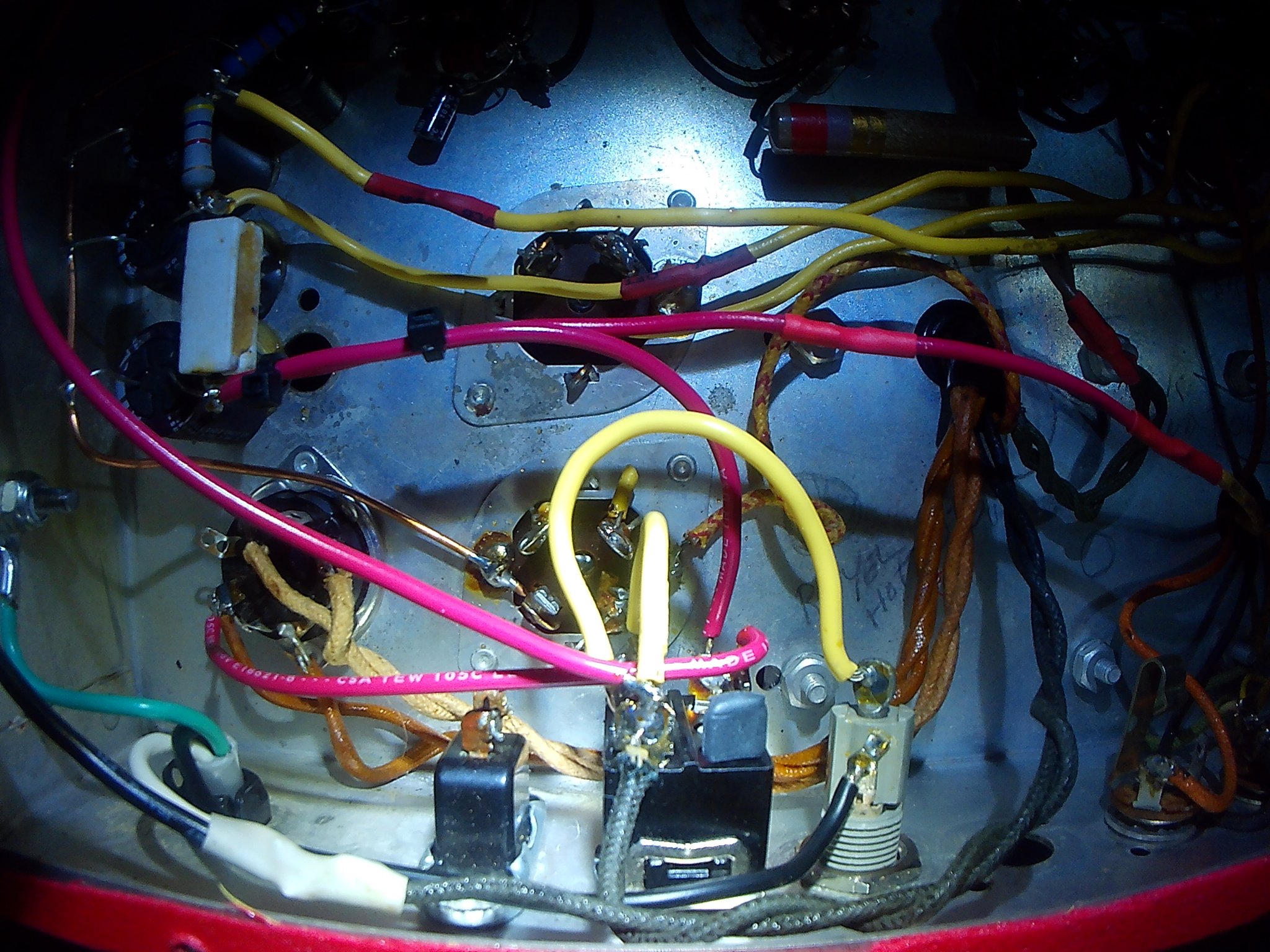

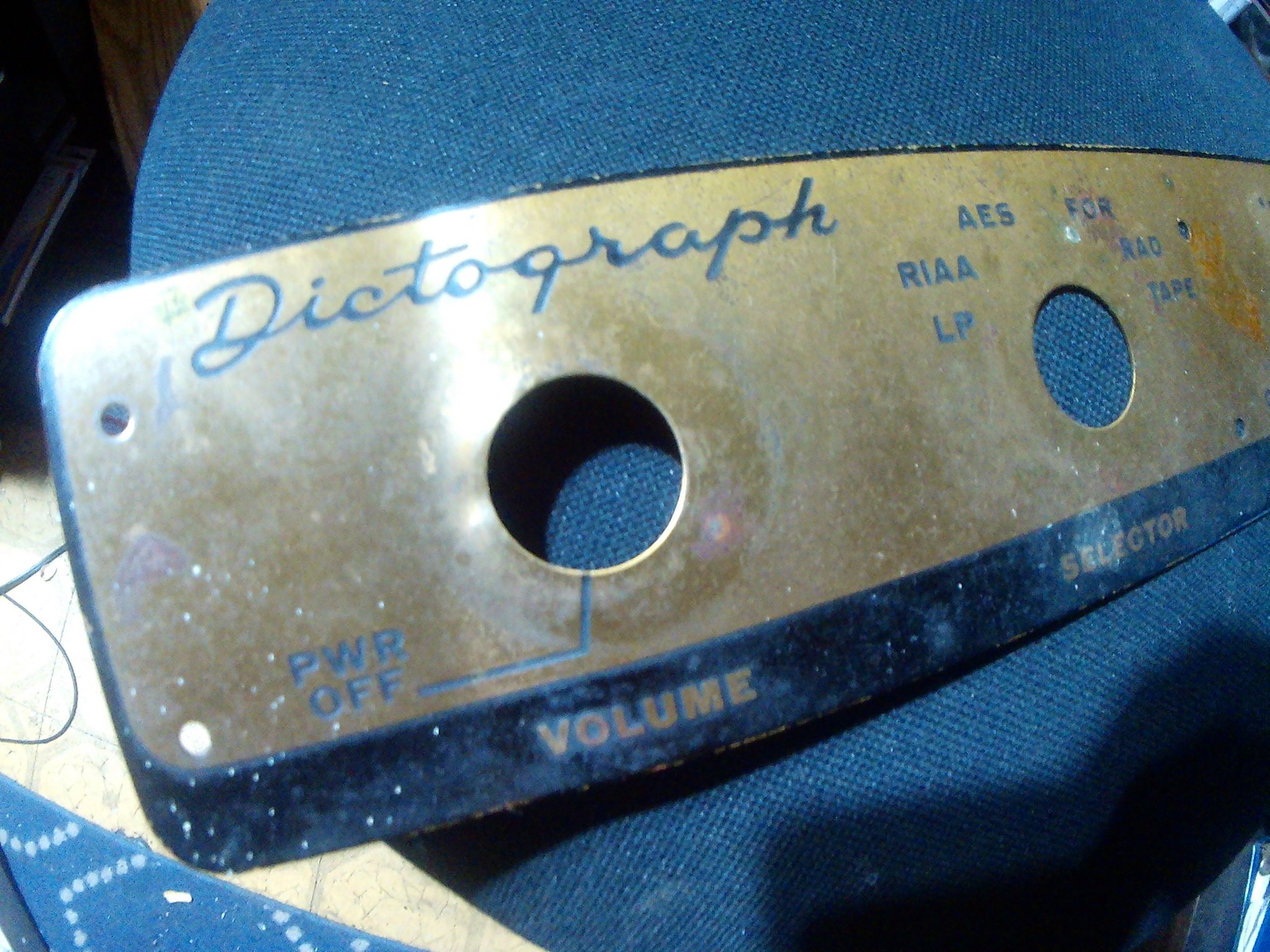

heres the other pics of the amp that still runs 6v6's i hope that helps cuz i don't enough about how write a schmatic or enough about how tube amp work but i would sure like to know everything there is to know about tube amps then i could do all the fixing or mods myself! the rest of the pics on the next post

i posted a lot of pics of both amps and there is somewhat of a schmatic have a lookCan you post a schematic of the amp in question?
jeff
i posted i lot of pics of both amps if you need more pics like close ups i can do thatOkay, so one thing the modifier did was to relabel the speaker outputs for EL34s to reflect a lower load on the output tubes. Still doesn't answer a lot of questions. Can you send pics of the underneath of both amps? There must be some further modifications to the circuit.
This amplifier is listed in the radiomuseum web site. It seems to be a generic mid-50 design for home Hi-Fi use, with beefy transformers. The conversion to 6L6 / EL34 is unlikely to give a significant power boost and it may even be detrimental and increase the distortion, but it will change the sound signature and this may be the desired outcome for a guitar amplifier. The conversion should really be performed after some design calculation, but due to the simplicity of the circuit you may try to do it empirically instead. I would start by making sure that the amplifier does indeed works correctly as stock 6V6, because according to your pictures it has not been restored in a professional way previously. Check the main fuse value, it should be 2A or so; it is best replaced with a new, good fuse. Connect the speaker and leave the amplifier on for an hour or two. Check for overheating/burning smell/noises and be ready turn off it immediately if you see a output tube turning red. Measure the voltage at 6V6 pin 8 (cathode). A hook type of voltmeter lead would be very useful to get a stable reading and avoid sticking your hands next to dangerous voltages.
Turn off the amplifier, discharge the capacitors, and measure the original cathode resistor value between 6V6 pin 8 and ground. This resistor is inexpensive but it may get damaged by the following empirical tests, so it is best to know the value beforehand. The cathode current is the cathode voltage divided by the cathode resistor. Take note of this value. Then replace the 5Y3 with 5U4 / GZ34, and the 6V6s with 6L6s. The original rectifier is a 5Y3, replacing it with 5U4 (as done in the modded amp) does increase the anode voltage supply and makes it more suited for the bigger output tubes. Main filter capacitors may need to be replaced as well to reliably work at the higher voltage. A variac would be useful to turn on the amplifier slowly, but it is not essential. Turn the amplifier on. If the fuse does not open immediately, it is a good sign already. Measure the voltage at pin 8 again. It should be in the same ballpark as before. If it is significantly different, take note of the value and turn off the amplifier. Move the voltmeter lead to the center tap of the power transformer primary to measure the supply voltage, turn on the amplifier briefly again and measure the value. You then need to calculate a new cathode resistor value to get the same cathode current as the original design. Look up a tutorial or ask here with the measured values. If you are satisfied of the results, do not leave the amplifier unattended! Check for overheating for the next 2 hours at least, and turn off the amplifier immediately if the power supply transformer becomes hot. You are increasing the electrical stress on vintage parts that may be already weakened, and there is a real danger of damaging one or more transformers.
