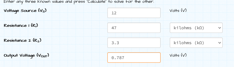

You may either increase R109 or decrease R108. Computing is easy: the thereshold level would be R109/(R108+R109) × [voltage_at_pin_8_of_U101].

So I enterd the default values from schematic:
It says 0.787V but it's not true. I've measured the voltage when the peak diode lights up and it starts to light when 0.48V is on the input of the opamp, to be precise Pin 1 of the J003 connector.
Your voltage divider app is working properly.
