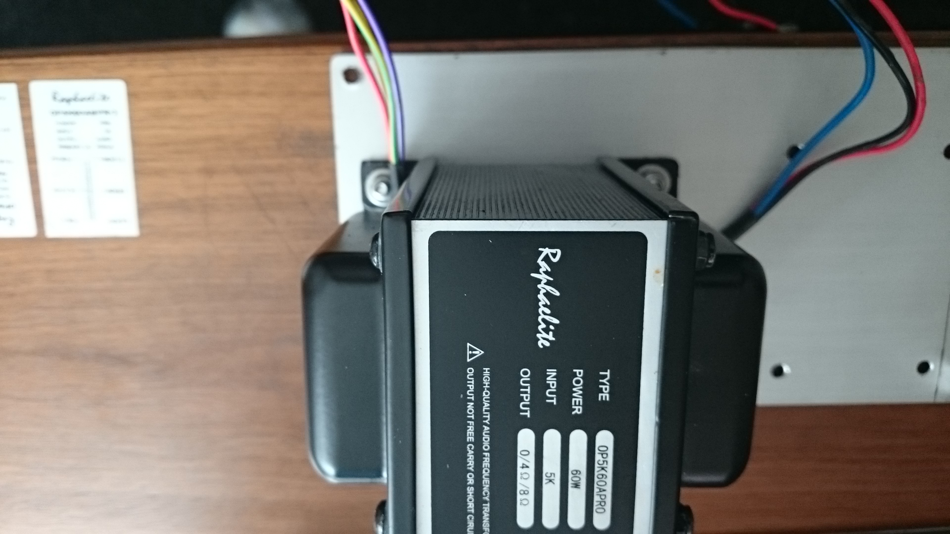

hi all, i am building this 2a3 pp kit as per here, 2A3 PP Push-Pull Tube Amplifier 15W Complete Kit (Stereo)_Power Amplifier Kit_Tube Amplifier Kit_Analog Metric - DIY Audio Kit
i dont know how to wire the output transformers up and my repeated emails to the company that sells them is getting nowhere. this is the output transformer. OP5K60ABPRO 60W 5K:4-8 Ohms Push-Pull Transformer Upright_Push Pull_Output Transformer_Analog Metric - DIY Audio Kit and wiring diagram is as follows. http://analogmetric.com/download/2A3 PP Amplifier Schematic.pdf
is there an easy way for me to work out which wire is which with a meter? It has a red/black/blue wire on one side and red/yellow/purple and a green/yellow earth wire the other side. many thanks in advance guys. ad

If you bought on e-bay you could return it and buy from a reputable dealer.
Besides that, sorting the connectors should be straightforward. I assume
you have tree thicker wires and three thinner wires from the transformer.
The thicker is secondary ( to the speaker) the other to B+ and anodes.
If in doubt use an ohmmeter, there should be a significant differens in
resistans where the secondary has a few ohms and the primary tens of ohms.
When identifying the sides, use the same ohmmeter and measure between all 3 on the primary. The two with the highest resistance is the anode connections, and the remaning should be B+
The secondary might be trickier if the ohmmeter is less then good. Well
there is a trick.
Connect two of the primaries ( does not matter which) to a AC transformer that delivers 6-18V, then measure AC on the secondaries and make a note
the AC voltage between each combination. The pair with the highest voltage is the "outer side" and the remaining is the middle.
One thing remains, and that is the phase of the outlet. Leave that
for the moment, build the amp less the feedback resistor. Power up
with speakers or power resistor as load. If it starts oscillating when connecting the feedback , then the secondary has to be reversed.
