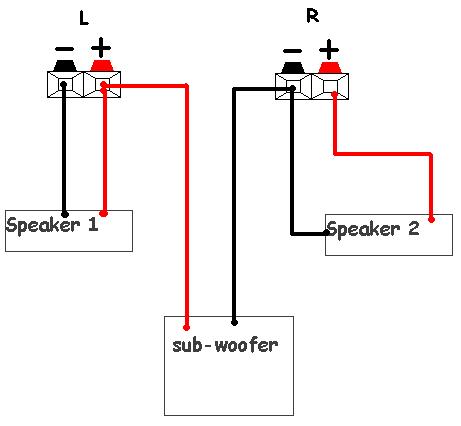

M Mikka Member Joined 2002 2003-06-19 10:07 am #1 2003-06-19 10:07 am #1 I'm not sure is this diagram right or wrong, cause planning to buy a unpowered subwoofer. please correct the diagram if somthing wrong. Attachments subwoofer connection.jpg 16.7 KB · Views: 179 raindog Member Joined 2003 2003-06-19 11:27 am #2 2003-06-19 11:27 am #2 in theory it's correct (if you add a crossover) but in practice it doesn't work very well(trust me! i tried) so you are better off buying or buildind a separate amp for the sub(and a crossover of course)🙂 Status Not open for further replies.
